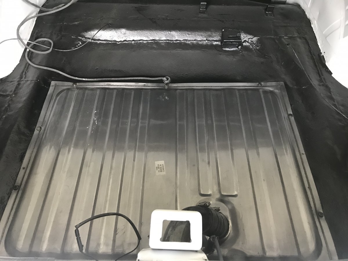

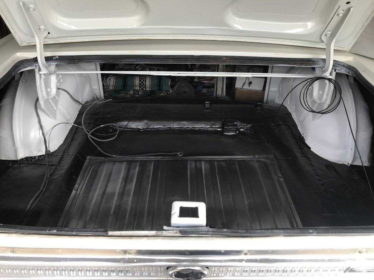

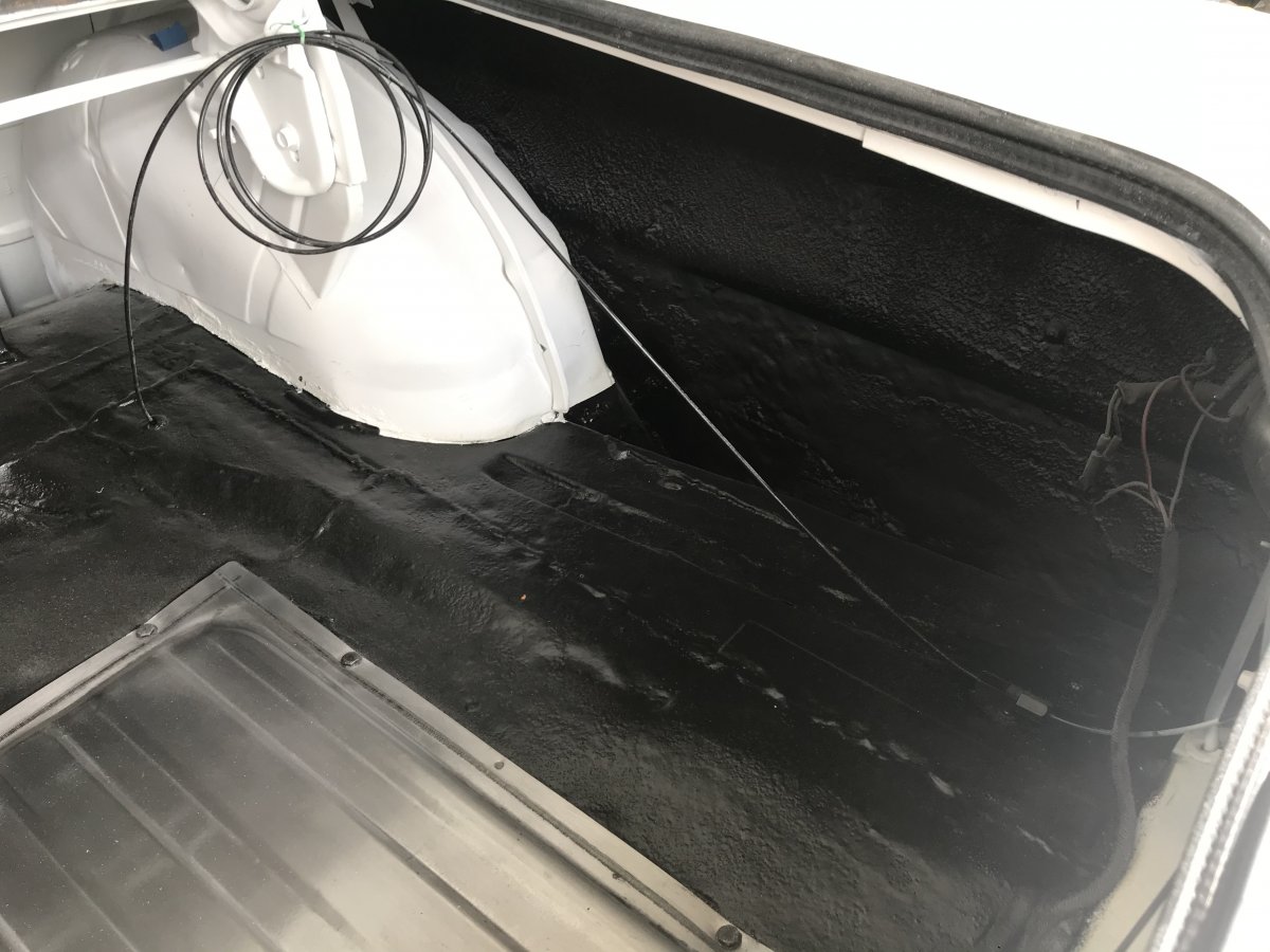

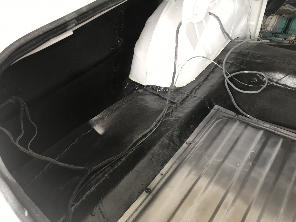

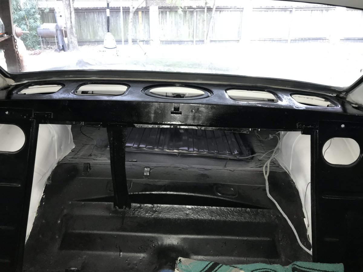

    Nice work there on that Cyclone. Wish my trunk pan area looked as good. Maybe sometime down the road a mini tub and new pan might be in the works, I don't know. I was learning to weld mig and really hate some of the welds I did.I would like to re-do it one day.
    Steady chipping away while we have this nice weather. I typically try to spend an hour or two on it before heading to work. Hands are pretty tore up from getting in the small and hard to get areas. Wiped everything down really good with Acetone after blowing the sanding dust off.
    Here are some more progress pics, hope to rattle can it over the weekend before work. Thanks for the words of encouragement, much appreciated.

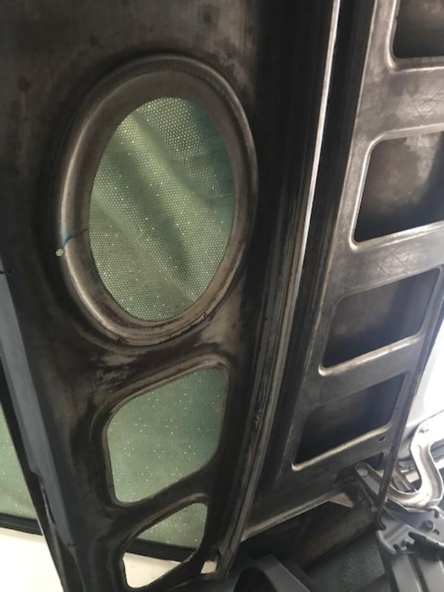

    That’s so me serious detail, I didn’t clean the underside of my package tray like that. Unless you have a mirror or are laying in your back on top of the gas tank, you can’t see it! I applaud your dedication!!

    Thank you sir, did a little spraying today before heading out to work. Hope to get the rest finished up tomorrow. A couple of pics, still got to do the trunk pan floor....

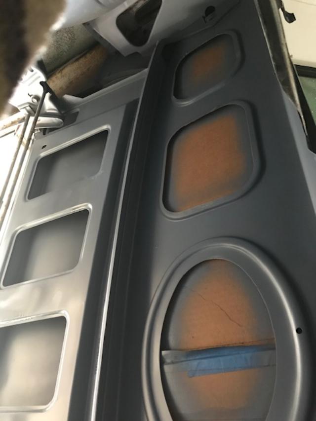

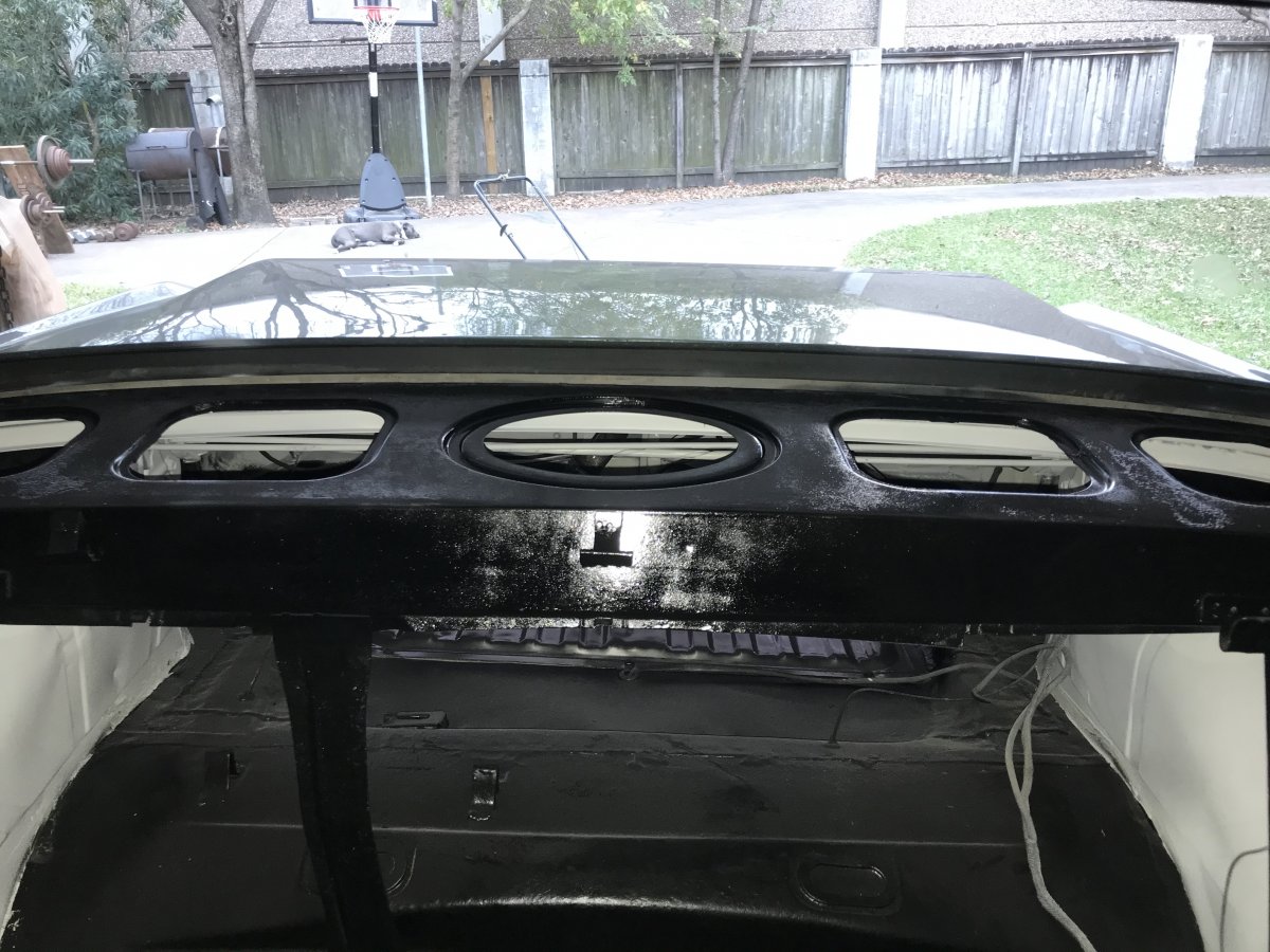

    Some shots of my latest progress. Still sanding on the top of the speaker/package tray.

    Thank you sir. I ended up sanding the top of the gas tank, then smoothed it over with some scotch brite. Decided to shoot some clear over it.
    Pulled the door seals because they were new but ended up tearing at the bottom. Guess we ended up adding just a tad too much fibergl*** so I took a wire wheel to both doors and the groove is now there.
    Been looking for a donor car to pull a few things from. Could use a better grill and rear bumper.

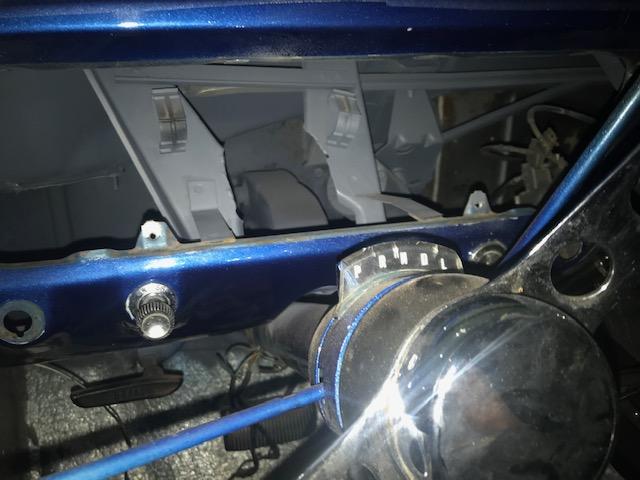

    Need to buy some new door seals and test fit. Gonna repaint the door jams and I hope to redo the dash and all panels before I put any wiring back.
    I do not want any overspray on the wires what so ever. Going back to the original color blue. If all goes well with income tax I’m gonna redo the outside with the original Wimbledon white. I like that it has a slight yellowish hue to it.
