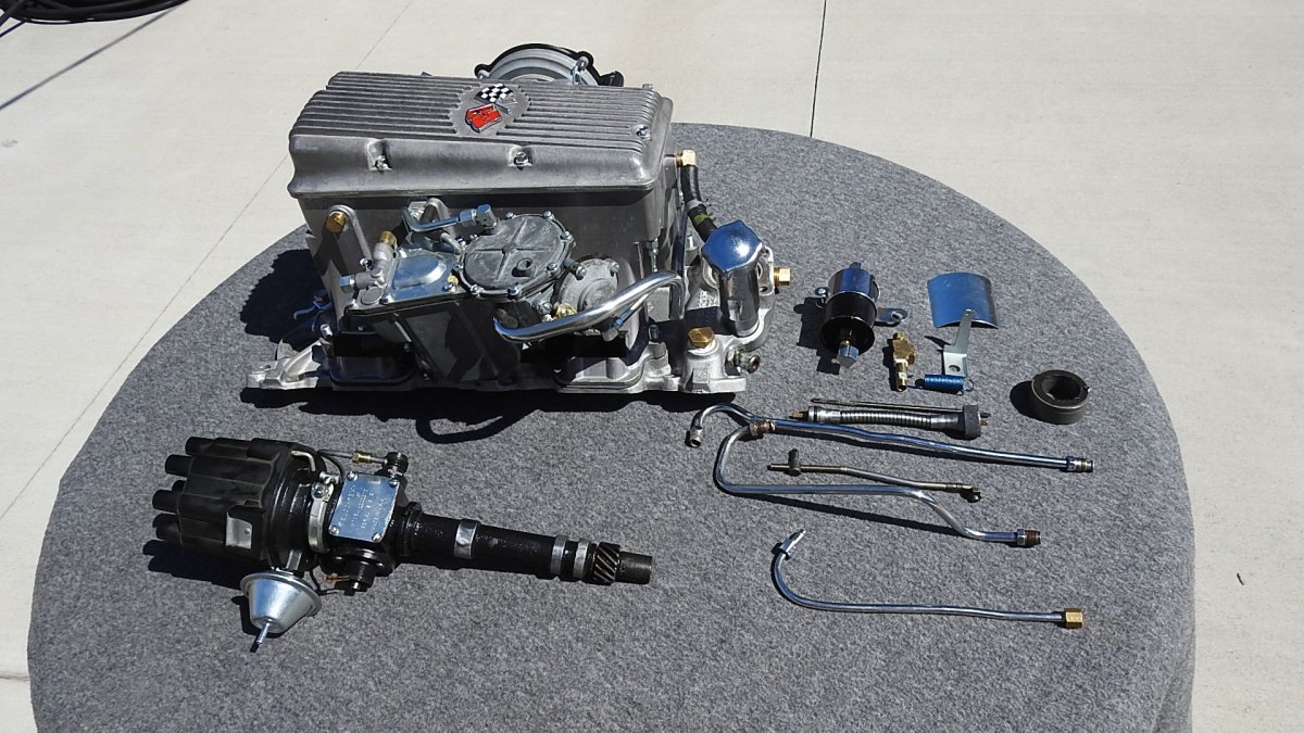

    I have 2 sets ups to work with, one complete , the other is all taken apart. The distributor looks good, but i suspect that will need to be gone through as well- I also have a fair amount of NOS GM fi parts .

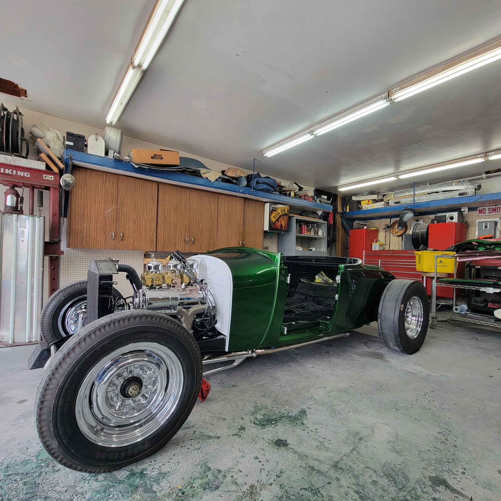

    I attached a couple of photos of the car ...

    I' think I have enough parts to make a complete set up...
    Aside from the mechanics of it all... I need to check to see if the distributor will fit in the car... it channeled and any extra real-estate is very limited-
    I would also suspect that it will cost some coin to get it up and running-

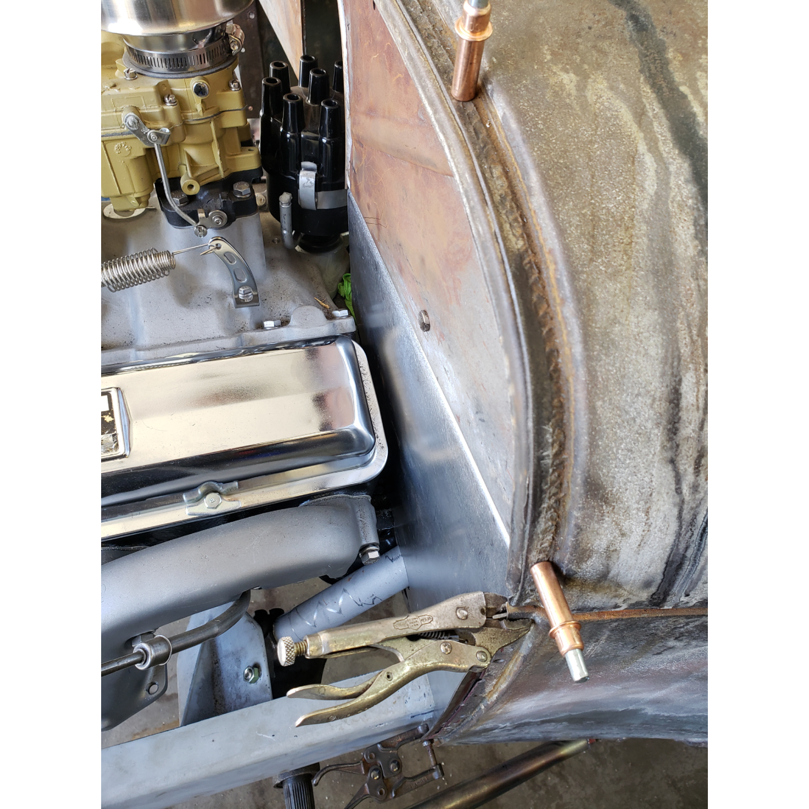

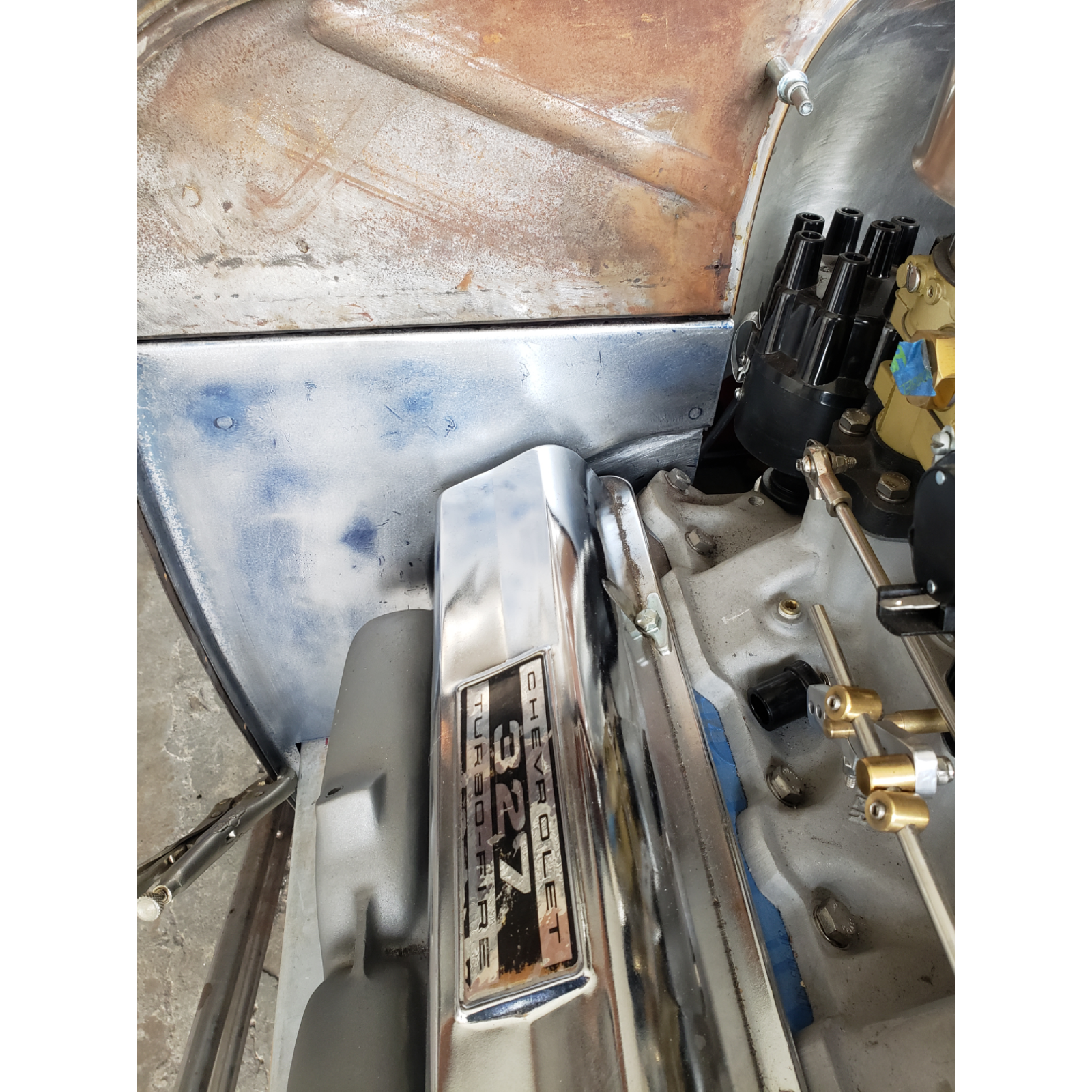

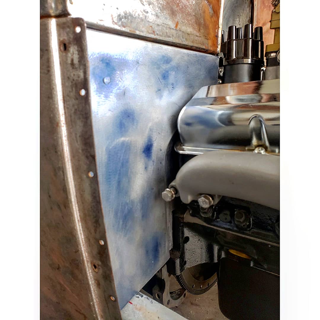

    Can you get me a measurement of the height of the distributor?
    Like from the mounting surface to the top of the distributor body & or top of the cap?
    I know these distributors are taller, and use a spacer... the catch is im not sure it will fit in my car, right now I'm running a 265 distributor, and it's pretty tight(channeled 29 roadster)

    It Will Fit Rich Since The Intake Manifold For The Rochester Injection Is Unique And Allows DSCN3959.JPG DSCN3959.JPG For Those Problems In A Stock Chevrolet Application And The Spacer Is Not A Concern...Proceed And You Will Love The Injection...
