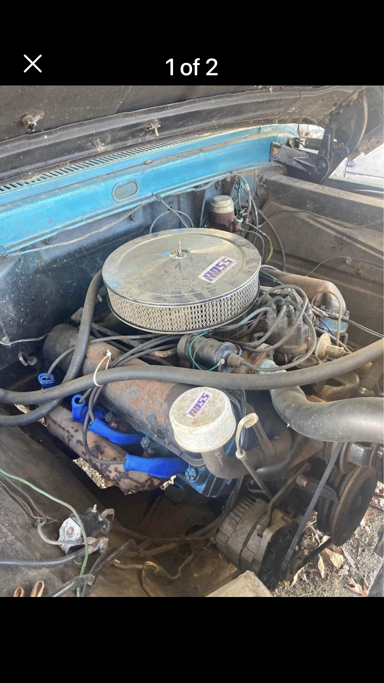

    Here are 2 pictures of the 430 MEL. It is from a 62 Lincoln, now in a 60's truck.
