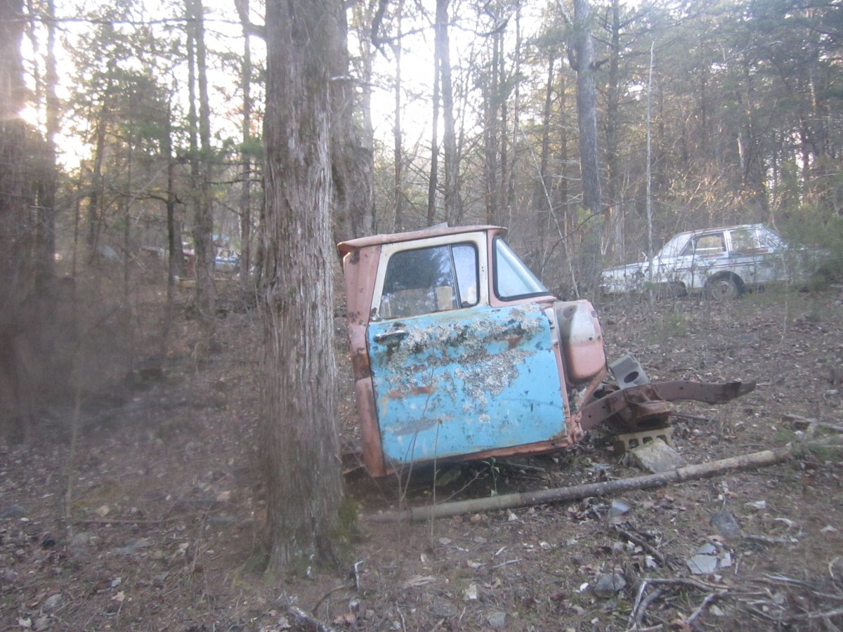

  12. I never thought the 3/4 ton rode or handled any worse than the 1/2 ton. In face the 64 thru 66 Chevys and GMC are very good riding and driving trucks. And I own dozens of them. Have always driven one ever since my Father bought a new 64. I would bet that 64 will ride better and handle better than squirels 59. model. Grayson & papa's truck 008.JPG 60 thru 66 trucks 001.JPG
    I know that V6 would out pull it. Now the V6 is a boat Anchor. It has pulling power but its a gas hogg. If the bodys solid. and the price right. Buy it and swap in a 250 six and SM 420 granny 4 speed. It will still pull but get good fuel economy. My daily work truck is a 66 GMC. A beat to death rough example I saved from a rollback headed to the crusher. and it works hard. I/2 ton 250 and granny 4 speed 336 rear gears. I aint afeared to load it. My wife has a 66 chev 3/4 her daddy bought new.292 six 4 speed and I seen her haul 7500 pounds of feed on it.
    Donuts & Peelouts and F&J like this.
  13. Its quite possible the GMC might have some of the problems you mention. However The steering and brakes can be easily upgraded by swapping in a 73 or newer entire front suspension and crossmember. all parts to fix the gauges and turn signals are easy to find brand new. The 60 thru 66 trucks can be upgraded without any fabrication. Its all bolt in parts. There are several engines I don't like and consider boat Anchors. and the V6 is on that list. A 60 thru 66 truck if the body is decent is a very viable project that will hold its value. I also have bought a truck or two in my life. In fact I still own most of them. 60 thru 66 trucks 013.JPG
