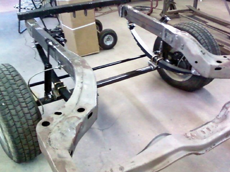

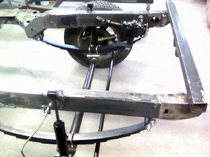

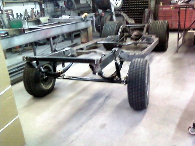

    did this 64 gto ch***isi this week for customer, I know narrowed rear ****s but it isnt mine... the tubing laying on the very front will come off gotta make a crossmember for the center of it with mtr mts on it for the 421 mtr

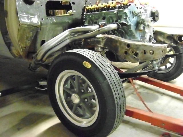

    Hi Guys,
    Making a little more progress here in Oklahoma. The front suspension is pretty close to being done. Still have to get the steering box mounted and connected but you can get an idea of how she's gonna look. Got the cool Hurst super cushion tires up front and Hurst Cheater slicks for the back.
    Since nobody makes fenderwell headers for a 64 GTO or any Pontiac for that matter I rounded up a set of fat fender small block chevy headers. The tube configuration is nerarly identical to a Pontiac Dport head. All I have to do is modify where they mount up with some J bends and a Pontiac flange and I'll be in business.

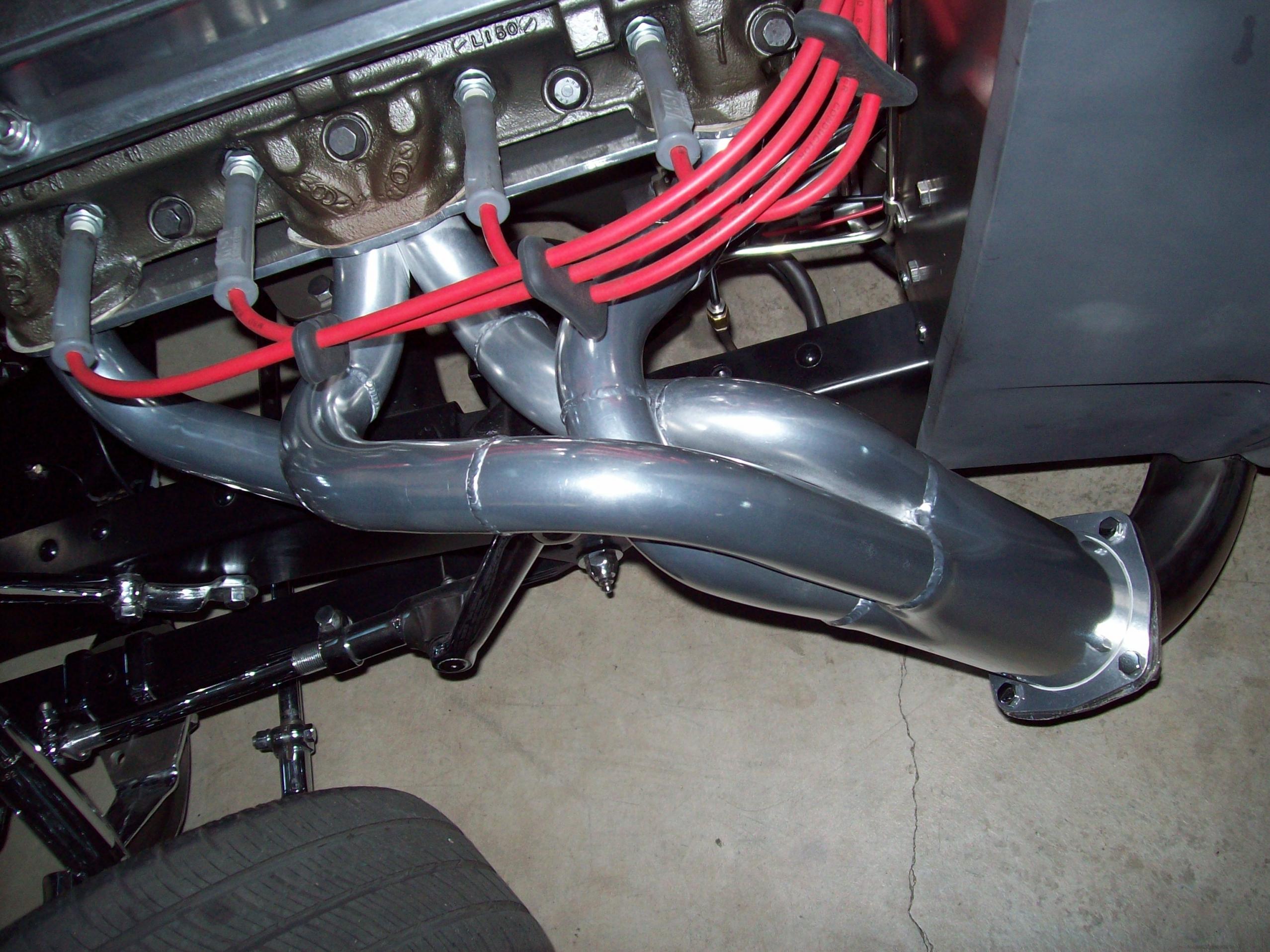

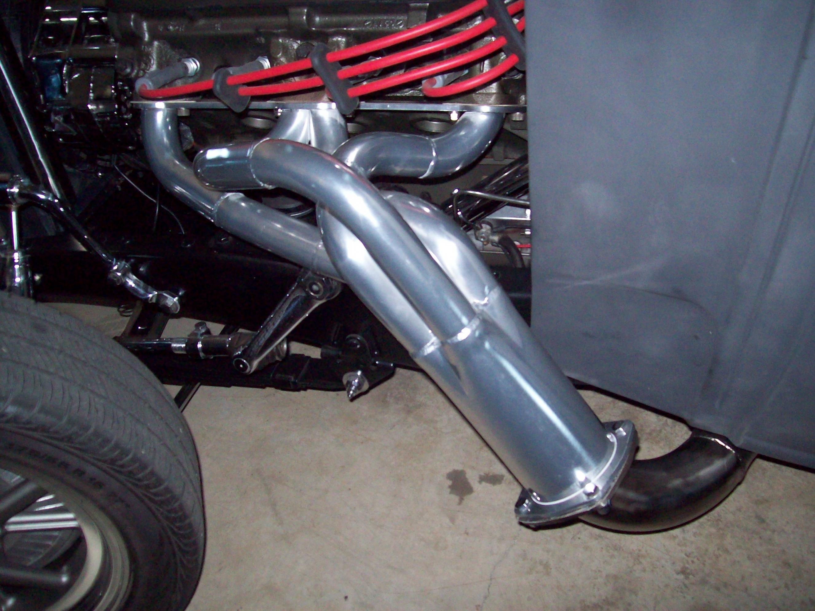

    I'm interested in more pics of the headers when you get them done. What headers? Speedway motors? I saw some that were 1 5/8" tube. I have an old set of 4 tube d-port cheapies that were 1 5/8" I was going to use to do the same thing for my 55. Bill

    55Chieftain,
    Yup, Speedway Motors, and I think the mfg is Dynatech. I'll have to go look again but I'm doing the same thing. Taking an old set of Hedman Hedders1 5/8" cutting off the pipes about an inch or so out, welding on some j bends I got from summit and will connect those to the new headers.
