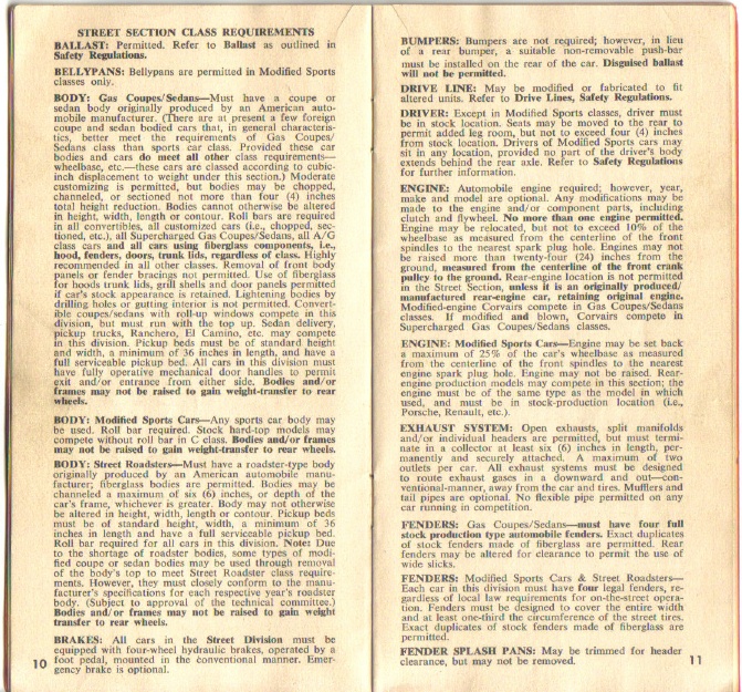

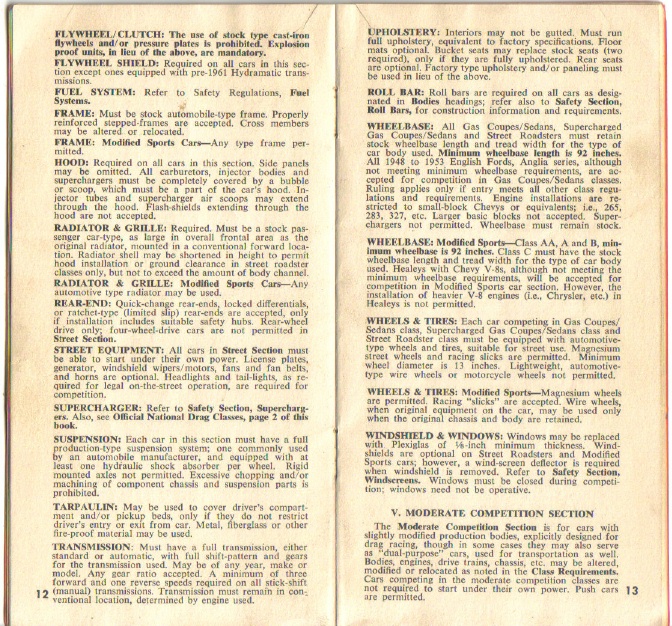

  9. The HAMB drags started out pertty much anything goes. Just a fun weekend for the fellas. Then it grew.
    I'll post the jpegs of the '64 rules I have here.
    Takes some sorting through. Gonna be pretty small to see so you might have to click on the image after it loads or down load the image and load it into your picture viewer and make it bigger.
    I have been patterning a build we have going on after these rules just becaus I have these rules and we kind of loosley base what is trad pretty much stopping @ '64.
    That is not to say that anyone cannot build one anyway they want. its a big world and probably a little bit of room for everyone.
    Anyway as you already know I'm not trying to start an argument with you. This is just the info that I have. I don't recall who sent me these rules.
    after you open the picture click on it again. it will open in a new window that you can click on the pic and make it big enough to read.

    porknbeaner ;;; my eyesite ain't good enough to read all that ,,even with my reading glasses ,,lol,,lol,,i'll try n find a magnifying glass i got around here sumwhere ,,hell to get old eh ???

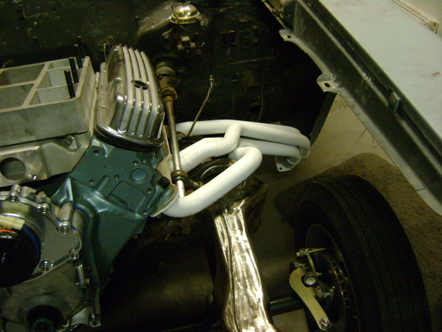

    I finished the headers and painted them flat white. Tight friggin fit for the steering shaft but it works. I also did some grinding on the blower intake and got that mounted. Just had a yard sale this weekend so I have a few more bucks to get the rest of the needed pieces to connect the steering.
