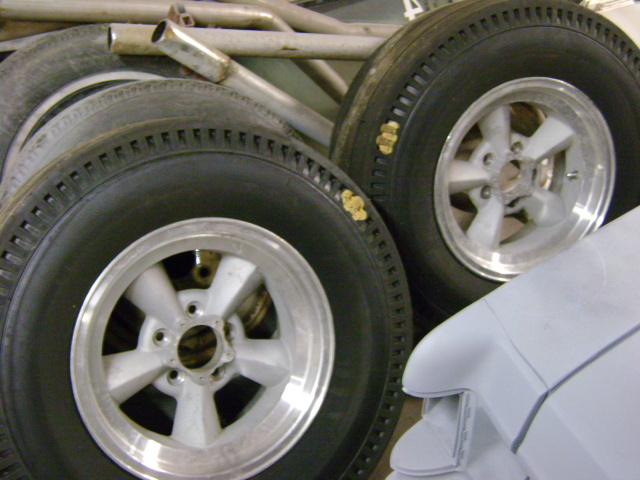

    HURST 8 1/2" Cheater Slicks on American Torque Thrust Originals for the back

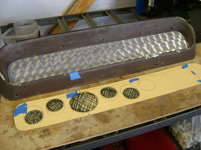

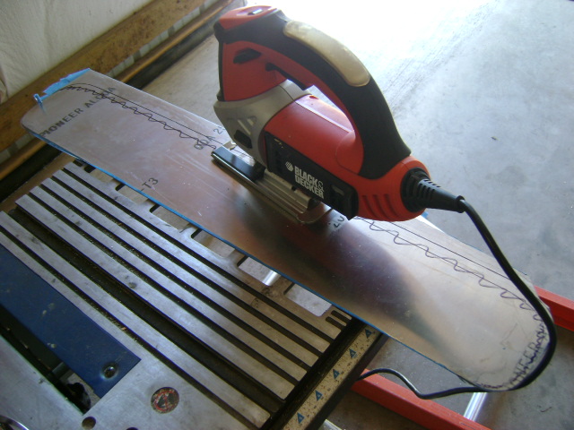

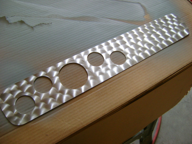

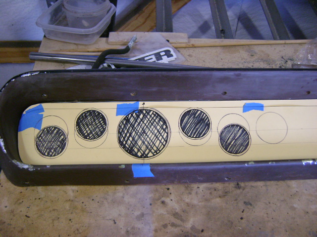

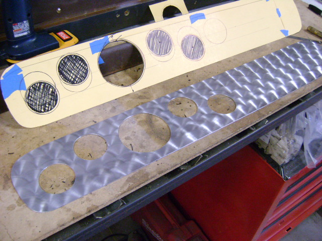

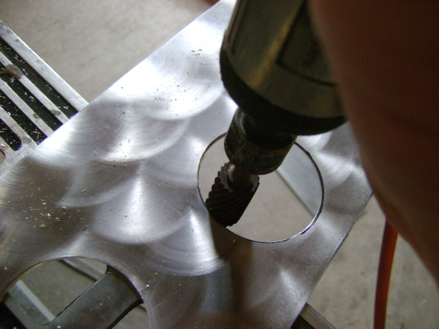

    The weather has been pretty nice this weekend and it got me motivated to get back after the 64. I spent this weekend working on the dash so here's some pics of what I was doing. I cut a pattern out of a piece of construction paper and then drew a few gauge layouts to see what I like the best. I couldn't find a 2 1/6" hole saw so I just used a 2" and reemed out a bit with a 1/4 grinder.

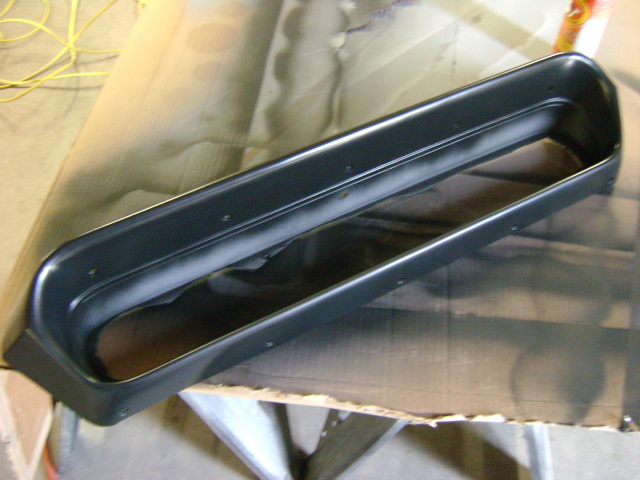

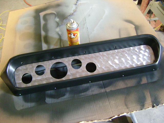

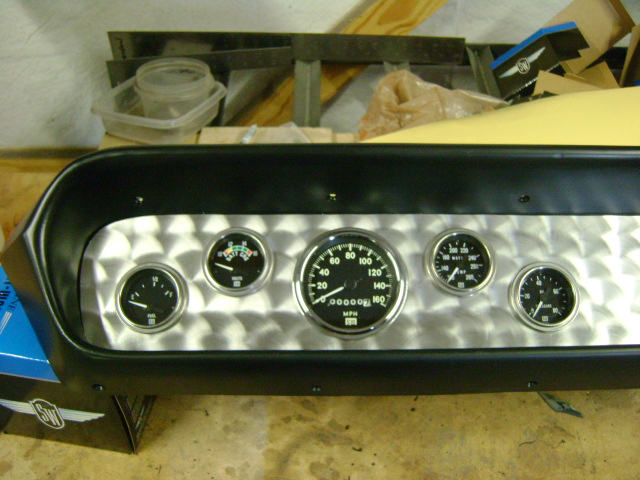

    I sanded the dash and shot some primer, then sprayed it with the original 60% gloss black. I chose to set the panel out at the first ridge rather than all the way back in where the original gauges were. Just a different look and more stright up and down than the way they originally leaned back deeper in the dash.

    I wanted to keep the dash looking period 60's so I went with the Stewart Warner Classic gauges.

    Oh yeah, the 3 1/2" moon tach is going to be mounted on top of the dash.

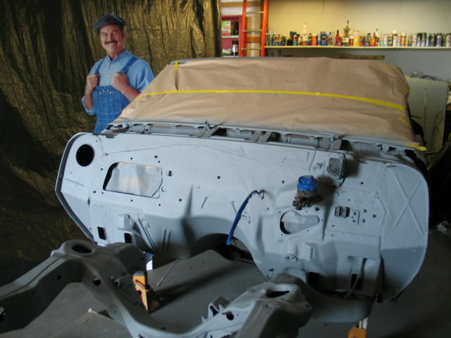

    I spent a few hours in the shop Saturday and got the firewall and chassis ready to prime. Today I shot the primer and it covered real nice. Next week I'll round up some semi gloss black and get her spayed so I can get the engine back in and get her buttoned up. Oh, Dave Lennox is a huge fan of straight axle cars and stopped by to check out the progress.

    nice progress, it's going to look fantastic. oh yeah..... nice overalls.
