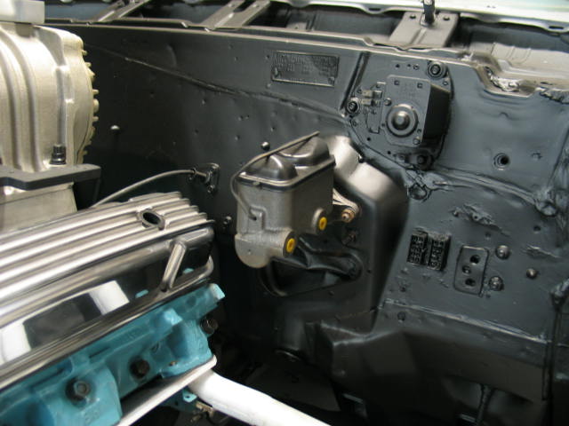

    I got the new Master Cylinder mounted last night. It's one that Speedway Motors sells and is real close to a GM style but the mount holes are about 1/4 closer so I did the right thing and fired up the 1/4" air grinder and reamed the holes out.

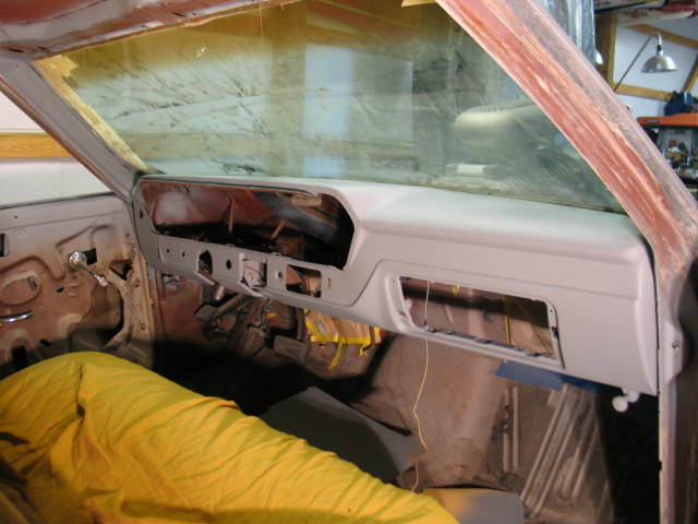

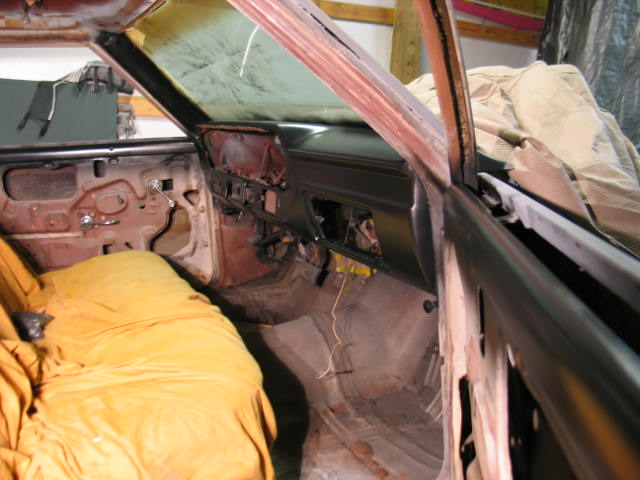

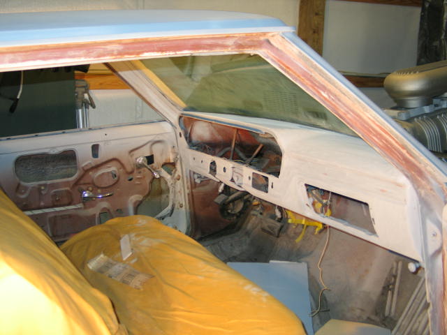

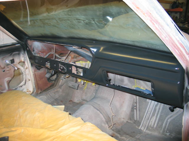

    Here's pretty much what I've been working on all day. I sanded the dash last night then primed and re sanded thid morning. I used the factory original 60% semi gloss black that Ames Performance sells to get the right look. I'm going to roll it outside for the first time since I brought it home last May tomorrow and snap a few shots. I'll post them tomorrow afternoon.

    Looks good. But you realize that the upper part of the dash is supposed to be a 0% gloss, with a 'suede' texture. I've got the PPG formula here for it somewhere as I painted the top part of my dash a couple of years ago.

    Who cares ! This is a Hot Rod not a 100 point concourse restoration

    Axle, It's okay, I was wrong when I stated that it was the correct color and sheen. I was going by my 66 dash. I think I'll leave it this way and see how I like it. Maybe I'll shoot some flat later.
    Twotoe, where is the line from semi to flat ?

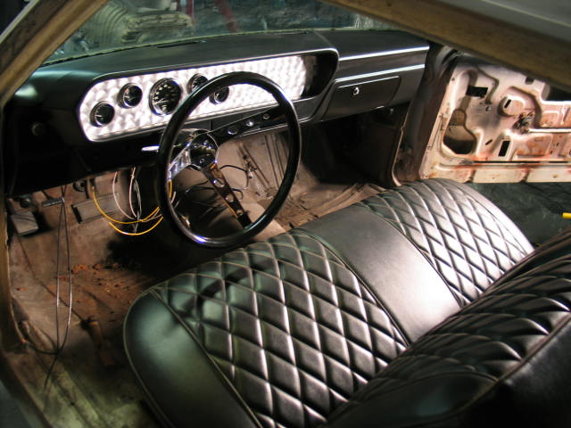

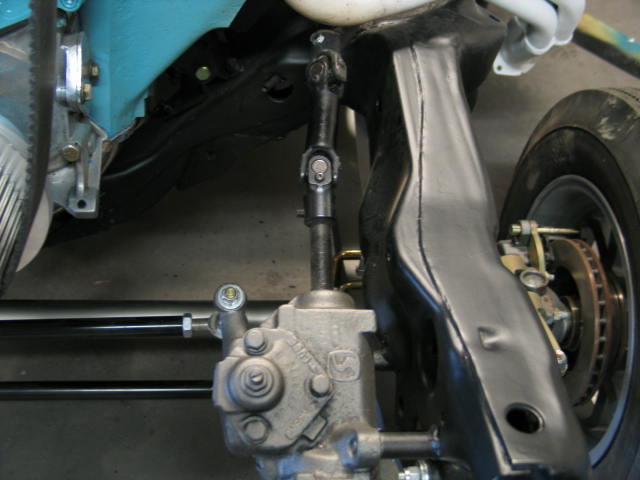

    Well it's been a very productive weekend and made some ground on the pile. I got the steering column in. Moved it forward about 3" for more room and mounted and connected it to the steering gear box. Welded the steering U joints in place along with a heim joint on the lower end of the steering shaft to the chassis to secure the lower end in place. And the dash is now in and gauges are pre wired. Have to order a steering wheel hub but you get the idea. Retro 60's wheel.

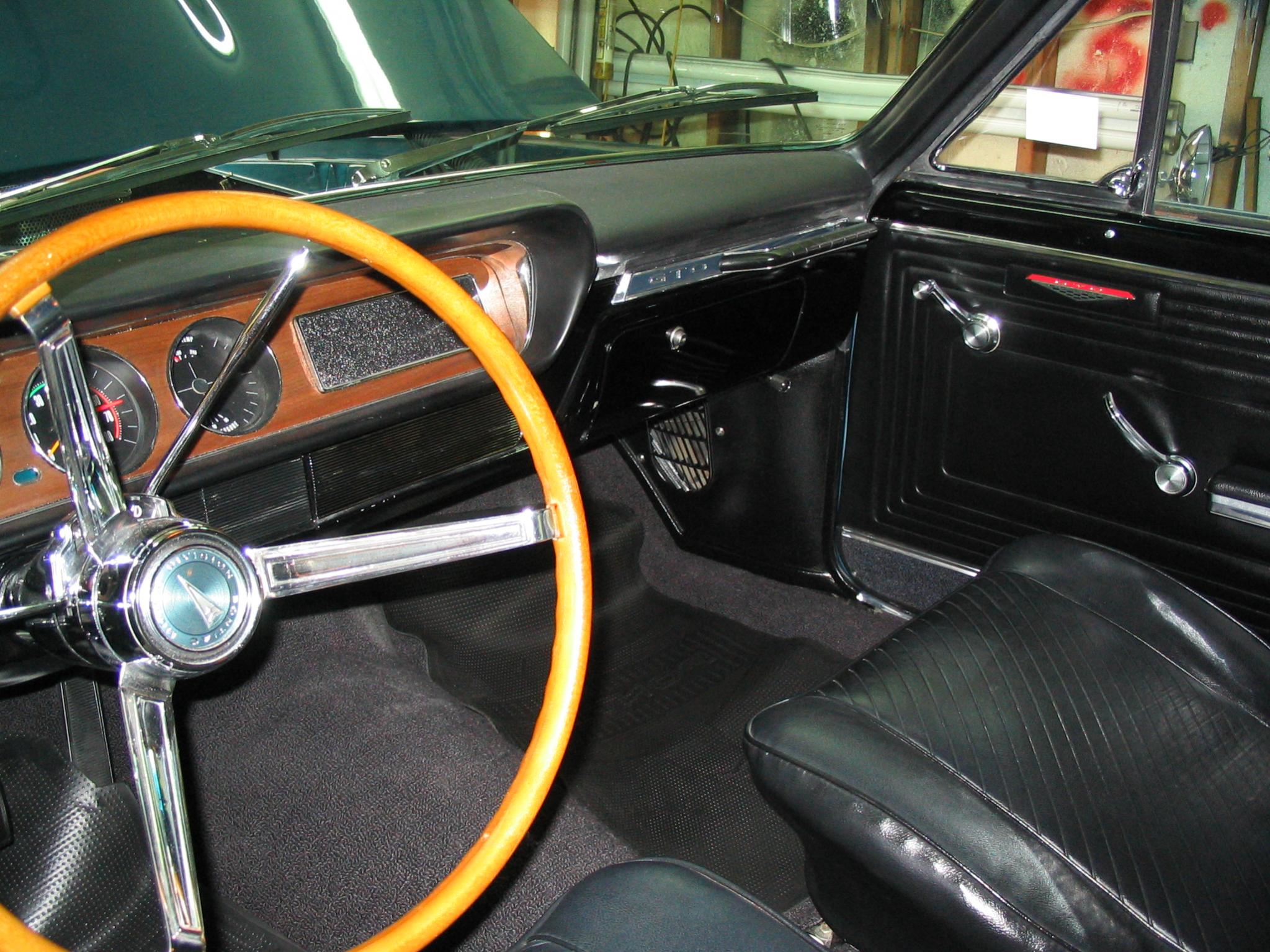

    The break line was right above the grab bar on a 65. I can't remember if you have a grab bar on a 64 or not. Let me see if I have a pic that shows it. Here is one that will give you an idea of where the break is. Not a very good picture of the break, but it is all I have right now. If you decide to redo it, I'll get you a better pic.
    BTW, the reason that the top has no gloss was a Federal mandate. It seems anything other than no gloss would create a glare when either the sun or lighting at night shined onto it. The Feds claimed it was a safety thing. Just FYI.

    I'll take you up on the other photos. If you can get one from each side of the main gauge part of the dash so I can see how they tied that in. If it's a line or did they just spray the whole outside flat ?

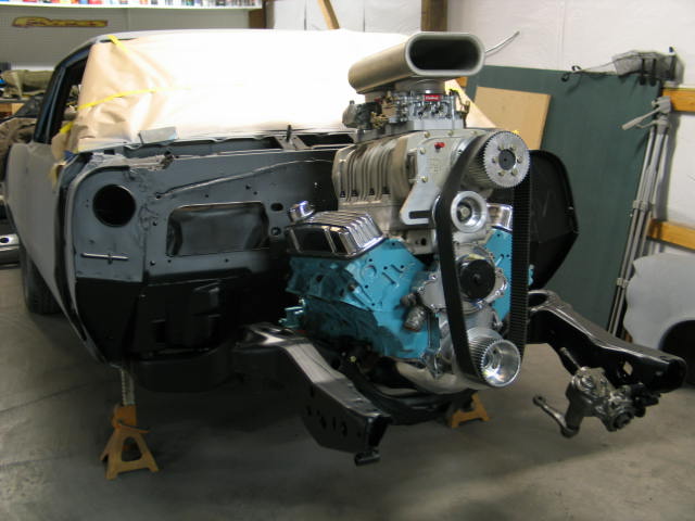

    The carbs came in today so I de-badged them and removed the electric choke mechanisms. I think Axle was right. The Carter style carb was the way to go and glad I did some digging into what was available. These Gold Dichromate finish marine carbs fit the 60's look I'm trying my best to stick with.
