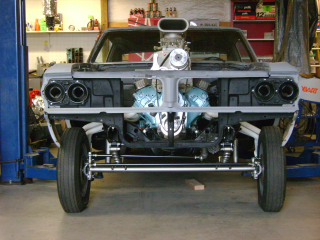

    Cl***ic, you had me thinking about your post today. I know this car isn't 100% 1964 true, but it's pretty close. There's always something to pick on on just about everyones car, but that's what makes us all different. I'm sure people will probably comment that my front wheels are not magnesium and that they have the word Rocket on the center cap. Whatever. I can't please everyone. As far as the blower goes I thought I did pretty good by just ordering an as cast blower from Don Hampton who I'm sure you have heard of. The drive pulleys are borrowed from my 66 GTO racecar since it is a much higher horsepower set up and I'm limited on where I spent the $$$ for this build. I may go down to the lower capacity 1/2 drive later on. However I did have to order the idler plate and idler pulley and I got those in raw machined form so they are not shiny either. I can tell you that Don started casting his 871 blower cases in 1968 and the 8mm drives came in to play in the early 70's. Now if I would have used the 2 850 Demon carbs like I was planning on doing until I set them on and saw how out of place and ridiculous they looked, I'd give you all permission to rip me a new one. I hope most of you guys can dig the look I'm shooting for. Thanks, Dil

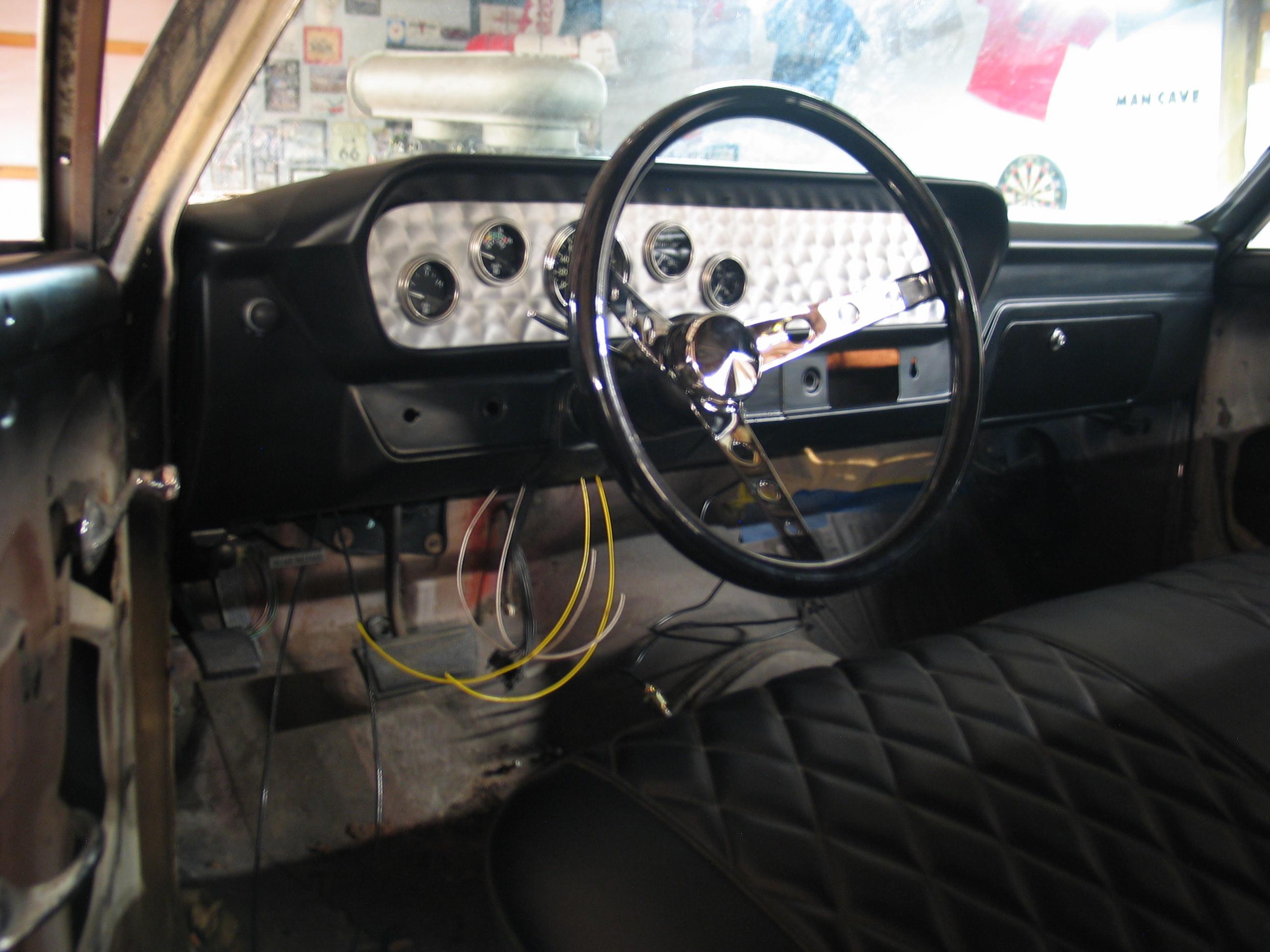

    I got the steering wheel mounted and the shock mounts welded in today. My boy was helping me with both. I love it when he hangs out with me in the shop. Going to work on the fuel system tomorrow.

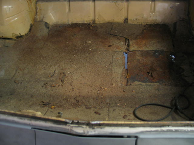

    Well this one is a first, and I've been saving it for the last part of the major body work. One of the "Genius" previous owners decided it would be best to glue asphalt roofing material over the rusted out trunk floor. Hey, I guess if it'll keep water outta your house it'll keep water outta your trunk right ? The floor is so bad that the first time I tried to open the trunk the latch was hanginging up. So I gave it a big jerk and the entire trunk latch ***embly came loose from the floor and stayed connected to the deck lid. So now I'll cut it all out and start fabbing up the mount for the fuel cell.

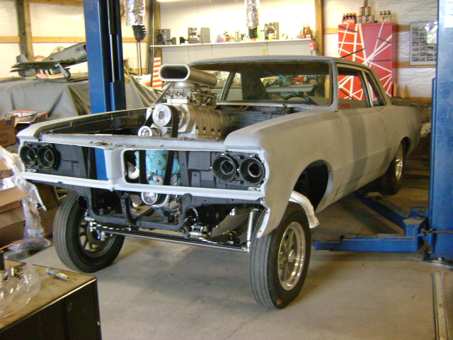

    I had to cut out most of the trunk floor due to it being so rusted out. Today I worked on fabbing up the fuel tank mount.

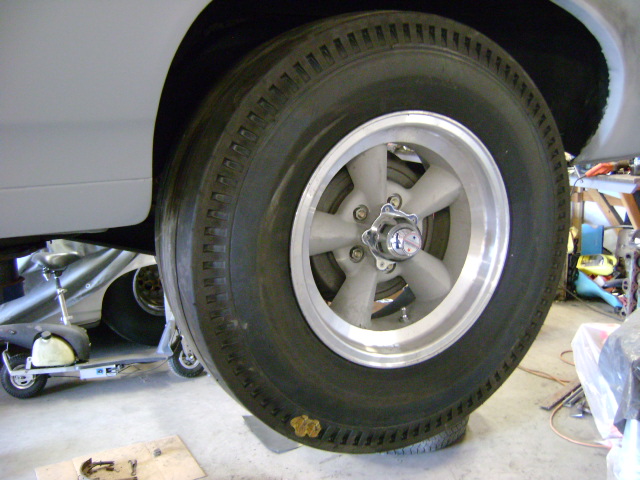

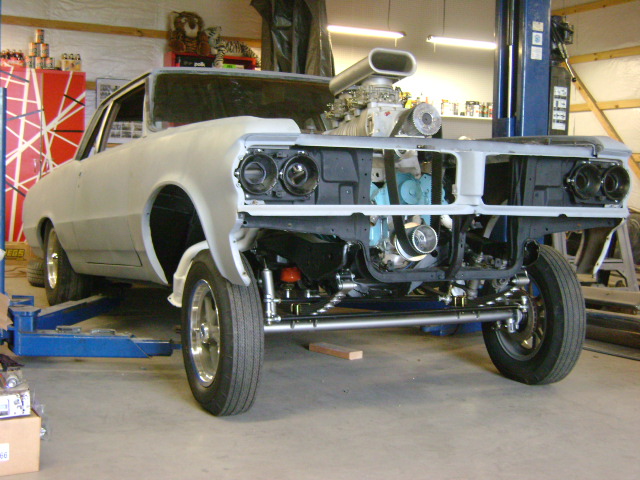

    Sat 4/22. I tapped the scoop base so I could get that mounted and finished. The throttle linkage is complete. I had Chuck at CW Auto Fab redrill the factory axles from a 5 on 4 3/4 to a 5 on 4 1/2 to fit the rear wheels my friend Nick gave me. I got them installed, put the brakes back together and got the wheels on the car. Both fenders are back on and the nose is bolted back into place. I had to trim the lower edge of the fender just in front of the wheel since the axle is forward a bit. Also had to cut just a little of the inner bend right where the header collector is. Came out a little on the close side. I also got the headlight buckets mounted that my friend Andre sent me since the car didn't have any when I bought it.
    I still have to fab up some shock mounts to fit the new coil over shocks and get the a$$ end raised up a bit. Right now she's sitting on heated, collapsed coil springs. The good news is that all of my measurements worked out okay and I got the right size tires. They clear all the way around :D
