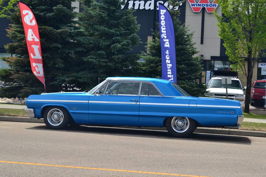

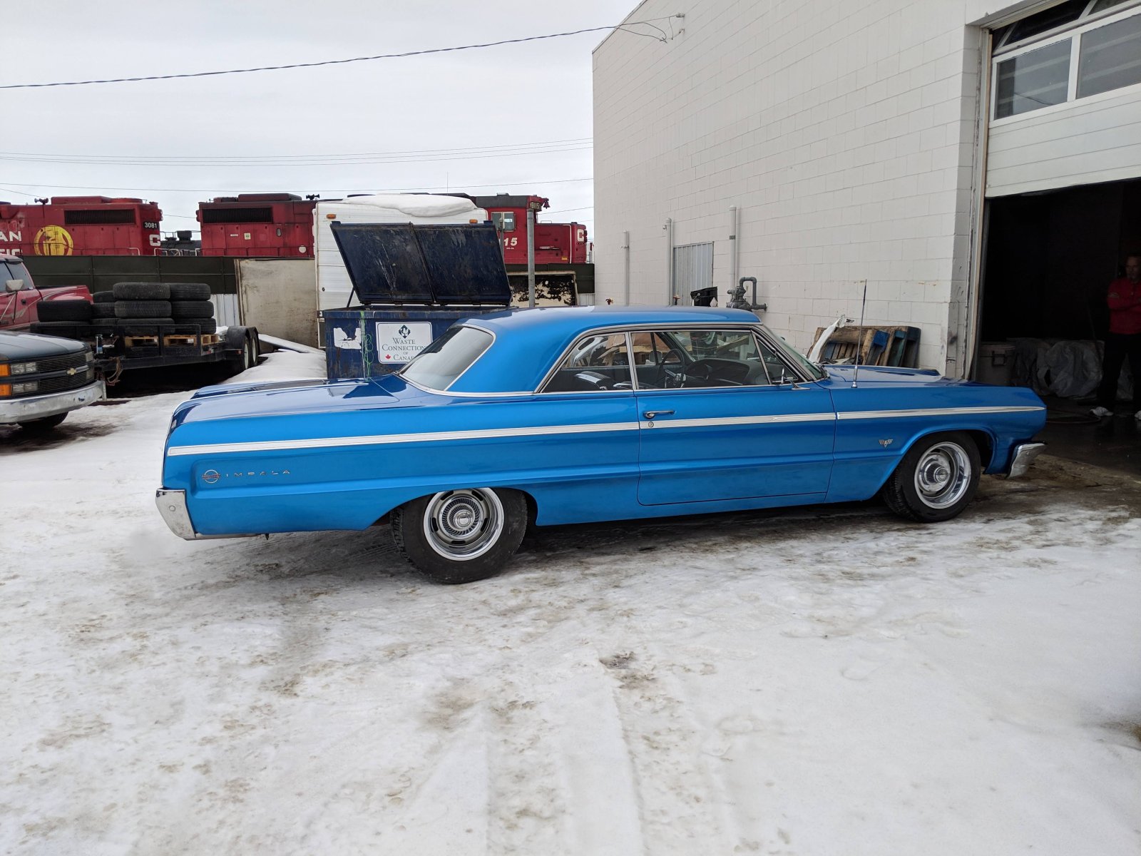

    Since you mentioned the muscle car look and a different stance, this is what I think of for a 64 Impala as a muscle car. Good stance with a rake and Corvette rallye wheels. This is my dad's 64 that he's had for 30-odd years. It has had a few iterations, but this is my favourite.

    Cool car! Super Sport too, that's awesome. And you don't see that level of blue on a 64 very often, so that's cool, and unique. I love the rallye look but dad hates that so that look is out for us lol. Since he and I share the car, we'll have to come up with something we both enjoy. I'm a fan of most things fairly traditional, rallyes, torque thrust type spokes, Cragar 5-spokes, or even a lot of other stock wheel/cap combos from the period. I do not, however, like the non SS hubcaps from 64.
    I'd love nothing more than to see several more pictures of your 64 somehow! Thanks for the share, I love it...
