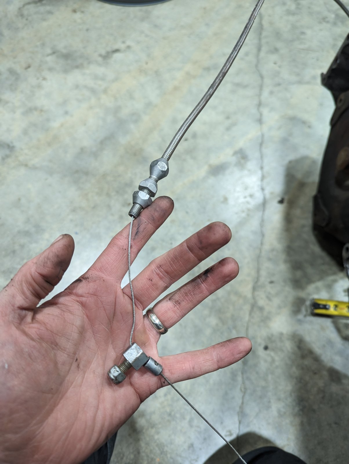

    The early Aluminum Powerglide is shorter and has a different output spline, compared to the later 60s PG. So he has to change the driveshaft yoke and shorten the driveshaft regardless which trans he uses.
    The dipstick and tube are different on the TH350, too.
    You don't want to use that braided hose kickdown cable or dipstick tube...really....

    Great points, appreciate the thoughts on that. Why are the cable kick down and dipstick a no-go, do they not hold up well over time? This TH350 was in a friend's 39 Ford that had a Chevy stroker small block in it. That's why it has the cable stuff on it I'm sure I don't even remember if it was in working condition but I believe it was. It's been sitting for 25+ years so I'm sure it needs to be gone through. I'll be looking into those parts costs for both and see where it lands me. Also going to get together with a friend who works on these things and see what his thoughts are between the two, not much to see without having driven the TH350 so maybe we'll crack into them both and see what's to see.

    The braided dipstick tube is very small inside diameter, it's a nuisance to fill the transmission. Aside from how "street rod" it looks. The cable can be made to work, again it looks totally out of place on a car that fits this forum...I'd rather use the OEM cable. Some guys just don't use the cable at all, which you can get away with on a T350, since it only does the kickdown function. I like having a cable, myself. Although it's been a long time since I had a Th350 in anything of mine.

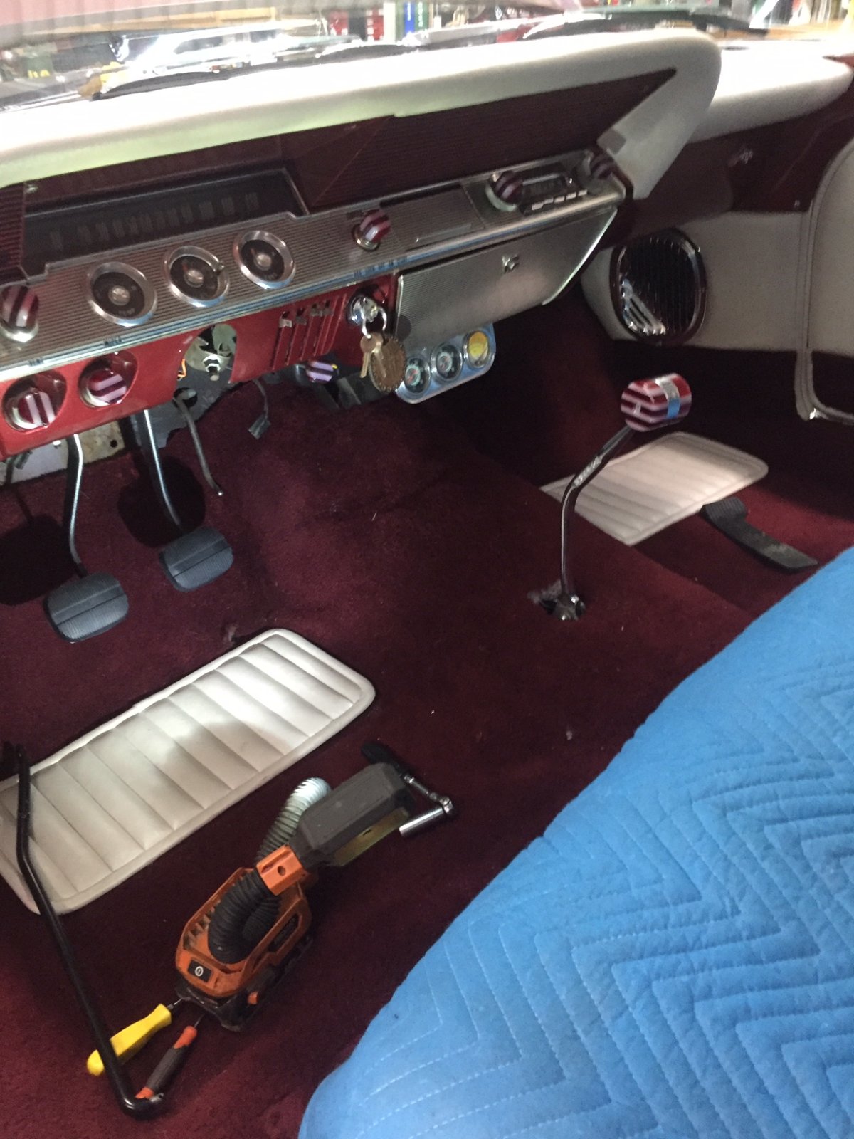

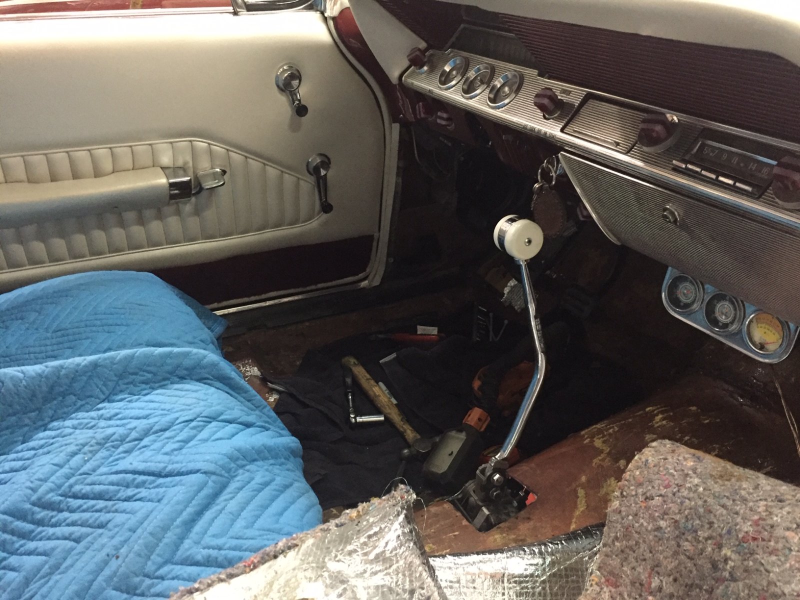

    Hang a clutch pedal in it and put in a 4 speed. I pulled the th350 out of my 61 and put a 4 speed in it last summer, way more fun to drive now!!!! everyone is different but I think real hot rods have 3 pedals. there were plenty of cars like yours that came with manual trans, finding pedals would not be hard... 4spd.JPG 4spd2.JPG 4spd3.JPG 4spd4.JPG 61slick.jpeg

    That is one killer bubble. I like 4-speeds too and have a couple hanging around in the shop. I have a rebuilt Muncie M-21 complete and ready to go that I pulled out of the 65 El Camino we have when we swapped to a modern Tremec 5-speed in that car. With the 64, I think I have a hard time not going full SS conversion with buckets, console, interior package and SS trim if I go the 3-pedal route. I know they made a few limited option go-fast cars those years that ran bench/stick but I don't know how common that was and it might not fit with this one. I almost cut it in and went that way a few years ago but decided against it. I think I would prefer to have either the bench/column or the buckets 4-speed, either going full SS clone route or keeping it standard hardtop. That's a tough one. Something about throwing my arm over the back of the bench seat with my bride by my side you just can't get in a bucket seat 4-speed car, ya know? hahaha.
    That 4-speed/bench setup looks great in your 61. My El Camino runs a factory bench frame, but we bolstered it so it has kind of a bucket/bench combo look to it. I love that bench/stick look. The El isn't a HAMB friendly build in pretty much any way so it won't show up around here lol but it sure is fun to drive with a hot 454/5-speed/12-bolt posi. bright blue, 4" cowl, ghost flames and all kinds of billet. haha don't puke....
