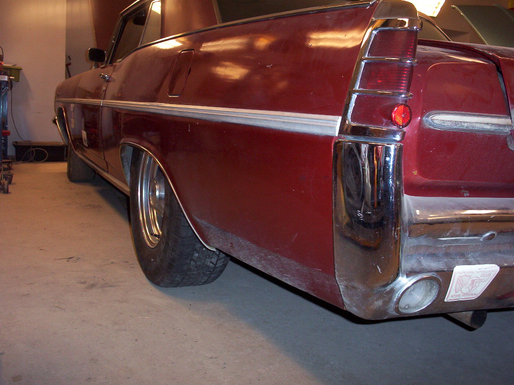

    Speaking of Pontiac wagons with eight-lug wheels

    Maybe I will just fix these! Nice!!!

    Obviously chicks dig 8-lugs! (i do too - and that pic!)
    Keep them man!
    I would never swap those out to a 5 lug set-up...
