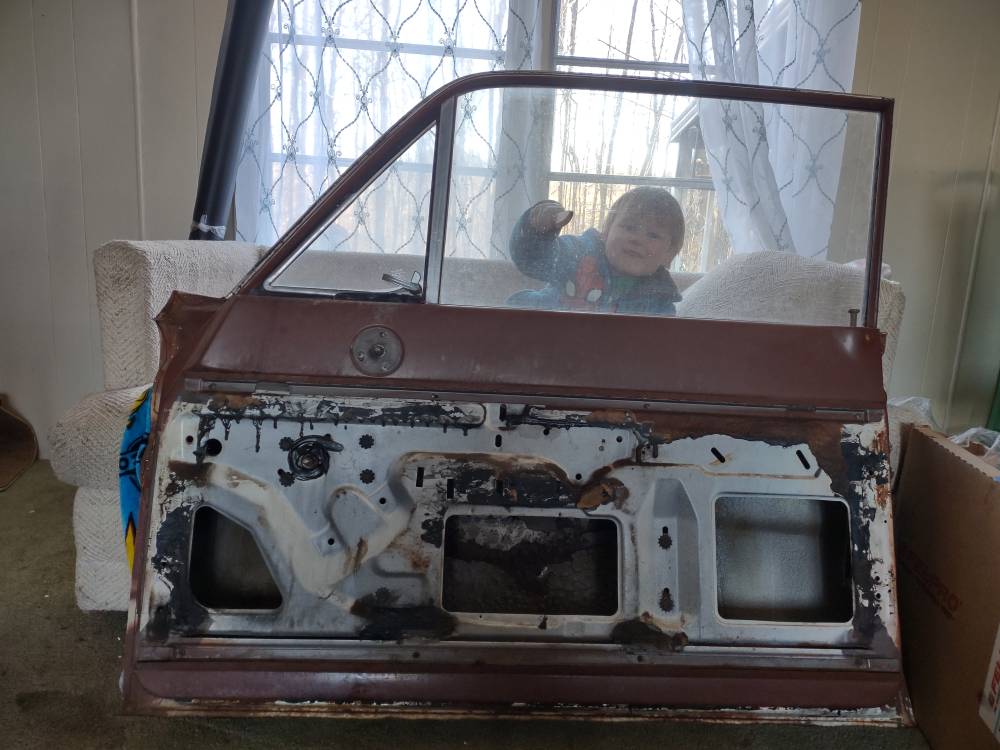

    It's car season!!!! (Don't worry, I already apologised to my neighbors lol)
    So just some explanation of what's going on in this picture, I brought the door inside to try to get started for the season. It is still too cold for me in the garage, in fact just bringing the door inside I most a lot of body heat which took me a while to replenish, but it was still worth it. I'm going to be making a template for the door panels since mine were completely rotted when i took the doors off. I might get some flack for this, but this is what I did.. went to home depot to get some particle board or some kind of thinner wood board to make the (very) square door panels. I got some foam and marine leather from joann's. Once I get this process actually moving, I will show pics. Let me know if you are interested step by step of what I am doing. I will try to get pics of every step if there is any interest of how I am completing this, but I will need to know beforehand. So thankful for the warmer weather ahead! IMG_20210313_162743201_HDR.jpeg

    Just got back from the dollar store to get poster board to make templates for the door panels and realized they're slightly too small. Don't have cardboard big enough either.. so I'm going to have to figure something out here, but yes I am still working lol

  14. warhorseracing
    Joined: Dec 26, 2006
    Posts: 2,999
    warhorseracing
    from cameron wv
    Good to see you back and your inspector is telling you to wash the window.;)
  15. Aww come on mom, you know I have to inspect each step of this build. [emoji56]

    Sarah, I have never used it but if you can find the corrugated plastic, like cardboard. I have read that several people are using it instead of anything that water could effect, wood. Check into that material before jumping in and ***ociated moisture ruining your work in just a few years.
  18. lothiandon1940
    Joined: May 24, 2007
    Posts: 33,204
    lothiandon1940
    ......I think a lot of people are using tempered hardboard for door panels (and other panels). It's similar to Masonite, but I believe it's even more moisture resistant. I would avoid particle board, Sarah, as I would think, unless coated with something, it might attract moisture.
  19. Unique Rustorations
    Joined: Nov 15, 2018
    Posts: 623
    Unique Rustorations
    ^^^X2
    Seal the opening with good plastic before installing your panels then if you are not using anything real water or moisture resistant just imo.
    Randy
  20. Hang'emHigh
    Joined: Dec 31, 2009
    Posts: 224
    Hang'emHigh
    X3
    Used heavy plastic, like for greenhouse walls. sealed it to the door with 3M strip-caulk. Keeps mine water tight and durable.
  21. mad mikey
    Joined: Dec 22, 2013
    Posts: 9,606
    mad mikey
    Sarah. Home depot or a hardware store like Ace should have the thick plastic for a moisture barrier. Well worth doing for the door area.

    Thanks for the input guys! I actually have whiteboard material and want to see if I can get that to work.. I have water proof sealer for under the tiles for showers.. was going to put a layer of plastic under that as well. Way more sturdy than the original particle cardboard that was originally in there to begin with. Unfortunately the door panels do not cover the whole door panel, so sealing just the door panel I am making will not keep anything out. Mac has a seal set for a little over $500 that covers the whole car. Thank you, stimulus, I'll take that! Lol
