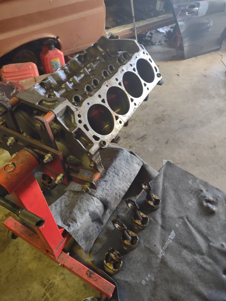

    So it's been a while since my last update. Unfortunately for me PA has decided to go from winter to summer in less than a week. Due to the weather being unbearably cold I have not been in the garage much and I was running out of things to do inside. Fortunately the weather broke and I am now able to do garage things! Since the last time I was on here I traded some various parts I had laying around for a new 302 block with a (good) crankshaft in it. Mine was pretty worn... So it just seemed like an easy deal for me. It has new main seals in it and a new crankshaft, so to say I was excited is an understatement. With all of that out of the way, we measured the bore of the cylinders to double check they were the same, which they were. I removed the rings from the pistons and (painstakingly) cleaned them. Currently we are putting them in the new motor. We are halfway done but taking a dinner break, so I thought I'd update you on progress.
    And I know I'll get some comments on my picture so before anyone says anything I do realize I need to clean the motor surface, I'm getting there lol

    That 302 looks like a roller lifter motor. it should also have a 1 piece rear main seal. Make sure you use the correct balancer and flywheel. I am hoping you also know it won't bolt to the original trans..... it would be a 5 bolt bellhousing, the 302 is 6 bolt.
