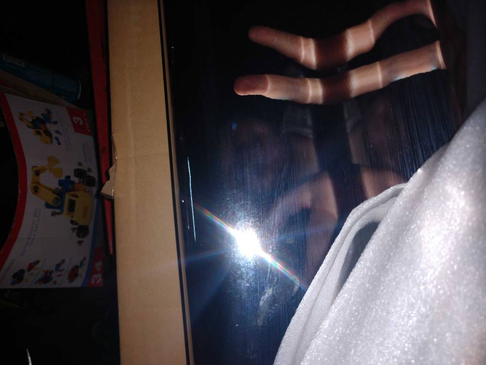

    So I ignored Craigslist guys desires and went along with it just to see what's parts he had. May I say I AM GLAD I DID!!! I already had a rear bumper but it was really rough. I was more than ok to use it, but this guy pulled out a box for a brand spanking new rear bumper! You can literally see my reflection. They normally go for around 600 +tax/shipping.. he sold it to me for $300!!! This dude is just a perfectionist and I understand it to a point. We both have an undying love for the falcons and we quickly became friends. We seriously talked for thee hours and he even GAVE me a fender cover with the word Ranchero written on it fresh in the bag. I WILL be going back to get more parts, just ran out of funds.. couldn't let that one go. That's not all I did today tho and I'm still not done. Currently as we speak I am grinding out between the cab floor and back cab wall so I can spray it with primer and seam seal it. Don't judge my seam seal job, as I know it will be covered and frankly, I just wanted it to do its job. I'm so glad to be working on this again, you guys have no idea! And again, you guys are the best, I love showing my project and having support from you all. It is a cruel world out there, but you guy make it all worth it. Sending positivity! 1597711537893.jpeg
