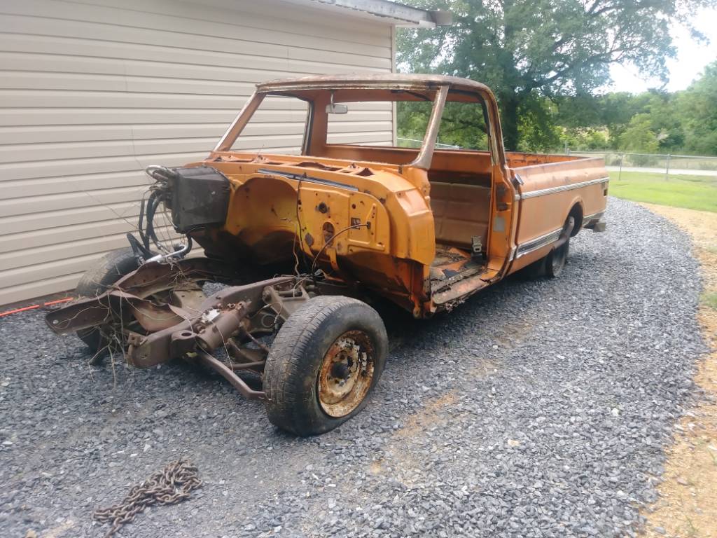

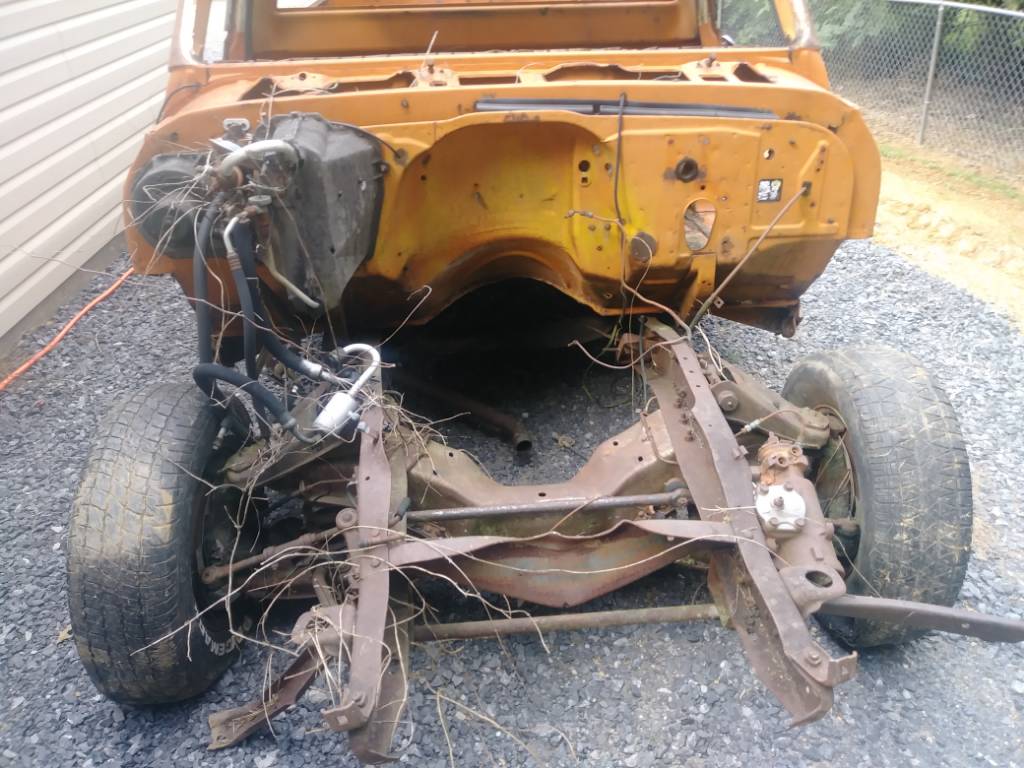

    Got the 72 out of the woods today. Wife found 3 tics on me. 20190627_170610.jpeg 20190627_170557.jpeg 20190627_170629.jpeg

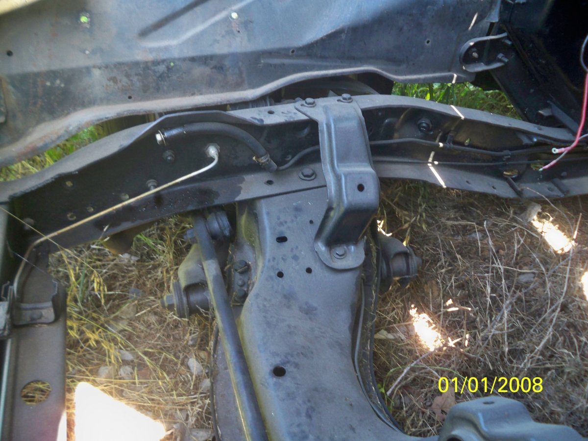

  15. You have to drill two holes for the later pitman arm. and 4 holes to mount the sway bar brackets. The 73 and newer entire front will work and you have rubber A arm bushings. The one you have has steel parts. front and rear ends 001.JPG The first I ever did was on a 62 GMC it got a 73 front and worked great. much better than the original torsion bar suspension. Ive sold three of those front ***embleys in the last month. We are parting out 16 square cab trucks.

  28. I did the crossmember swap on my '63 knee knocker several years ago. As previously mentioned, drill 2 and elongate 2.
    Donor truck was a '70 something C10, I used all that I could. Rear axle ***embly, master cylinder, power steering and of course the crossmember. I also installed 2" drop spindles and 2" lower front springs and '90 something Jeep Wrangler rear coils in back.
