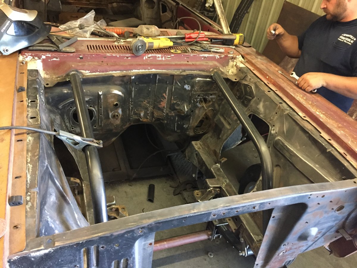

    are those bars just welded to the firewall? Will they be tied into the cage later?
    els likes this.
  6. rocketsled59
    Joined: Mar 14, 2010
    Posts: 843
    rocketsled59
    They are welded into the joint where cowl and firewall come together.
