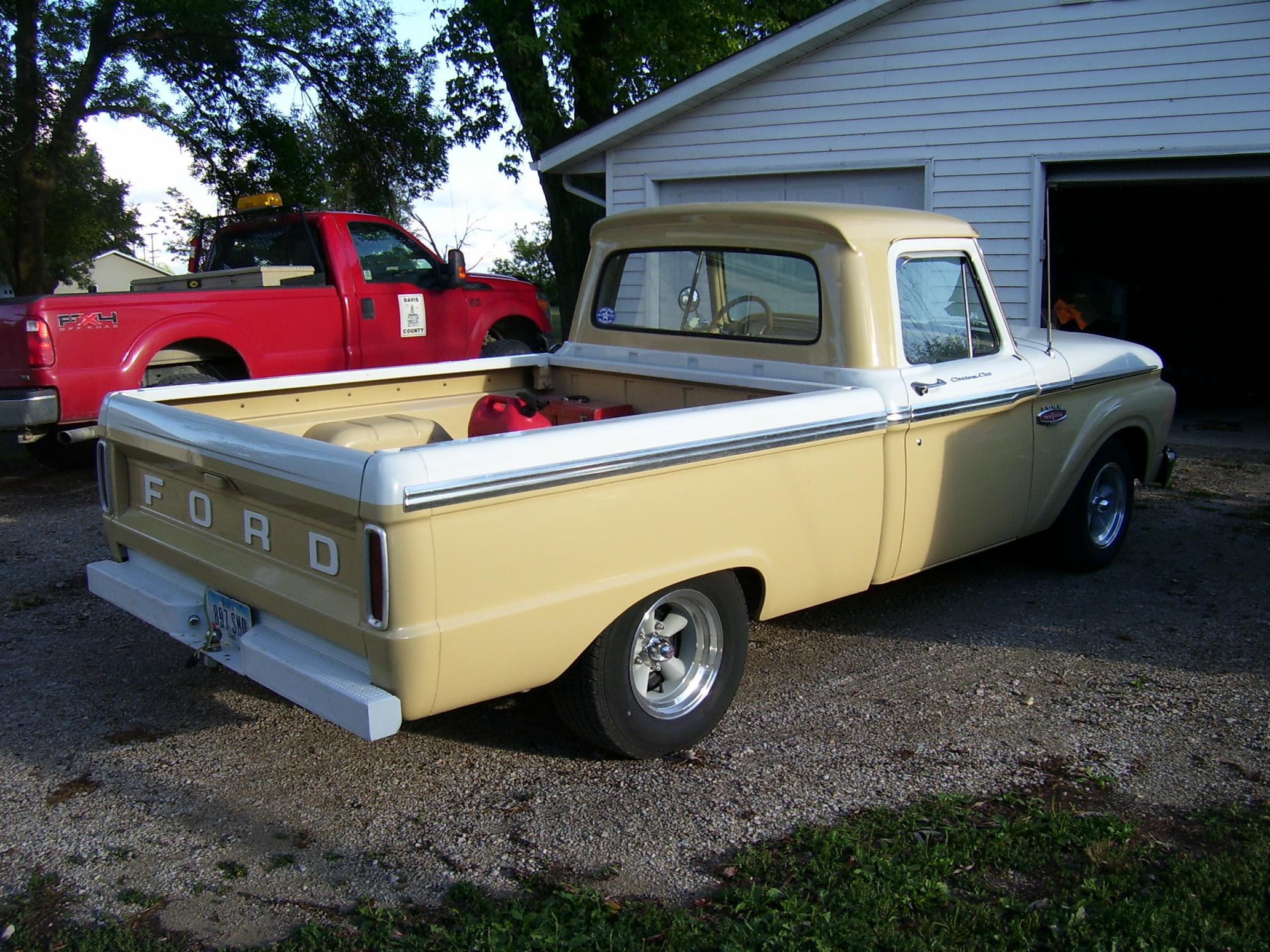

What was your front wheel off set? I am almost completed on my 62 crown vic swap. I am making the rear arm mounting plates
Cut springs on the front and de-arched rear springs. Drives great. Don't know how many coils were cut, it was done when we traded. SPark
