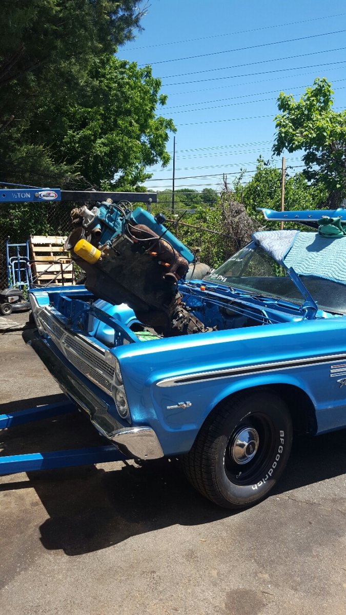

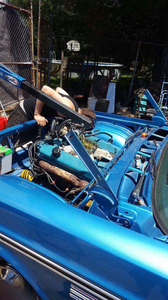

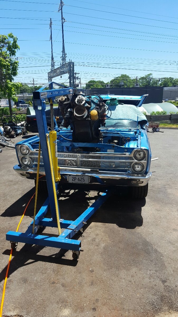

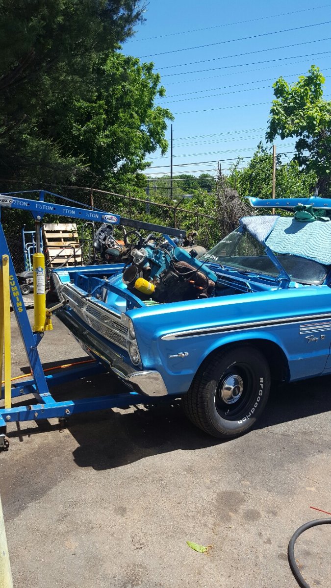

    Hello!
    You all provided a lot of valuable commentary and help when I was deciding what to do with the 383 in my '65 4spd Fury. As I'd mentioned, I ended up going with an already done 440. The 383 came out this past Friday, so I thought I'd provide some pics to anyone interested. I'll update as I do more work in the car. I should have the engine by next weekend, so it's prep, cleaning, engine compartment detailing, ***embly, drop-in, etc.
    Chris
