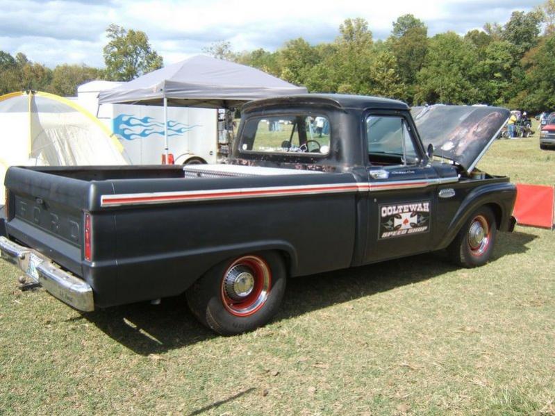

    15X7 fronts and 15X8 rears painted black with '65-'66 Hi-Po caps and rings.
    Like this...

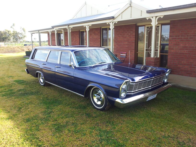

    The thin whites came with it on 15x5.5s. The coker's are 225/75R15s on 15x6s.

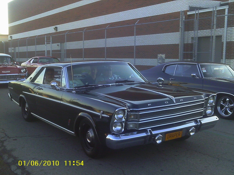

    This one is perfect, I should have bought it when I had the chance:
  9. O. Speed Shop has the right combo in my mind! ~sololobo~

    That drips of class right there ^^^^^^^^^^^^^^^
    Winner Muttley!
