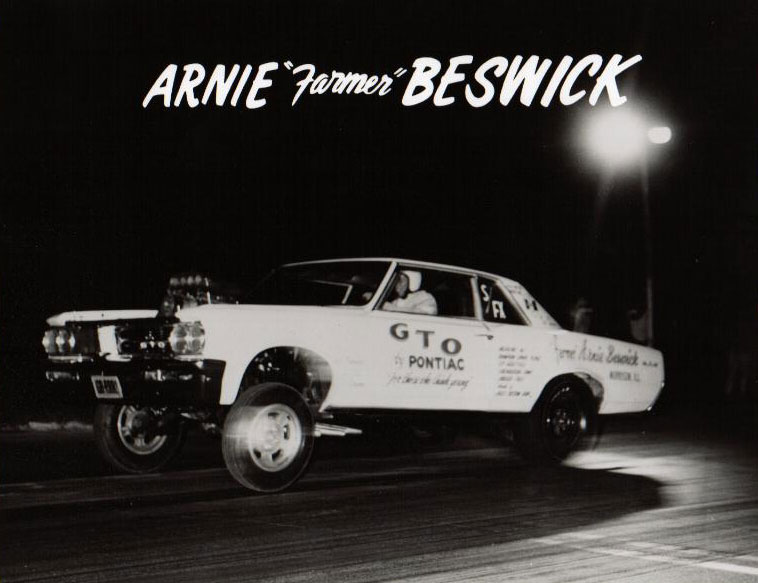

    Here is a FX 64 GTO.

    Please verify is this pic of the Farmer Beswick 64 GTO does have a straight axle.
    Factory Wheelbase or Altered?
    It is difficult for me to tell.

    Beswick's '64 GTO "The Mystery Tornado" was never altered or straight axled. He had some light springs in the front. When he took off from the line the front end would raise up so in still shots like that one it "looks" like the car had a straight axle.
