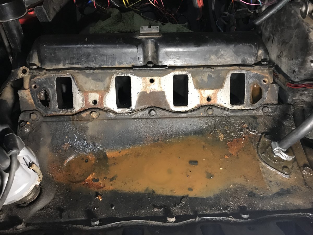

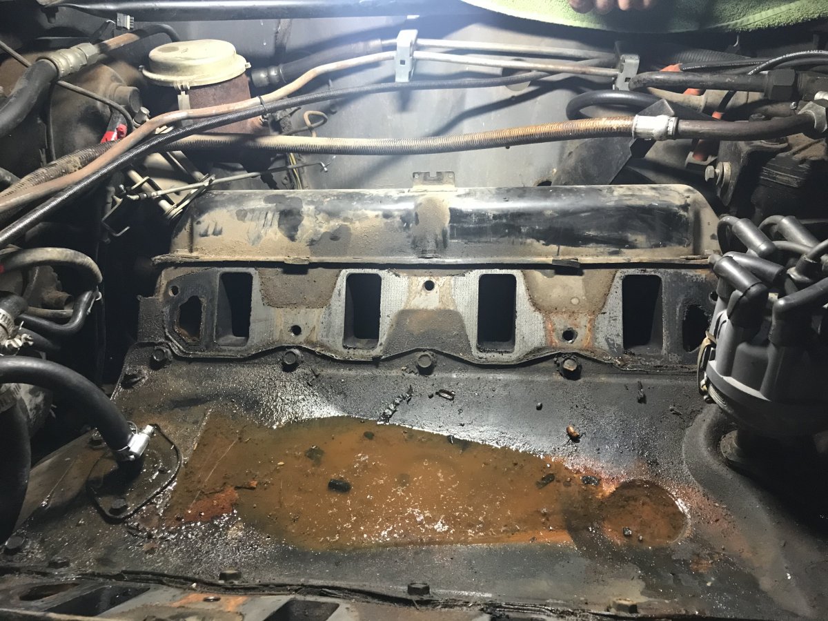

    My brother and I are getting his Lincoln up and running again and when we fired it up today there was a steady small stream of coolant collectingunderneath the intake manifold and dripping off the back of the engine block.
    Checked all hoses and no leaks anywhere that we could see.

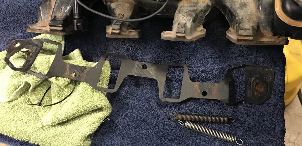

    Pulled the intake and found the front 2 coolant p***ages blocked off with the gasket (see pics). Is that normal?
    Can you guys see any obvious signs of leaking that we are missing?
    Any place else that leaks coolant underneath the intake?
    Thanks!
    Russell

    Go buy a new intake gasket set and see if they are blocked off in the new set.

    The new gasket we got this morning also has them blocked off, so it must be normal.

    The front coolant ports need to be blocked off. That forces the coolant to circulate to the back of the motor properly. They are only there because Ford could use the same tooling for left and right cylinder heads if the ports were symmetrical. Letting the gasket do the work is much cheaper then having separate left and right tooling.

    We got the intake off and cleaned up. Quasi pressure tested the manifold off the car and didn’t see any leaks on the manifold itself. Cleaned up the mating surfaces on the manifold and heads. There was some pitting on the rear water ports of both the head and the intake.
    Also found that the previous owner overcame a m***ive deformation on the coolant expansion tank by using a **** ton of gasket maker so that’s a problem.
    Put it all back together with felpro gaskets and tightened the manifold bolts first to 12 ft lbs, then 18, then 26. Hooked a hose up to the radiator inlet and just started putting water in and got a slow leak on the driver rear water port..... this was with only hand tight pressure on the system.
    Not sure what to do now.

    Yes, The Intake manifold has a coolant p***age that leads from the rear of the heads, forward to the thermostat mount that is in the front of the intake. It also serves to warm up the floor of what is a rather large cast iron "Air Gap" style manifold.

    Just read this, I can't believe you didn't see the three Welsh / freeze plugs on the underside of the manifold...this is where they leak as well as the rusted out byp*** pipe.
