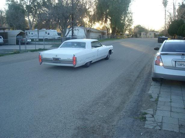

    here is a caddy i just recently finished for a buddy of mine .
    shaved trim holes
    air bagged 4 corners
    converted front suspension from strut arms to a-arms
    ...coming back to me in a week for engine driven air .

    day the owner picked it up ....his name is eric estrada .

    Is that front suspension mod necessary to bag a Cadillac of this era? I have a '68 that I'd like to do in the future, I figured it'd be pretty straight forward seeing as there is coils on all 4 corners. Would like to hear more.
  25. southerniron
    Joined: Feb 13, 2009
    Posts: 61
    southerniron
    from so cal
    you know what i thought it was going to be straight forward too . just switch the coils for bags add lines and go ... but i ended up cutting up the rear coil cross member completely out and converting the strut arms to A-arms.
    bags wouldnt fit in the coil bucket in the rear . not to were i trusted it ..i totally under bid this car .

    but as far as the necessity of the front convert.. its not really important . i didnt like the soild bar of the front for the travel i would get ..doesnt look like it would last .. but it wasnt to hard .just make sure the new arms bushing pivots on the same plane as the stock one .. or if you want to make it really easy .. call me and i'll do it . :D
