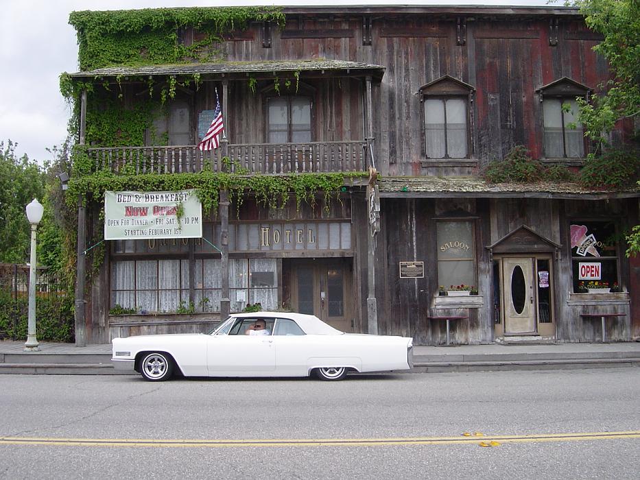

  2. You should bag a Corvair, ahem. They look sweet slammed.

    Those cars were born to sit like that. :cool:

  8. 133
    Joined: Dec 30, 2003
    Posts: 1,655
    133
    wow, that is nice. good work! did you custom build the A-Arms or where did you get them?

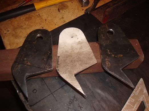

  9. southerniron
    Joined: Feb 13, 2009
    Posts: 61
    southerniron
    from so cal
    yeah i built the arms , you need a set ?

  12. 133
    Posts: 1,655
    133
    possibly yeah for my '66. would you happen to have any more build pics of how you did the front and rear? i was under the impression that these cars are real easy to bag, meaning that you can drop the bag in place of the coil and you're done but with your post, it doesn't seem that easy, haha. thanks.
  13. southerniron
    Posts: 61
    southerniron
    from so cal
    well for the rear it wasnt a drop in for me ...i didnt like the clearance it had around the bag ...when i do a job i dont want to see it come back .
    so i cut out the entire coil crossmember .and built upper and lower brackets to bolt the bag to and slapped a crossmember in there . i suck at taking progress pictures , sorry but this is what i got ...oh and the front isnt 100% necessary it was just icying on the cake ..but functions super nice and is very strong .
  14. 133
    Posts: 1,655
    133
    thanks. it looks real nice with the stance. good work. did you not cut the driveshaft tunnel? did you notch the rear at all? sorry for all the questions.
  15. southerniron
    Posts: 61
    southerniron
    from so cal
    dont worry about the questions...we all here to help each other right .
    as far as the cutting goes the owner didnt want it cut . the drive shaft hits the tunnel before it bottoms out on the frame ..it basically has a factory notch :eek:
    the owner still comments how nice the car drives ..but i credit that to the shocks ... so make sure you get the right shocks:D
