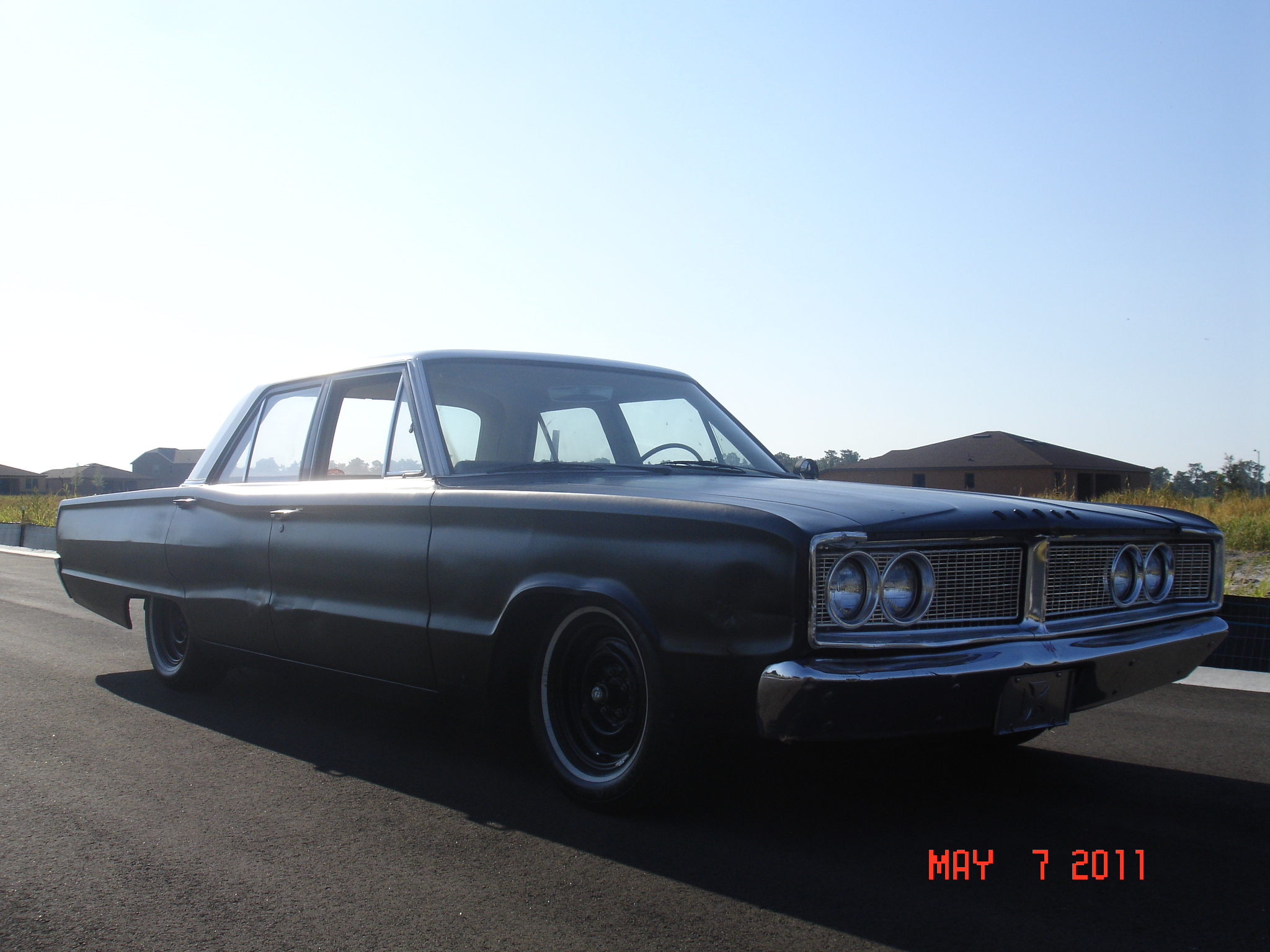

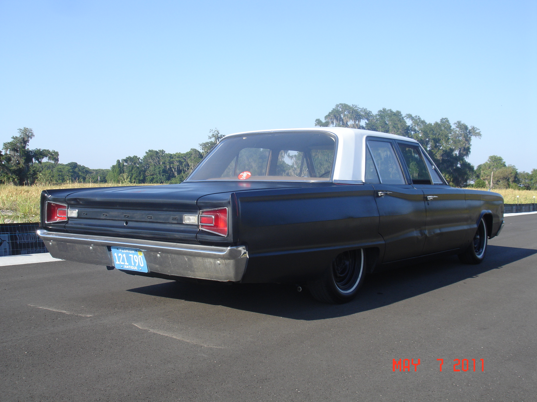

    Well finished the drop today, had to get some different U bolts and it was a a back breaker but got it done, the front was easy the back was a different story.. 4" blocks in the back and torsion bars turned down about 5 times, didnt think it was gonna look tough but I think it looks tough..anyways here it is...

  6. my first car was a 70 charger, used to raise that critter up, had l-60-15's on the rear and 70's on the front, cragars all the way around and the up level stance made the car look mean.
  7. I used 2 inch blocks in the rear, cranked down the bars in the front till it was level. Installed gas shocks, radial tires, rode excellent!-MIKE:cool:

    Easy to do it, mine had 4' blocks in back and turned torsion bars up front, cool car,was amazingly reliable, loved it..
