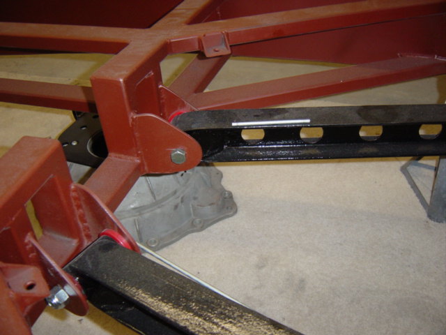

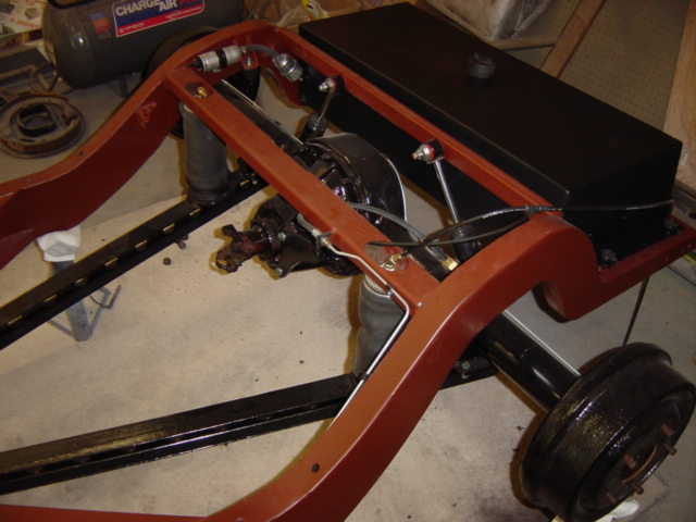

    Like others have said the truck trailing ars are a little big for small hot rods. I basically copy the same thing in I beam for small cars. I have even used the same bushings. Here's a pic of what I do for small cars. I use bags but springs or a buggy spring could be used.

    Cool Clark, so the bushings are the '67-'72 pieces? Kinda hard to tell but do you use u-bolts to attach the arms to the rearend? What size I-beam is that? Thanks for all the help guys, I think I am gonna do this...

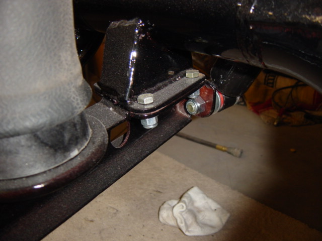

    For this car I used Jeep spring bushings. They are eurethane. I got them off of Ebay...cheap!!
    I use 2 1/2" I beam but it's hard to find. 3" works too. The axle is attached by plates with 4 grade 8 bolts.

    Clark! That is REALLY clean workmanship man!
    Just some flat plate, I beam and a good eye.
    Impressive and as durable as anything you could possibly use.
    I like the oxide primer you used too.
    What is that? Has that early look about it...

    Bill ...thanks! The red oxide is PPG DPLF. I doctored it a bit with some black.
    Flipper not sure what they weigh. Can't be much. The advantage of using I beam over tubing is the I beam allows for twist. The tubing doesn't. Plus it looks cool drilled :D
