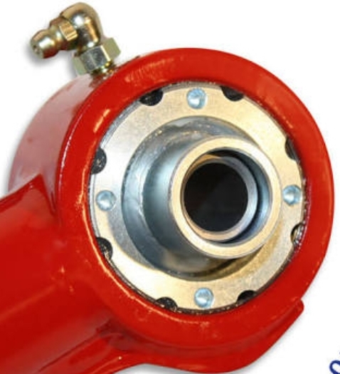

    For you engineering types out there... would you believe 28° degrees of rotational movement (as a provision to a rear trailing arm connection point) would support a general threshold (possibility) of rear axle movement. This 28° of rotational free movement would be available in all directions in tandem with full range of movement in a primary arc (up and down.

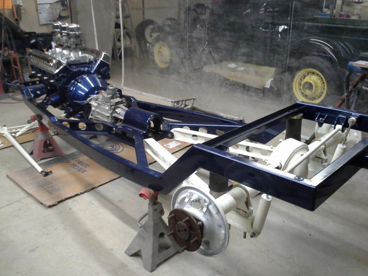

  8. Clark
    Joined: Jan 14, 2001
    Posts: 5,132
    Clark
    Great...my favorite type of rear suspension. Have done several over the years. Gonna put them under my 54 f100 next downloadfile-1.jpg

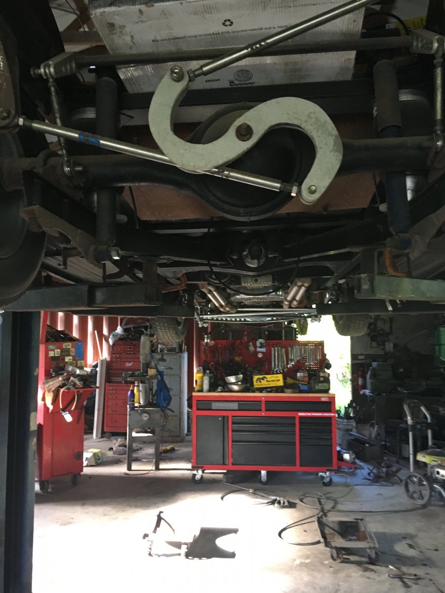

  11. Mike VV
    Joined: Sep 28, 2010
    Posts: 3,329
    Mike VV
    from SoCal
    The beam NEEDS to twist to work properly.
    Otherwise, everything is in a bind. While the suspension will work...sorta...it's not working well.
    This is my 54 Studebaker Conestoga (station wagon).
    Mike
