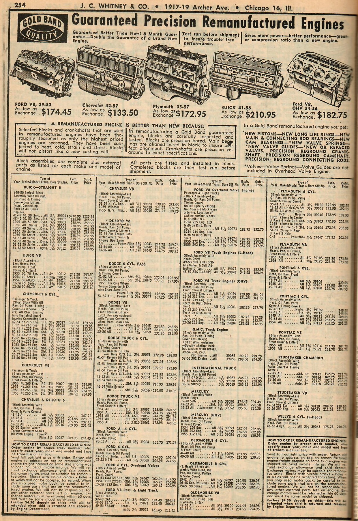

  21. squirrel
    Joined: Sep 23, 2004
    Posts: 59,927
    squirrel
    oh...it cost $175 for a remanufactured A engine in 1958. Freight was probably not included.
  22. Newest engine listed is 56
    that ford banger block was around $2100 in todays $$$$$
    41 GMC K-18 and Sharpone like this.

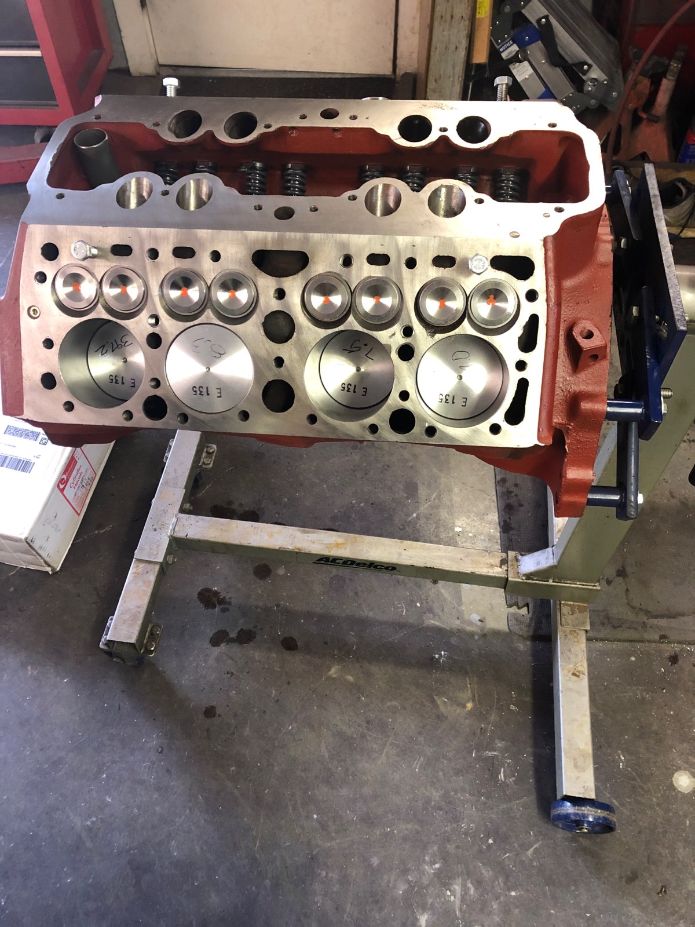

  27. winduptoy
    Joined: Feb 19, 2013
    Posts: 4,152
    winduptoy
    I've been mostly happy with my Bertz block build. It takes a lot of prep and cleaning and then even more cleaning to get all the sand out of the coolant p***ages. Then some additional prep and cleaning and even more cleaning. It also uses regular machine screw threads for oil p***age plugs....not tapered threads for interference fit as you would expect for sealing liquid under pressure. I've played hell plugging the oil galley p***age at the back of the block...the new ***embly guidance is to use a ****on head fastener with a copper washer and sealant...instead of the original approach...a hex socket set screw....
    But I also love my real Henry B engines but the machining is getting more and more difficult to source
    Deutscher and Sharpone like this.
  28. Beanscoot
    Joined: May 14, 2008
    Posts: 3,636
    Beanscoot
    Weird the plugs aren't pipe thread. What thread are they?
    As for the sand in the water jackets, that's just like factory! I guess it's better to have to clean it yourself than pay Burtz for that extra labour.
