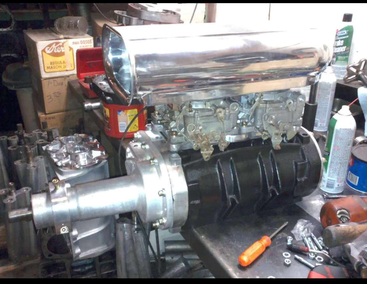

    Not my picture but it’s the same blower and dual edelbrocks

    It would help to see your intake (preferably with the blower sitting on it), to be able to figure out how to mount the lower bellcrank.

    The easy way would be to link the carb's 1:1 and use a cable.
    The cool way would be to use bellcrank's and Heim Joint's, hand fabbed bracket's, and return spring's to make a mechanical nightmare come to fruition. :D:eek::rolleyes:

    maybe / can ,if running carbs in line ,
    Make a bracket off back bearing plate low for main 2 bell leaver / ****erfly arms ,

    I don't have any photos of this setup, but I took a screenshot from the video, you should be able to do this with a cable.
