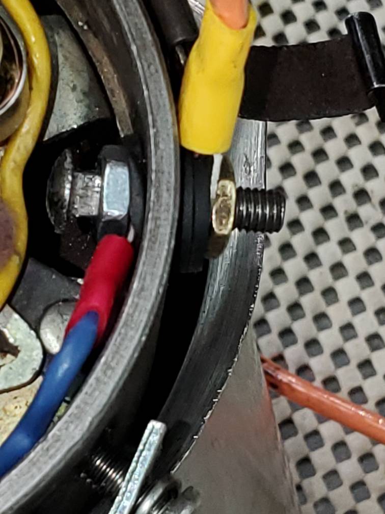

    Ok, so this is how I have the ***embly wired put tog6where the wire from the coil comes in. The wire is 10 ga. I also have one that is 14 ga. if that makes any difference

    That bolt is wrong! Looks Jerry rigged. Need to replace all that with the proper stuff.
    10 gauge wire is too large for this job, but that is not the problem.
    Do you have a multimeter! If so, check to see if you have continuity between the bolt and the housing. If so you have found your problem. Maybe someone reproduces the parts you need there?

    There's your problem! That bolt HAS to be insulated from the distributor body! It looks like the inside connector is against the distributor body. A quick and easy way to test is to make up a new wire to run from the points and out the side of the distributor to the coil. If it runs, you know you need to find a grommet that will insulate that bolt that holds the wire connections on. I ran into this on a 8N Ford tractor this summer, it would run for a while, then lose power to the points. The grommet was rotten on the bottom, allowing the bolt to shift and ground out.

    it's hard to see in the pic, but i do have a rubber grommet between the dist housing and the fork connector on each side of the housing. However, it wasn't that way before I changed it. Also, I will switch to 14 gau. wire.

    This is the new set up, connectors separated from housing with bigger grommets on both sides on a different bolt and smaller lead wire. Thanks all! 20191023_102635.jpeg

    That looks better! I hope that grey block is an insulater. But you still need to check to see if it’s shorting out to the housing, just to be sure. Those things can be tricky.
    Is that bolt shorting out on the plate when it moves? Looks close in the pic.

  11. It could be arcing from the bolt to the plate. It could also arc to the housing where it p***es thru the distributor body if it isn't insulated all the way through.

    The proper insulator for that set-up is a sleeve that insulates the bolt all the way through the housing.
