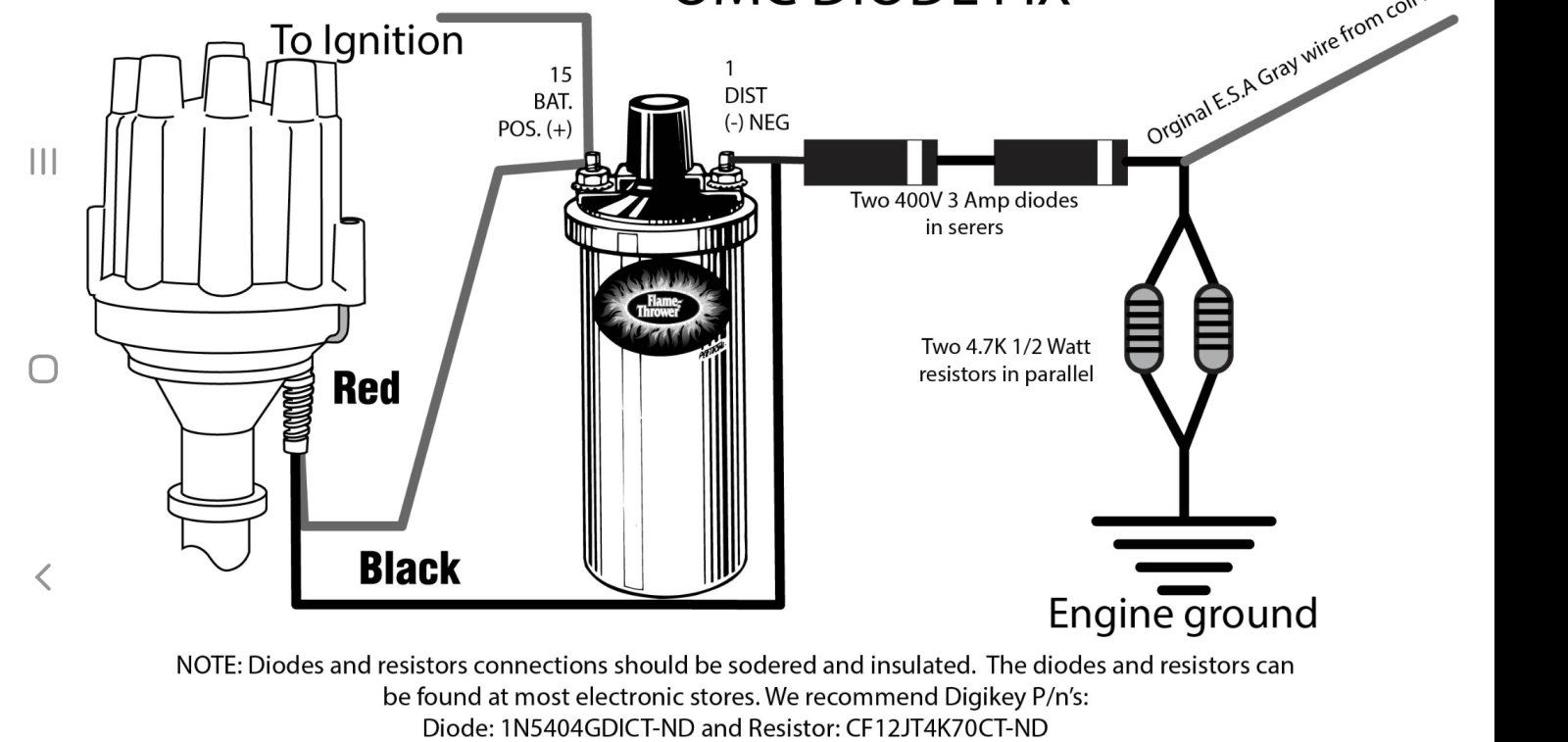

    In my research I found PERTRONIX suggesting to install DIODES and Resistors to the coil (-) side to ground out at KICKDOWN. The diagram I downloaded from PERTRONIX, is suggested for the Merc boat motors . Again in my research I read guys suggesting this too.
    I went out and bought the DIODES and Resistors PERTRONIX is suggesting to buy. Now my question is , those of you that are running this set up with the DIODES and Resistors in the system. Can you show any pictures of this part of the system.

    You have a positive ground electrical system. The screen shot shows a negative ground system. The diodes would need to be reversed (the colored bands go to the left - they now are to the right)
    I can not verify if this works. I am very cautious about the source of this diagram - The following words are misspelled: "serers" and, "sodered". Makes me wonder if the "engineering" was done in the Peoples Republic of Tinpanistan.

    I can't tell for sure if the diagram is for a positive or negative ground system; there are wires running all over the place.:eek: The important thing to know is that 6 volt Pertronix systems are fragile and very prone to failure. Plus, they are unnecessary. Over drive electrics are complicated in their own right and difficult to troubleshoot. Do yourself a favor and stick with points.

  4. And also, why not install a 2.2K or 2.4K 1 watt resistor instead of using 2 in parallel (= 2.35K).

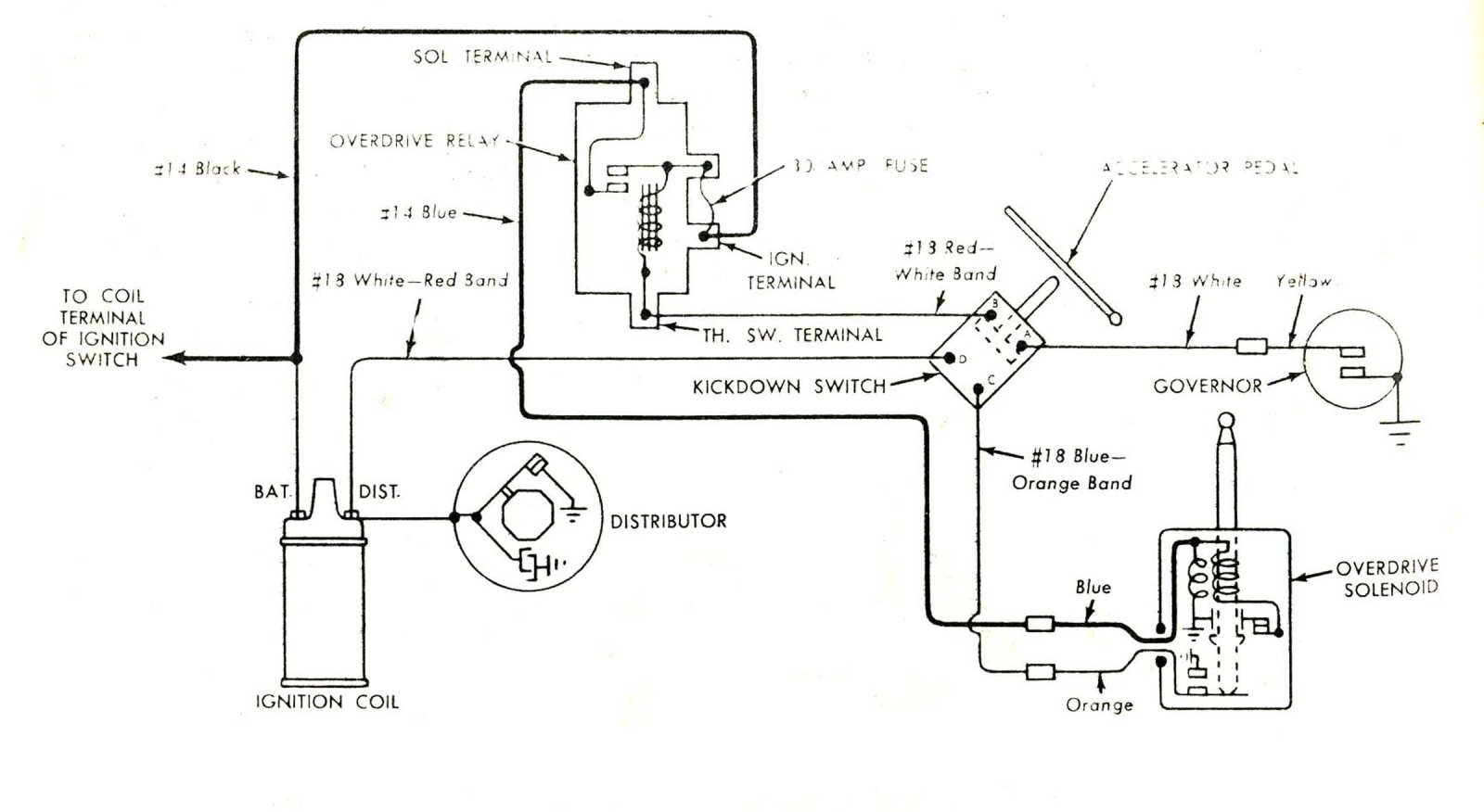

  7. Let me think this one over. I can say that a relay will not work the way you think it will. Follow the wiring on this diagram, it shows why it won't... that other diagram I need to digest...
    Remember that no spark is produced UNTIL the points open. Interrupting power to the coil is not the answer, you need to maintain power.

    Thank you guys, for your responses. As brought up, the initial diagram looked funky and didn't make sense with what my current setup is.
    I looked further into the PERTRONIX diagrams, and it turns out I downloaded the wrong one.

  13. That diagram makes more sense....
    As to the OD, you can connect it minus the kickdown wiring/switch (thereby having zero effect on the ignition), you just won't have any way to drop it out of OD if the governor contacts are closed. You will need to connect the governor to the relay.

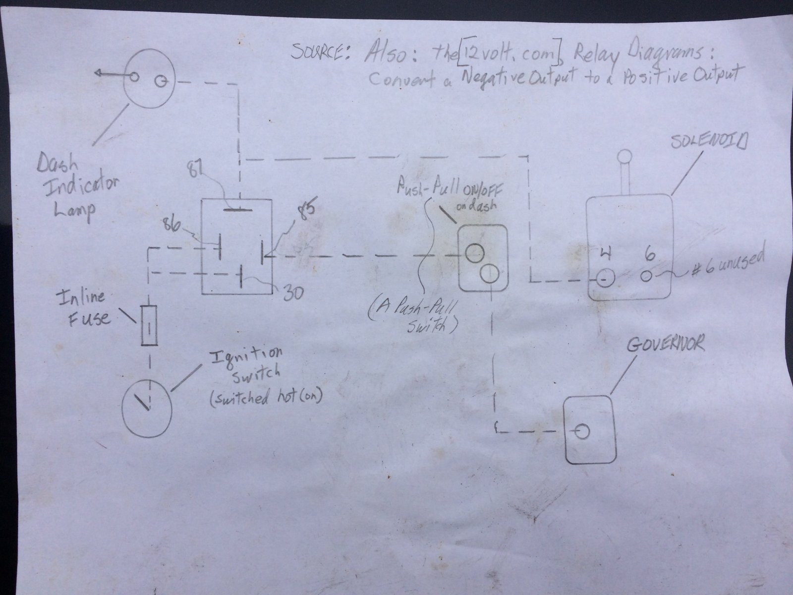

    I have a different electronic ignition, but hat's exactly what I did, for the same reason.
    Maybe this helps:

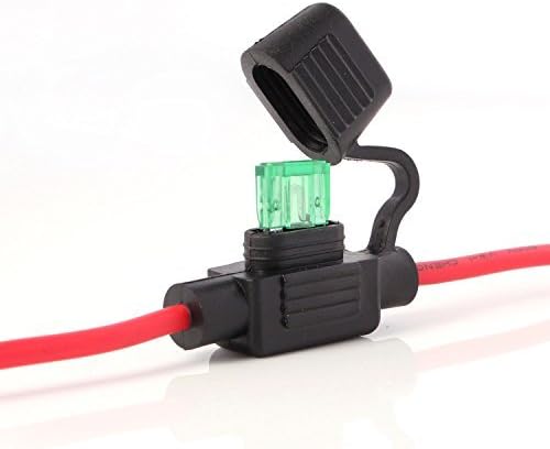

    I see the diagram says " Inine Fuse" to the Ignition switch.
    What did you use?
    Do you have a picture?
    Where is it located, Under the dashboard, firewall?

    Actually I don't have a fuse there (and yeah I know I probably should - need to look into it, what it takes). Still trying to get the spaghetti monster harness (the whole car, not just the OD) under control.
    Basically I have everything working, but now I want to make it look nice and tidy.
    But yeah, the fuse would be best under the dash. I would use something like this:
