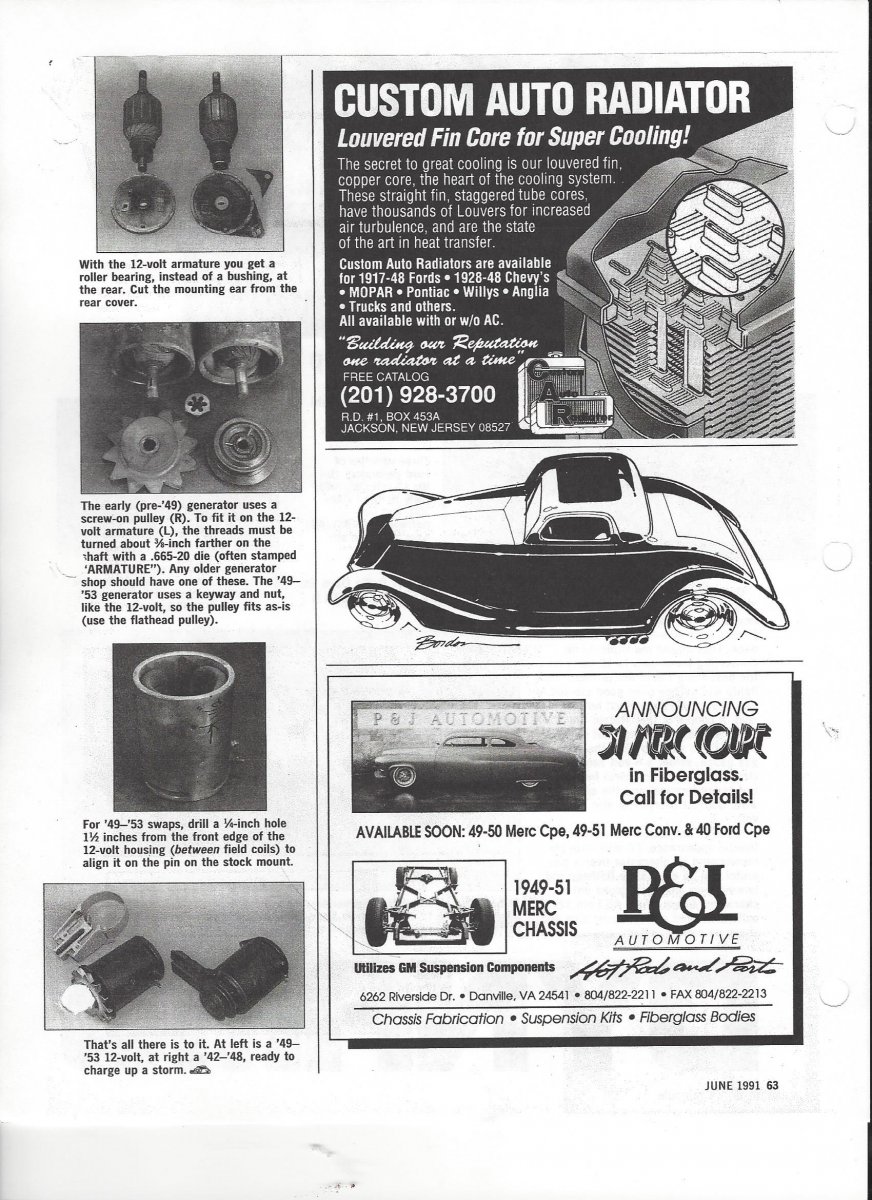

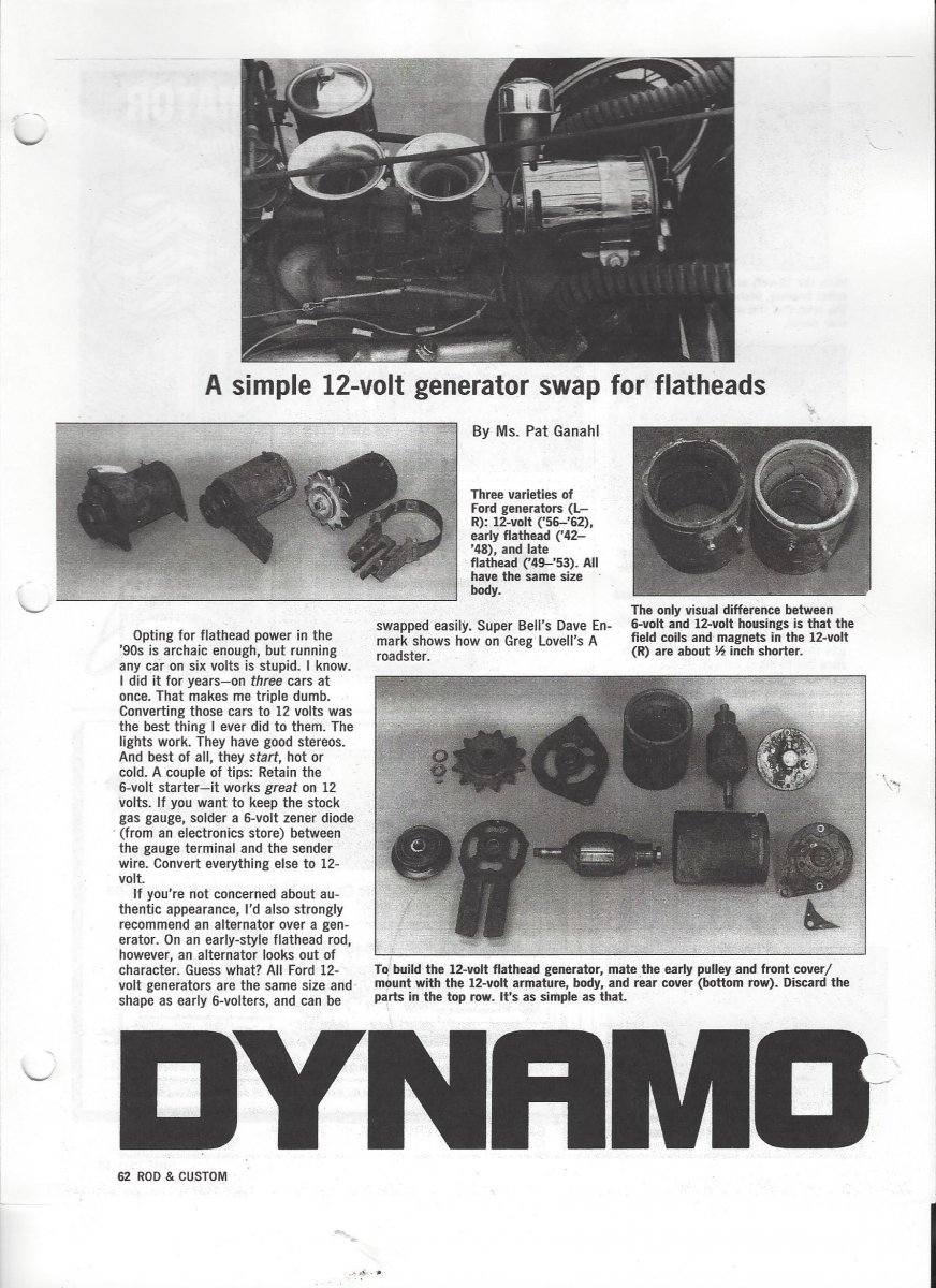

    I'm using a mid 60's Ford 12 volt generator with the mounting flanges cut off and a guide hole drilled for the pin on my 8BA flathead with the stock mount plugs.jpg . A friend ran it on his 40 ford with a 8BA until he installed an electric fan that drew too much current. Hid the regulator under the dash, I have a simple car, lights and ignition is about it.

    I just used a Ford 12 volt generator circa 1957-'58 and mounted it in the regular 6-volt bracket using the 6-volt strap. Worked out well. I've been running this set-up for years now with no complaints. If I remember correctly the fan and pulleys are from about a '49 pickup.
