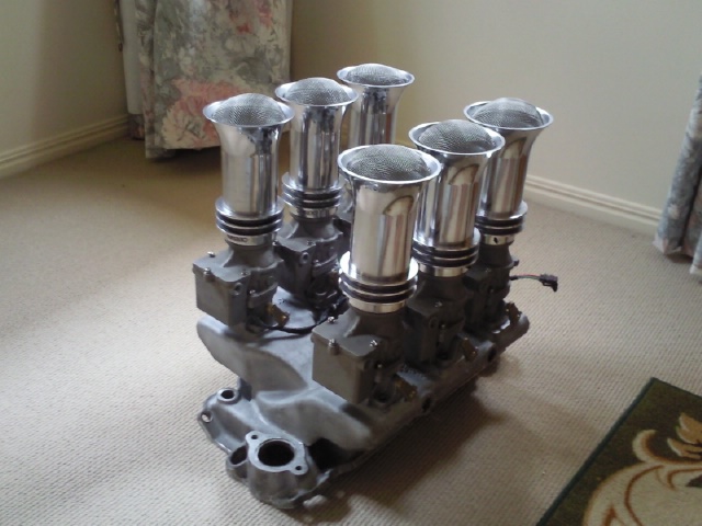

    Awesome thread, just started collecting pieces for mine and looking at others for ideas. Theirs sone good stuff on here. Gonna try and run all six straight linkage on a 327. Heres what I have so far.

    Good work on getting the thread back up.
    Those stacks are stunning, they far surp*** any that I have seen for sale. Can I ask where you got them or were they custom made?

    Thanks, I made them. I saw some close to these online from the hotrod company. I work at a machine shop so I figured I'd just make my own :)

    Ah right, fair enough. Must be handy working in a machine shop (and having the knowledge/skill to machine something like that!).
    Your stacks look much nicer than the ones for sale. You could make money selling them.
    I look forward to seeing your linkage and fuel log/block.

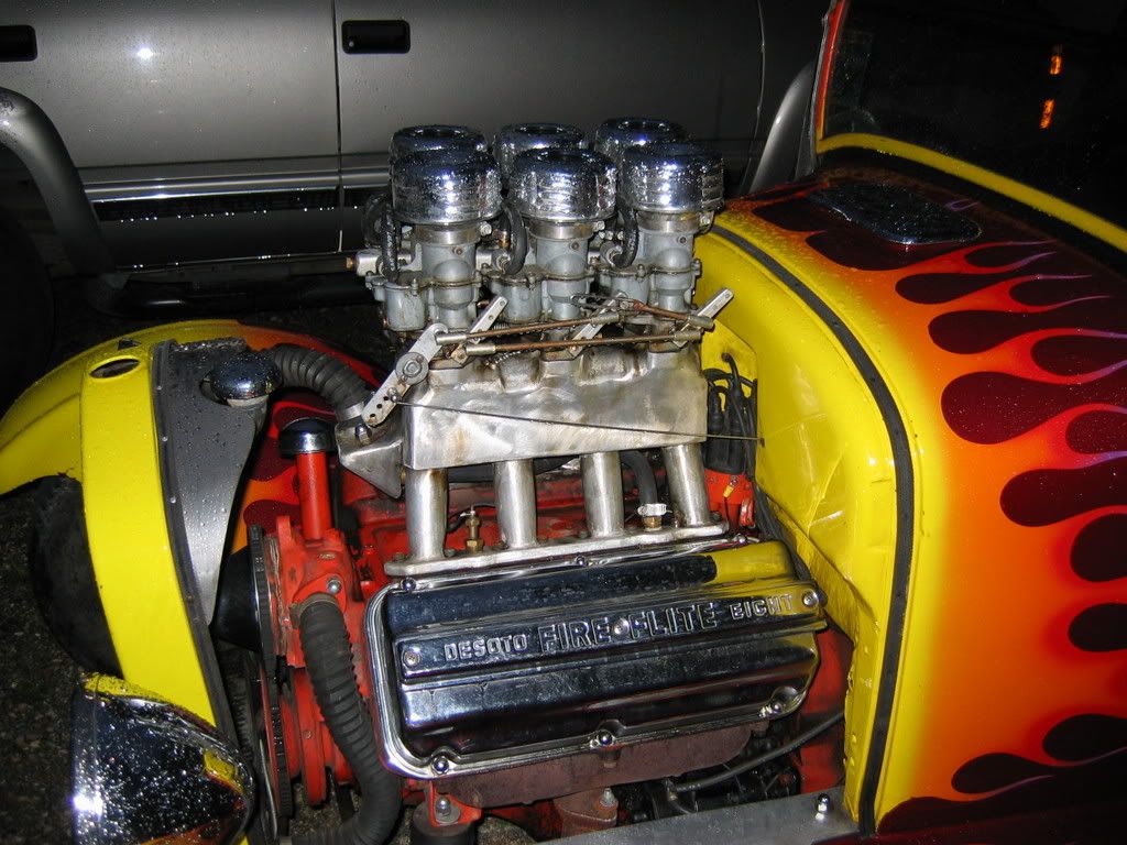

    Here is a pic of my sbc edlebrock 6x2 1ntake I cut up and welded to the top of my home made desoto intake manifold. I uused 6 holley 94s and progressive linkage on this open plenum setup. I ran it forover 10 years. It was a ****** to warm up the engine in the middle of winter but it worked quite well otherwise.
