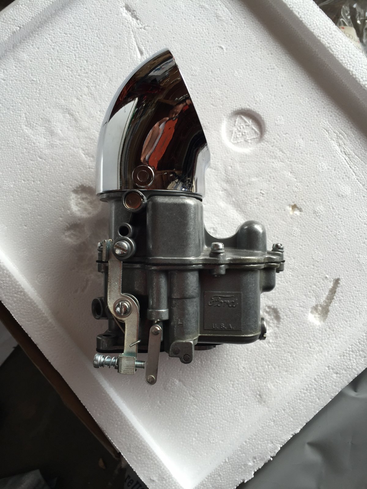

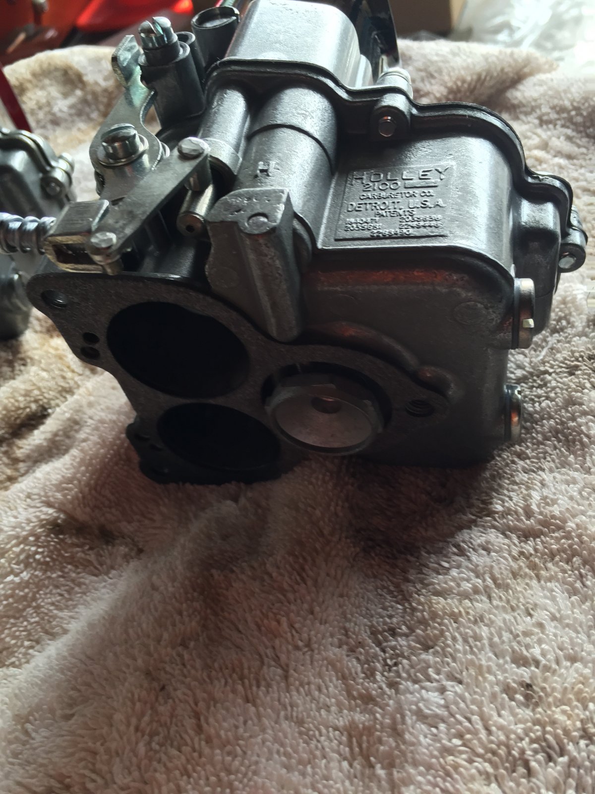

    yeah, I can rev it up in park just fine...no stumbling. Not too sure model # on 94's?....but the vacuum ports are blocked on the carbs. image.jpg
