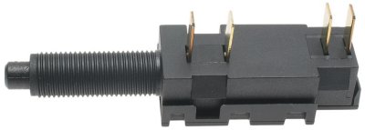

    You need a different switch.
    There are GM style brake light switches that have two sets of contacts, instead of one.
    On a conventional switch, pushing the pedal down allows the contacts to close, and the brake lights come on.
    On the double switch, that still happens, but there are a second set of contacts that open, cutting the current to the lockup circuit.
    or
    AC Delco D862C

    the dual type switches were used on GMs with cruise for many years, too...

    Perfect! Exactly what I was looking for. Thank you.
