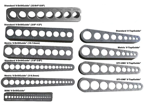

    Flat bar stock with squared off round stock with hole same Diameter of the drill bit going to be used ,
    pics below are a few for tapping if not comfortable free handing.
    The tapping is what more critical to be straight ,
