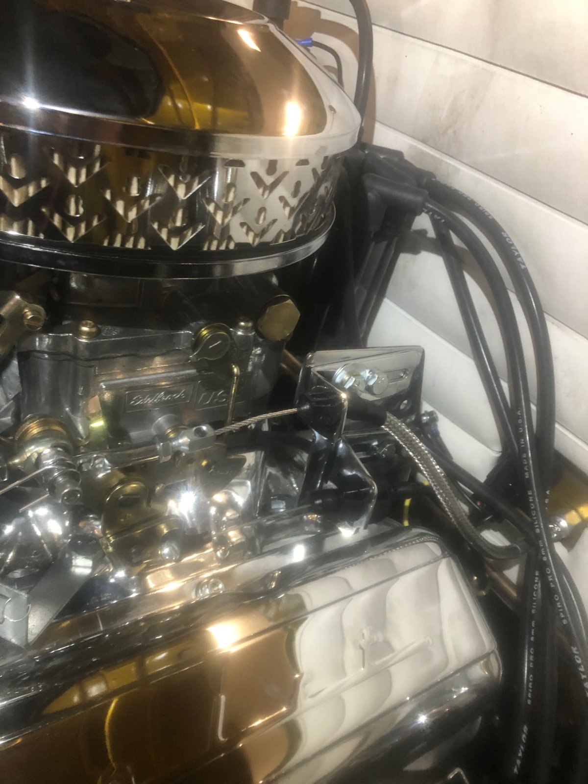

    Hi all, I've been combating an issue with a used 700r4 I have recently installed in my c10. I used the correct brackets on the Holley carb and I think I have the cable adjusted correctly. It is tight at wot. The problem is, it will not go into third gear. It shifts from first to second nice and firm at about 15 mph then that's it. Around 30 mph, the trans seems to slip. I have tried manually shifting through the gears and get the same result, just first and second. As far as the condition of the trans prior to my installing, I really can't say except that it has (I am told) 140k miles on it but supposedly was good. The fluid I drained out of it was very dark but not burnt smelling. I am just trying to get my ducks in a row before I go to the trouble of pulling it back out.

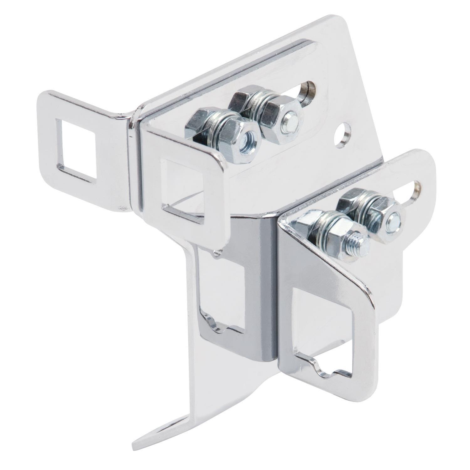

    Geometry should be correct. That part I am sure of. I used the carb throttle lever adapter and cable bracket recommended by Holley. The throttle lever packaging recommends you use the cable bracket I bought and vice versa. If I still had the packaging I would post the part numbers. I'm sure I could dig through my summit purchase history and find them though. It sounds like I have the cable too loose. I will re adjust the cable when I get home to ight so that there is no give at all at wot. The plus side is that after testing, I could not smell any burn in the transmission fluid so I am hoping I didn't destroy it.

    I have never seen a bolt on "geometry corrector lever that was correct, on older Holley non removable throttle levers.
    It has to start at a certain degree and end at a certain degree in the throttle travel.
    There are many diagrams on the net with the correct setup. Set it up as close as possible.
    Most Holley carbs I do, I take off the car, and modify the existing throttle lever for the proper geometry and not use the so called bolt on corrector.
    I use my grade school, probably 55 year old plastic protractor to measure the degrees.

  17. willys36

  18. justpassinthru
    Joined: Jul 23, 2010
    Posts: 645
    justpassinthru
    The Bowtie kit is nice and correct.
    I do think it's over engineered though.

    So I just went out and re-adjusted the cable to make it tight at idle and really tight at wot. Take off is quicker with a hard, firm shift into second, but then the same rev into slippage. I am going to go with burnt up 3-4 clutch.
