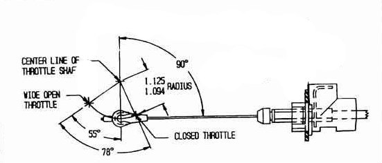

    I am currently building a semi off topic vehicle and I plan to fabricate an intermediate bell crank in the throttle mechanism that I will attach the tv cable. The bell crank will replicate the geometry of the throttle part of a carburetor set up for a 700r and using the information in the link I posted

    As long as the carbs aren’t a progressive linkage, they usually have a single shaft that operates all of them. That shaft should have a bell crank that is connected to the throttle linkage. Either modify the bell crank to attach the tv cable to or put a stand alone crank on the shaft for the cable. Look at your current cable and see how much travel it uses. Set the link up to use the same travel without putting too sharp a bend in the tv cable to.
  19. Geometry diagram found on internet.

    If you can get a throttle pedal attachment to match exactly what happens with a standard setup, you should be good.
    The diagram attached by @Algoma56 is what you need to replicate. It will take a lot of ******* around, but it is doable.
    I would be looking at doing it off the carby linkage. I think it would be easier.....
