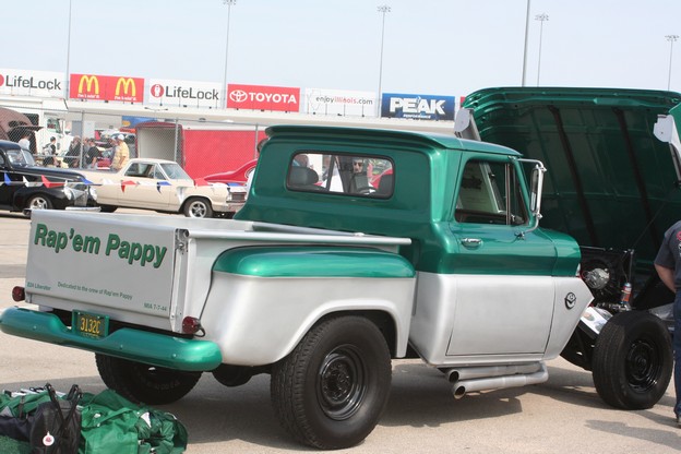

    This Jimmy was at Back to the Fifties last year. Running a 702 V12.
