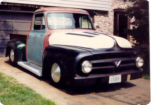

    I used a front steer camaro under my 53 F-100 and absolutely loved it! I used the variable-ratio factory Z-28 steering box [power] and the 1.25" stabilizer bar. The frame widths were very close and it took me an afternoon of welding. I boxed the weld-joint to about 3 feet behind the juncture. Be sure to position the wheel center an inch forward of the old ford axle centerline, as has already been mentioned here.
    My truck sat low, drove great and handled like a slot car. The smallblock chevy bolted in too...I was lucky enough to find a clip that had been recently rebuilt before the guy gave it to me..

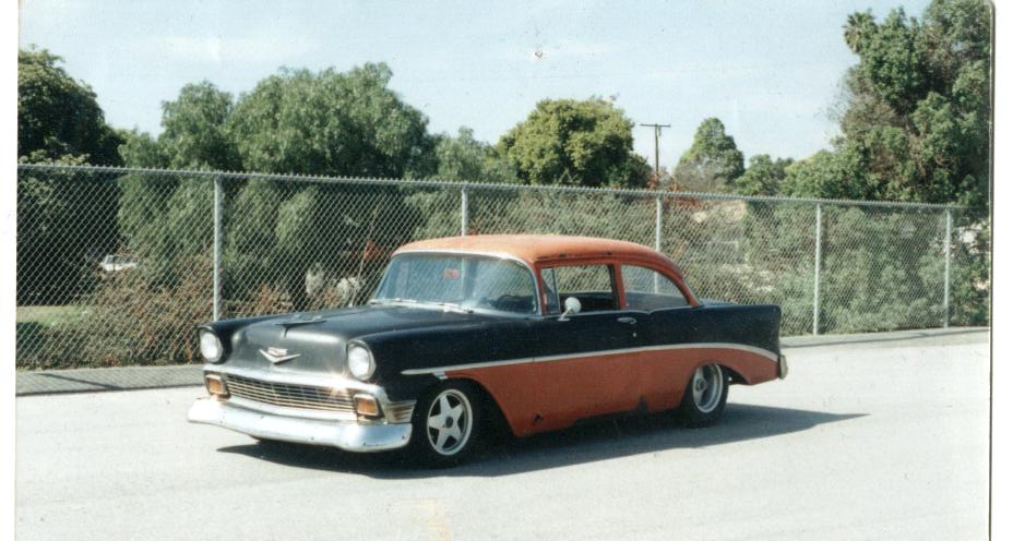

    I agree with LUX---I've got a 56 Chevy 2 door sedan with a 71 Camaro clip. A friend of mine built the car like 15--20 years ago. When I bought it, it needed a complete overhaul---engine,trans,paint--etc. But the front end is still in great shape---I've driven it for about 10,000 mile before teardown and I will tell you this: the car is THE best driving car I've ever had---I've got a 37 ford coupe with a drop axle and a 29 roadster with a drop axle---and the 56 is like driving a Cadilac compared to my other stuff. Great disc brakes--1 finger power steering (with NO oversteer at high speed--like MII)---and the car is LOW---being that the clip was put in "high"--lowering the car about 6--8 inchs. The car drives *****en and looks great--parts are as close as the corner parts store.I am a BIG fan of sub-frames---just do your homework and do good work.
