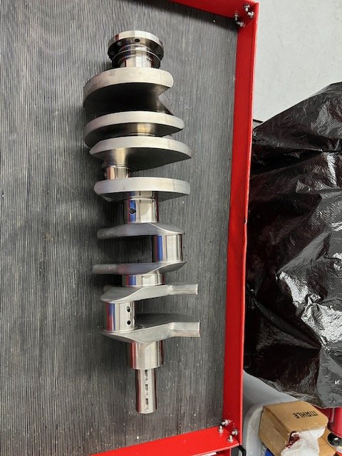

    I'm having a hard time believing this since the flat head motor only has 3 mains.... Somethings bound to snap....

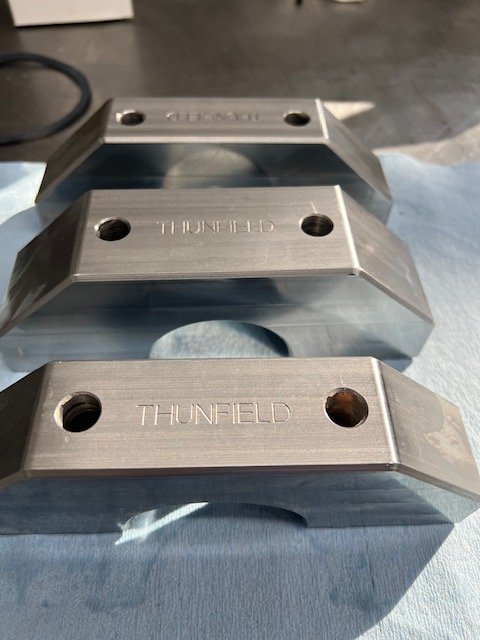

  8. You never heard of Ron Mains record holding flathead powered streamliner? Over 300 mph in 2003, I believe that record still stands. Trust me that's not a stock main girdle in that rotating ***emble!

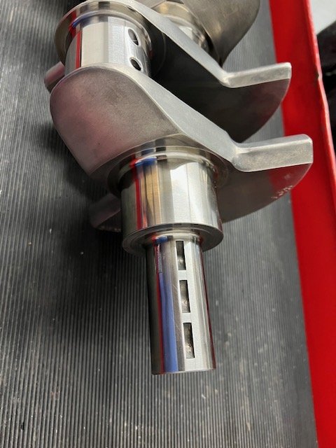

    Have you ever picked up a Flathead crank? They weigh a few pounds more than a 428FE crank i.e they are quite stout. Flathead mains are nearly twice as wide as a standard 5 main V8 engine and as such are less prone to cap walk, and even better with a well engineered girdle. The 3 main concern is always voiced, but like most urban legends, it is highly overrated. There have been plenty of 500, 750, or even 1000+ Hp (Rick Schnell's "Slider") flatheads built and run with 3 mains. Would that be my first choice for a 24 Hrs of Leman's motor, probably not, but in 1/4 mile or even Salt Flat duty, they seem to do just fine.
    Ask someone who owned a 6.5 GM diesel about broken crankshafts. 5 - 4 bolt mains and a whopping 180 Hp lead to all sorts of problems for GM. Sometimes, there are other factors that come into play....

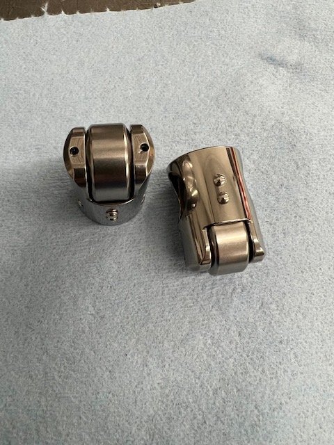

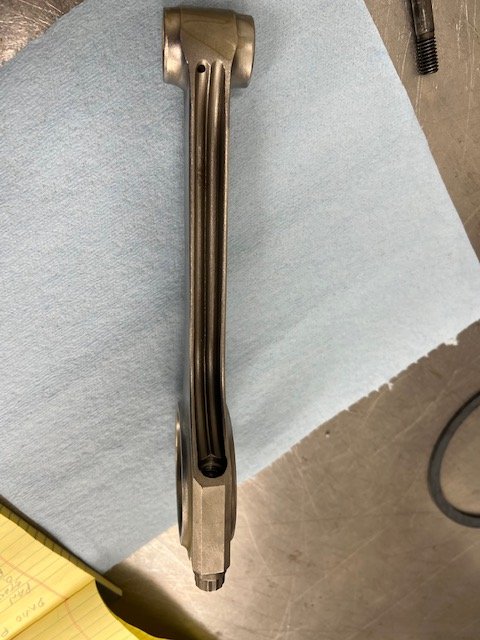

  10. Racing flatheads today are far from what most would consider to be even remotely traditional.
