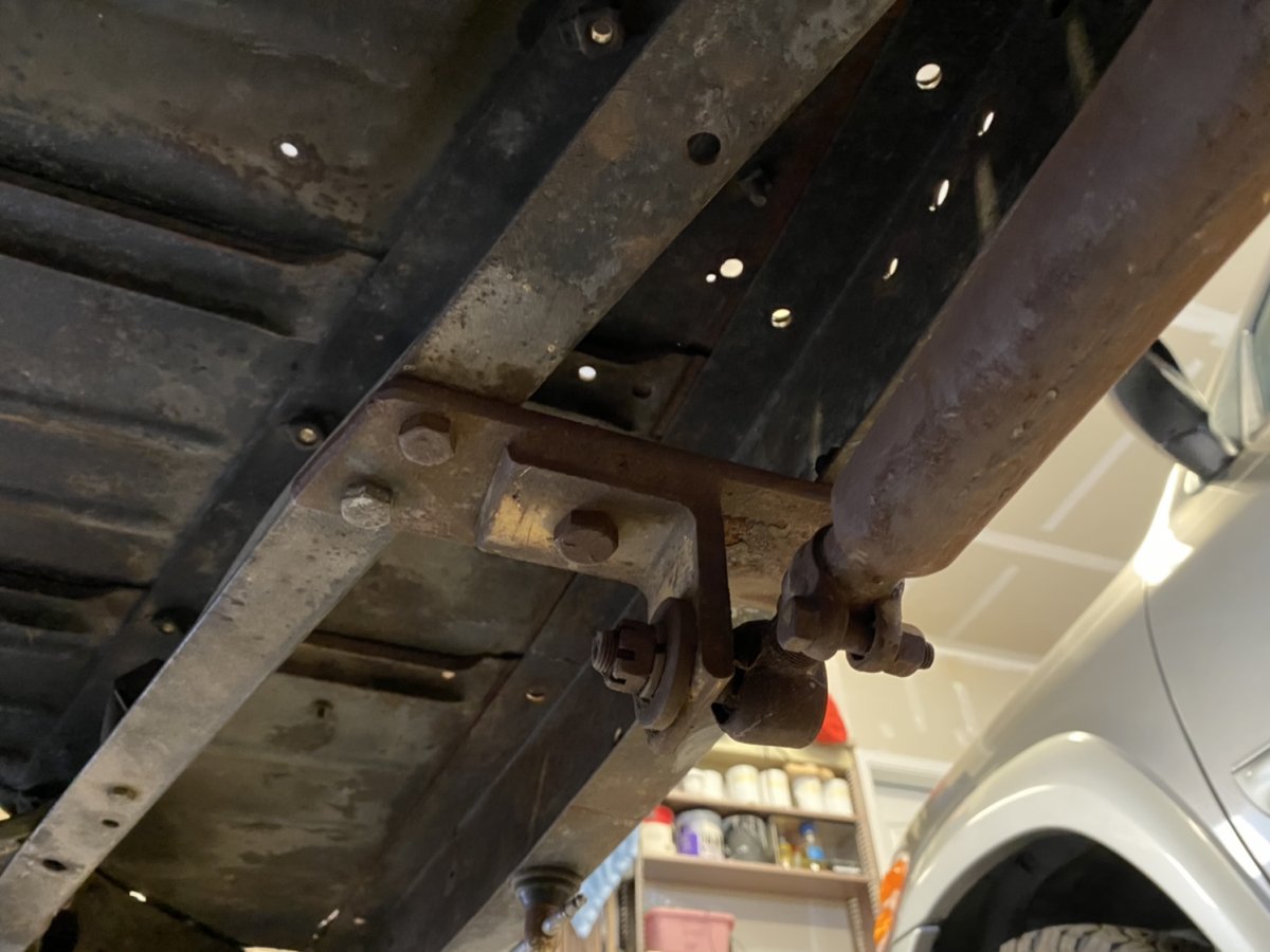

    The plan is, to pull the axles and the third member, inspect, degrease it, and clean everything, replace the oil seals put it back together put new brake shoes hardware, clean it up and paint it! As far as the parallel bars, I’m going to put a big triangular 1/8 inch gusset along the bottom of the crossmember and the outer rail to spread the load, where the front mounts, and Call it good! I really don’t feel like cutting all that nice bracketry for the buggy set up
    Its already there.
    31Vicky with a hemi likes this.
  5. There’s quite a controversy on the removal of the torque tube and running single lower bars like you have there. Some guys say there’s nothing to worry about and some guys have broken them causing damage some heavy.
    I’d suggest you do some research on that one so you feel good about it. I would not do it because I’ve seen them break.
    The next issue I’d look at and research is how parallel bars on the axle act as body roll limiting device. Aka anti roll bar or anti sway bar. For sure that phenomenon breaks***** apart. But do your own research so you feel comfortable about that.
    Now If you look at those two issues combined, after some research I’m more than reasonably certain you’ll see that is all a really bad idea.
    Since you already know the rear end is too wide for the WT look you want, and you research those above issues with the bars that are certainly questionable at best,,, you’ll see taking care of everything on the rear axle is really the best choice.
