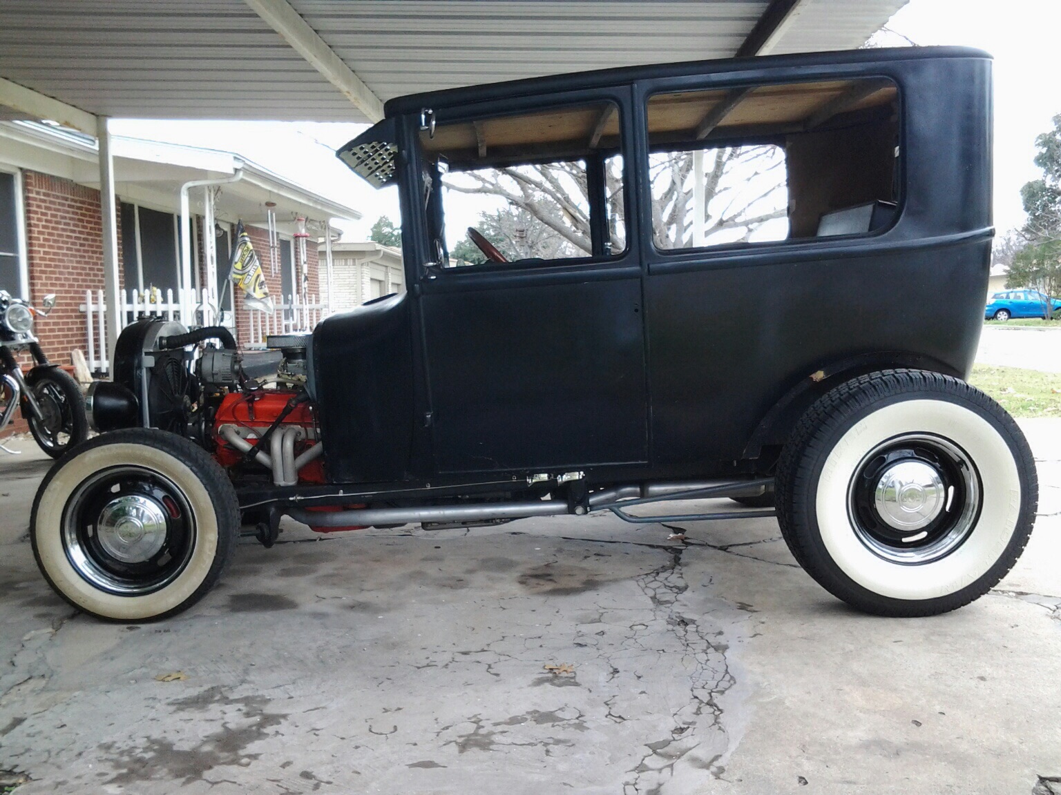

    image.jpg image.jpg Hello, I'm new to this Hot Rod thing, and I just bought me a 27 T sedan. I've got a bunch of stuff I'd like to do to it starting with wheels and tires. I'm about to pull the trigger on some new shoes and I'm thinkin on bias ply of course. I'd like to do some 15x10 in the rear with some 8.20's, but I'm not sure if I can squeeze 10" in in the tires. The sedan is mine and the coupe is the look I'm goin for, but I can figure if those are 8" or 10". Any advice would be helpful. Thanks

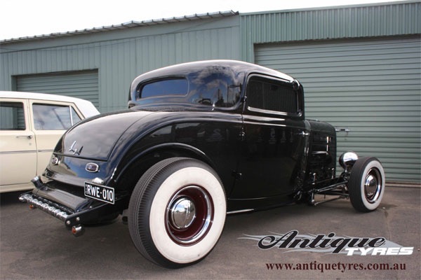

    It's your deal but personally I don't think I'd try 8.20's on a 10" wide wheel. Even if they mounted on ok, the wheel would stick out more so than the side wall and might look too "low rider". Don't want that. The style tire on the deuce above has a fairly narrow tread width and you usually want a wheel width that matches. I'd do the 10" rim for a cheater like mine or any other 10" tread width tire.

    But nah, I've seen 8.20's stretched over 10" wheels back in the day and they look stupid! A much better look is with 6" wheels which allow the sidewalls to balloon out past the rims and then look comfortable with the fairly narrow tread width, which needs to be about the same as the rim width to look right.

    I love the cheaters but boy there $$$$ spendy. Cheaters will the second round of tires for her. Those wheels on the coupe must be 8" then, huh? I really like what he has goin on!!! Comin from a "lowrider" background I don't mind a little stretch... I'm thinkin a 6" for the front like this and for the rears just like the coupe.... Bad ass 40!!!

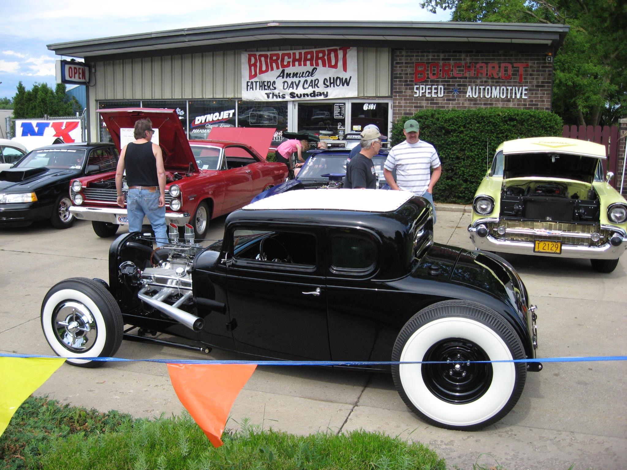

    image.jpg image.jpg image.jpg So a 10" wheel would probably ballon out much more than this, huh??? I like the way this looks!!! I just Towel City for the cheater slicks $265 not bad!!

    Now comes the subjective part ... Because Everyone has an opinion right? mine is that Stretched tires just don't look right and especially on a hot rod. That black coupes rear tires are really pushing it and if it were mine I'd be changing them.
    31-10.50 cheater slicks fit really nice on a 8" rim and they are 10" wide.
    285/75/15 silvertowns look good on a 10" rim and they are 13" wide

    Yea, I checked that out also. So I'm figuring by the look of how much the tire is stretched maybe 8" I think the 10" is way out of the question!!! Porknbeaner explained section width with a great example. Summi Racing shows a section width of 8.35. So now if I want a 10" wheel it'll be cheaters, but boy I love that 4" www on the Firestone !! Couple more examples of what I'm shooting for...
