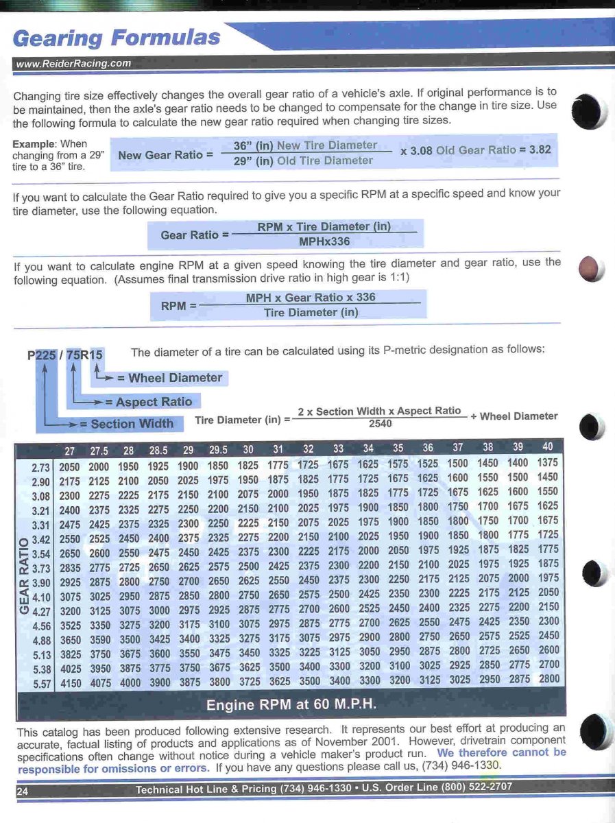

    Here is a chart. If you think you want to drive on an expressway and enjoy your engine turning 3000 rpms, pick the ratio that does that. Just remember that x way speeds ain't 55 anymore.
    If you want to enjoy driving with your engine turning 1800/2000 rpms at 70/80 mph..........then pick the gear that does that. Its that simple. One point......I have never heard anyone complain about their engine quietly turning 1800 rpms for an hours long drive.
    Note: This chart is for only 60 mph so err on the side of a lower numerical ratio if you plan to drive faster on the xway.

    Your chart does not take into acccount that the AOD trans has a .67 overdrive ratio. The chart ***umes transmission is 1:1 final drive.
    51504bat likes this.

    Yes, you are correct but it should be pretty simple for someone to calculate the difference when they know their overdrive ratio. I haven't seen any charts that actually have overdrive calculations because all the manufacturers use different od ratios. Heck, some of em even have 2 overdrive ratios in the manual trannies. I've even got an OT 6 speed automatic sitting in my garage. So about all anyone can do is start with a chart like this and them calculate from there.:D
