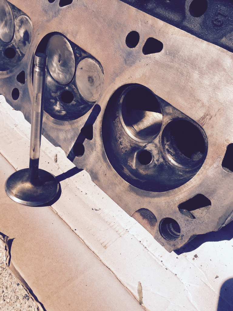

    I sold the big aluminum cylinder heads for my 342ci Windsor motor to afford engines and a trans for my other car. In the mean time until I can scrounge up a bigger and better replacement set, I made some trades with my brother and scored his set of cast iron ported Anderson Ford Motorsport GT40 heads with stainless 1.90 + 1.60 Ferrea valves and Comp cams springs and retainers. These need to be cleaned up.
    Also in the deal I got a Anderson hydraulic roller cam and aluminum roller rockers to complete the package. The cam shaft is much smaller than the one for my real motor(.544" lift for the hydraulic vs. .637" for the solid for mine) but I'm trying to sell it for it is intended for a supercharger or nitrous setup. I just want something comparable in size for normally aspirated. I'm kicking myself cause I just sold two good possibilities recently.
    I have all the stuff to the throw together a whole temporary smaller 306ci motor with KB 11.3 to 1 Pistons, good rods and other bits. This hold me over combo will unfortunately make at least 140 or so horsepower less than my intended motor. The temp. engine will still retain the "60s roundyround" theme. I don't know about color though. I am putting this together with a Mustang oil pan that I have laying around so if this motor runs good some one will want to buy it for there mustang(without the intake and carbs of course) since there's millions of them rolling around. Then I can finish my good motor and do wheelies at the HAMB Drags!
