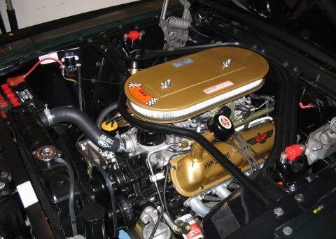

    Ok when I get back on this truck I'm going to make the engine look kinda like this
    With the crossram intake I want to make a air cleaner that simulates this one but is turned sideways. I have the 289 stickers I could put on each curved end. Getting a set of these style valve covers. I will cut there tops off and add them to another set to get the height to clear my valve train. Then weld on some taller tubing for the breathers, paint gold and add H M decals. Here's my cam card

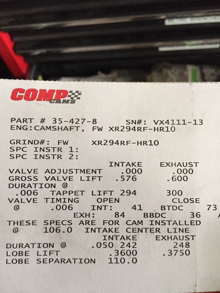

    I plan to run 1.8 rockers so you do the math. The card calculated to 1.6 ratio.

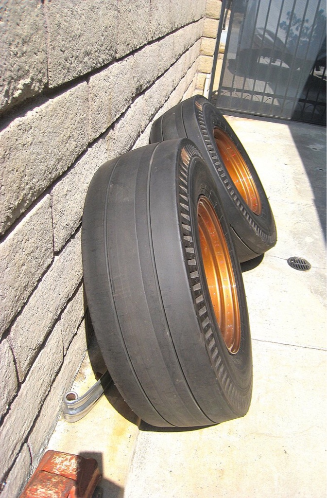

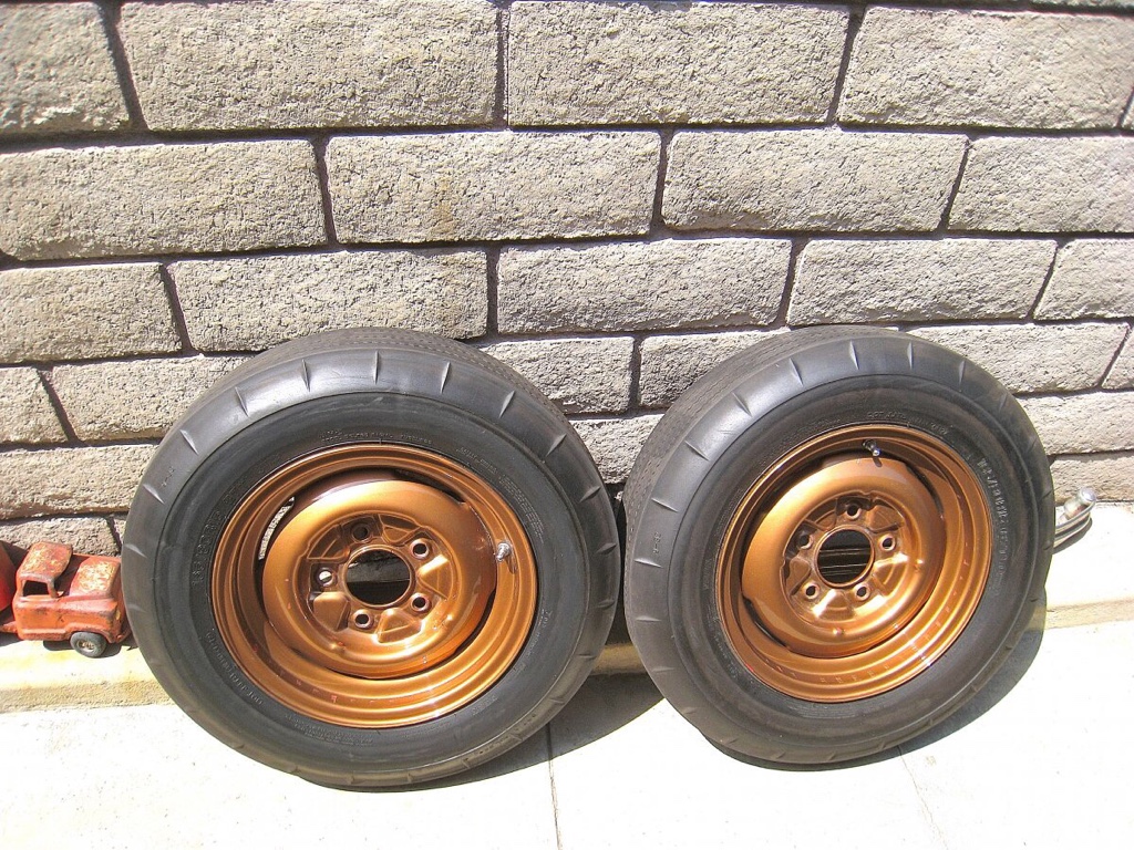

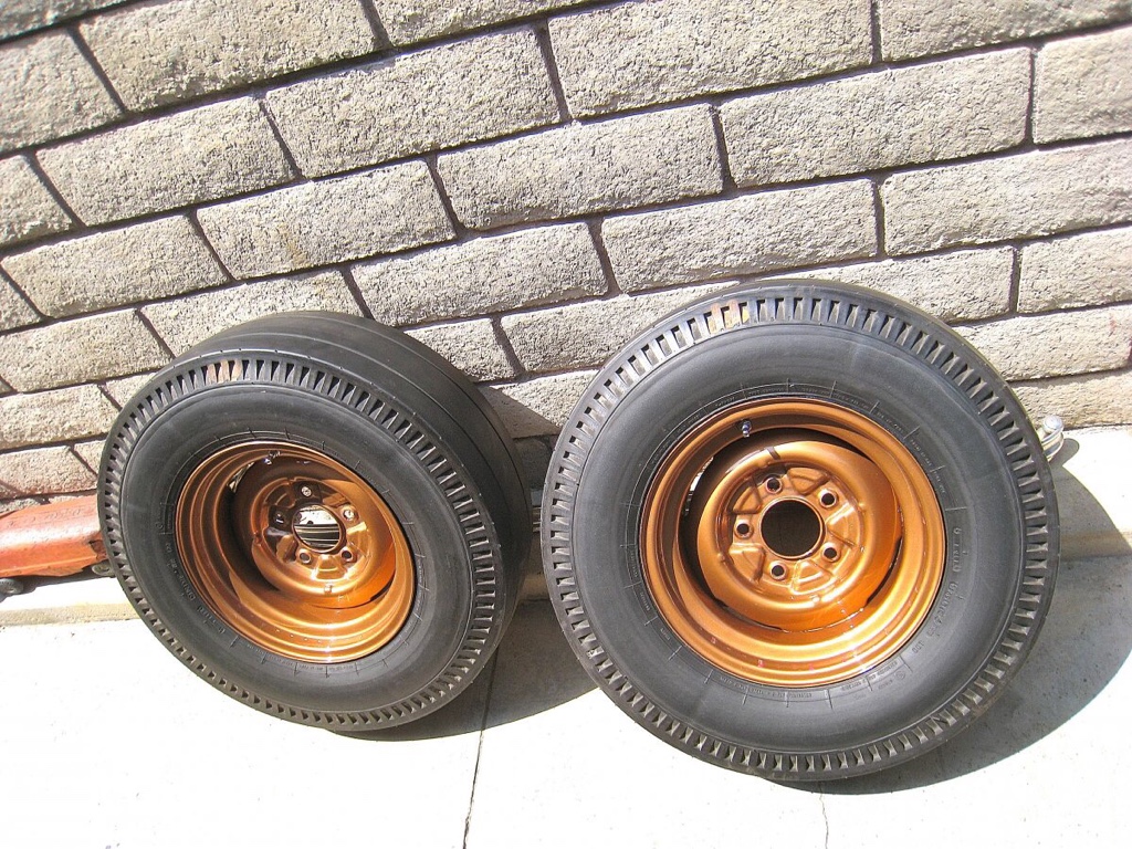

    Matt mostly I'll be running the wheels and tires that I put together for it already in this thread. They represent the bootlegger mountain truck vibe best. But I did recently get the 15 Lincoln steelies from Tony Martino to run a 60s period slick yes. I have always got off more on a vehicle walking a bigger stick than it looks, never the other way around. When I take it to a drag strip and don't care to much about its traditional image I will run a modern slick that can handle the nitrous hit. You won't see the truck on the street with a power adder though. I'm also installing a removable ant-roll bar out back(not period) and a chromoly main hoop inside the back of the cab. There's been some talk about a removable front section so I don't get my self killed.
    I anticipate the PU being about a 800# lighter than my last mustang so if I can get the truck to hook at all with maybe another 100hp than my previous drag packages its game on!
    Please don't tell my wife any of this. She believes I left all that dangerous stuff behind when I switched over to this old junk[emoji6]

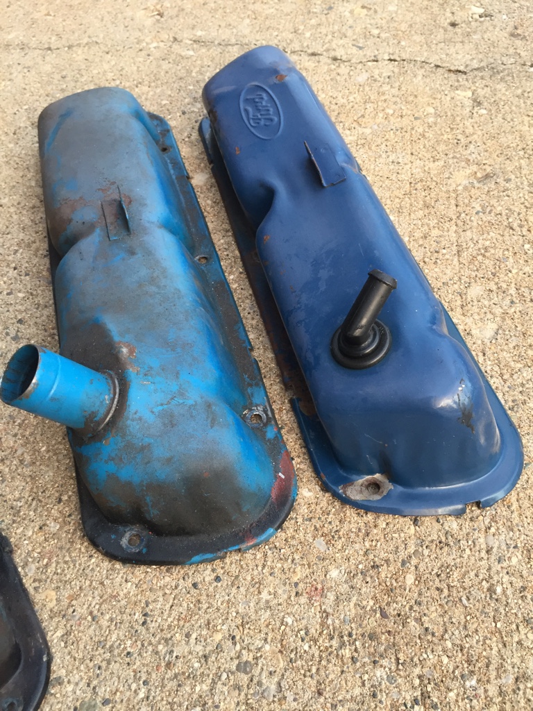

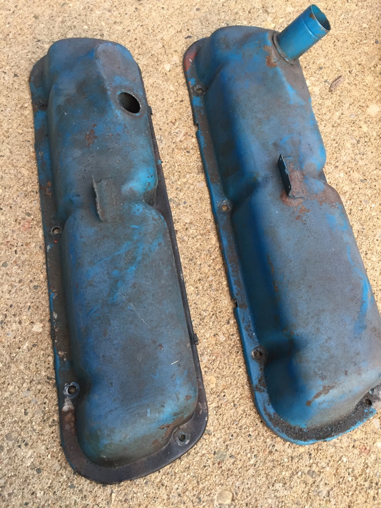

    I'm going to take the tops off these early valve covers and apply them to another set I have to get the minimum amount of height required to clear my rockers and stud girdles.
    The rear hole on the p***enger side cover gets filled. Then the front gets a long tall filler tube with 3 angled gussets. The driver side gets a extension tube welded to the existing piece and the same 3 gussets. I will have to wait till I have the cross ram intake to position these mods correctly.
    I have these 2 correct era nos breathers that need the decals that go on top. The spouts will run a hose to the evac valves on my headers.

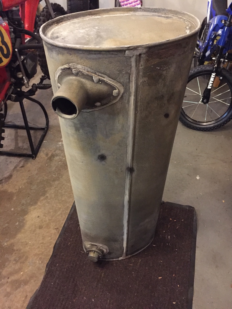

    The other great shocker is the 1930 Plymouth tank that was original to my now extensively modded frame. It was of course heavily protected by the rear crossmember type piece that covered the whole top of the tank. But I never thought it would look so good.
    It has a few dents in the bottom I have to fix that are actually my fault from back when I didn't really think about saving for the build. I also saved the stock lower straps that held her in. I will make new mounting positions for these since they originally attached to that crossmember part that I discarded, it weighed a little to much for this X racer.

    That tank is pretty cool.

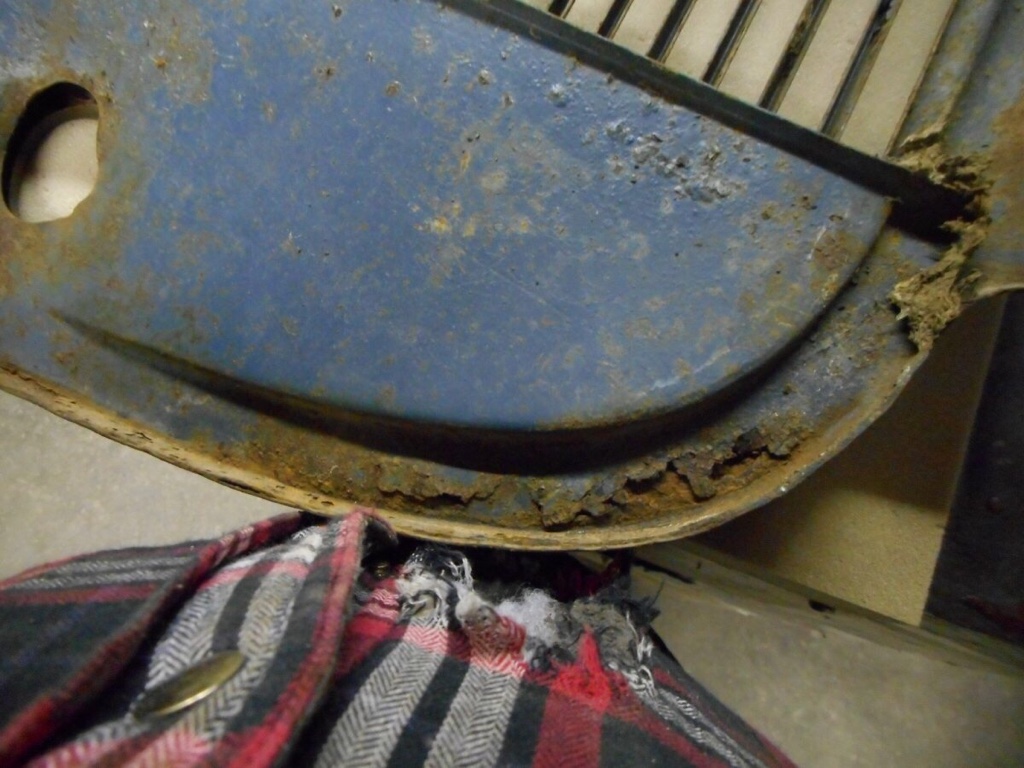

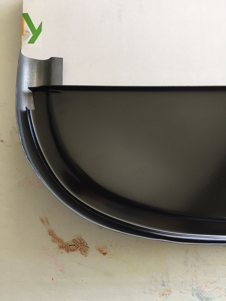

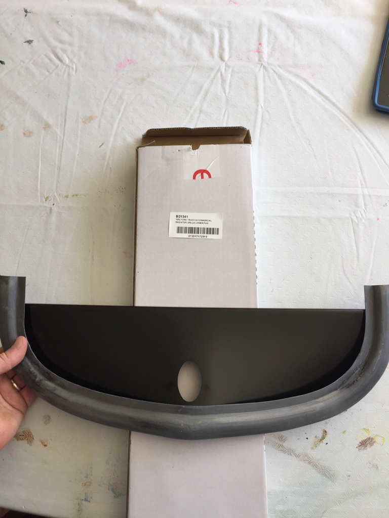

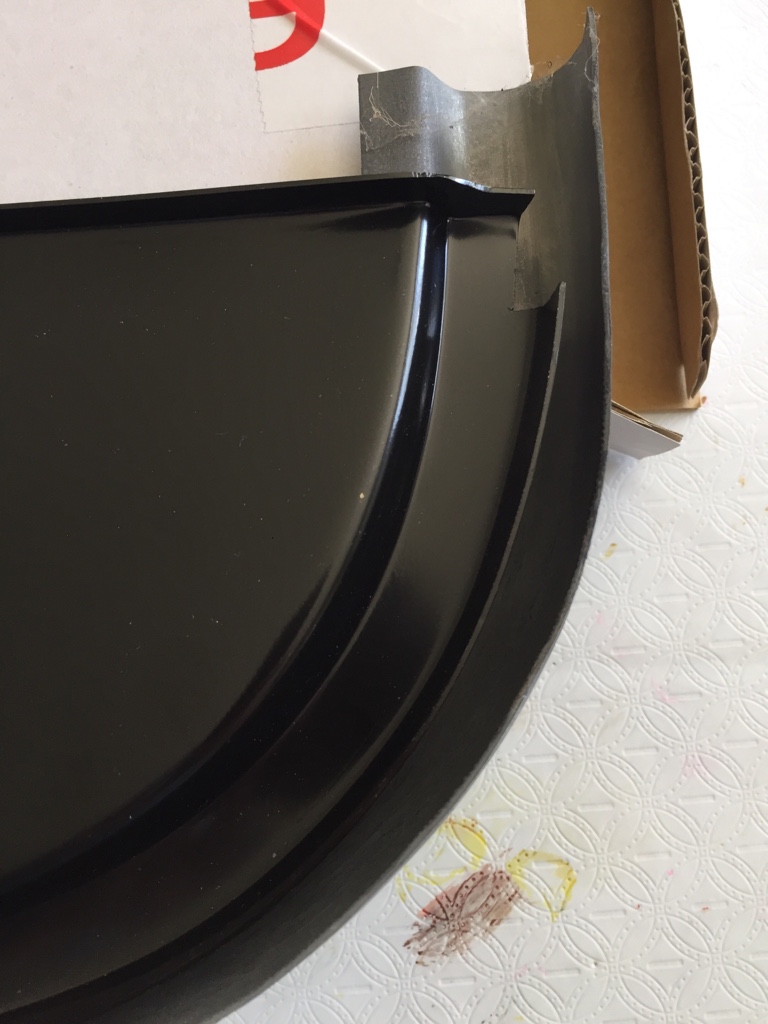

    Maybe someone can help me with this one.
    I finally got a 32 commercial lower inside replacement panel for my grill shell. I had previously purchased a replacement outside lower lip for a 33/34 cause it was is all that's available. Now I'm not expecting it to fit but hoped it might be a workable starting point. I don't know what either years factory contours are supposed to be. My question is if these gaps below are to be expected with the two different models or is this more likely a substantial slop factor between makers?
    I would not be surprised if the 33/34 grill is fatter in this "gap" area compared to a 32. Ive always thought they look quite "husky" or "just big boned"[emoji848]

    My mangled 33 grill fits together about like that!
    The lip looks like it needs to be rolled around more to fit the inner panel. My mint 34 grill has the two edges line up almost but not perfectly

    Matt I think I'll take a better look at my re-pop shell on the Tudor and see if it could be sacrificed to make a better fit for the commercial. Then just get an original again for Hubba Hubba since I'm still unhappy with the fit of the replacement. Better hurry before they all cost over $2k. Thanks for your info it's always a big help, well when your not dogging on the undeniable superiority of the Ford flathead[emoji23]

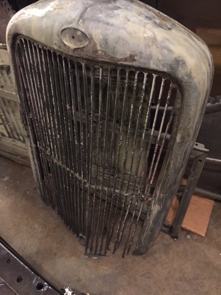

    Here's a shot of a 32 that was listed in the cl***ifieds a while back

    I don't know, it looks like if you trim a little out of the middle of the straight on each side of the 33/34 lower you could get it to tuck in properly. The Radius in the corners look pretty close just too far away. Just from your pics I'm thinking an inch would be too much and 1/2" total might not be enough... but that's a guess without it in front of me.

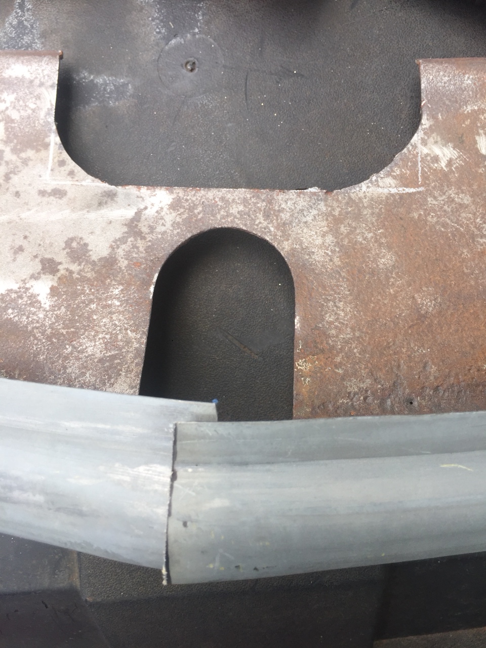

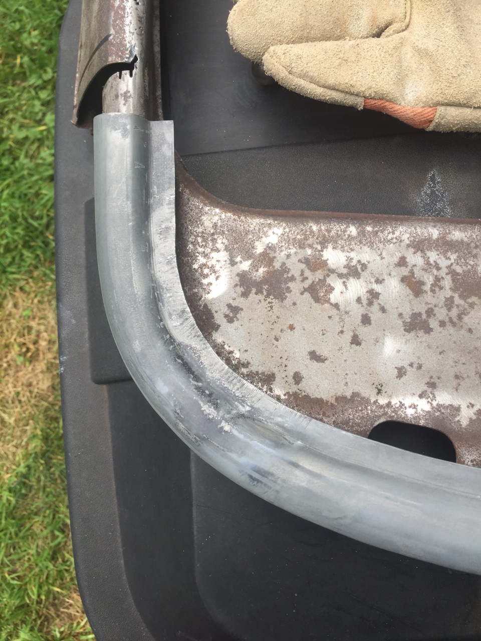

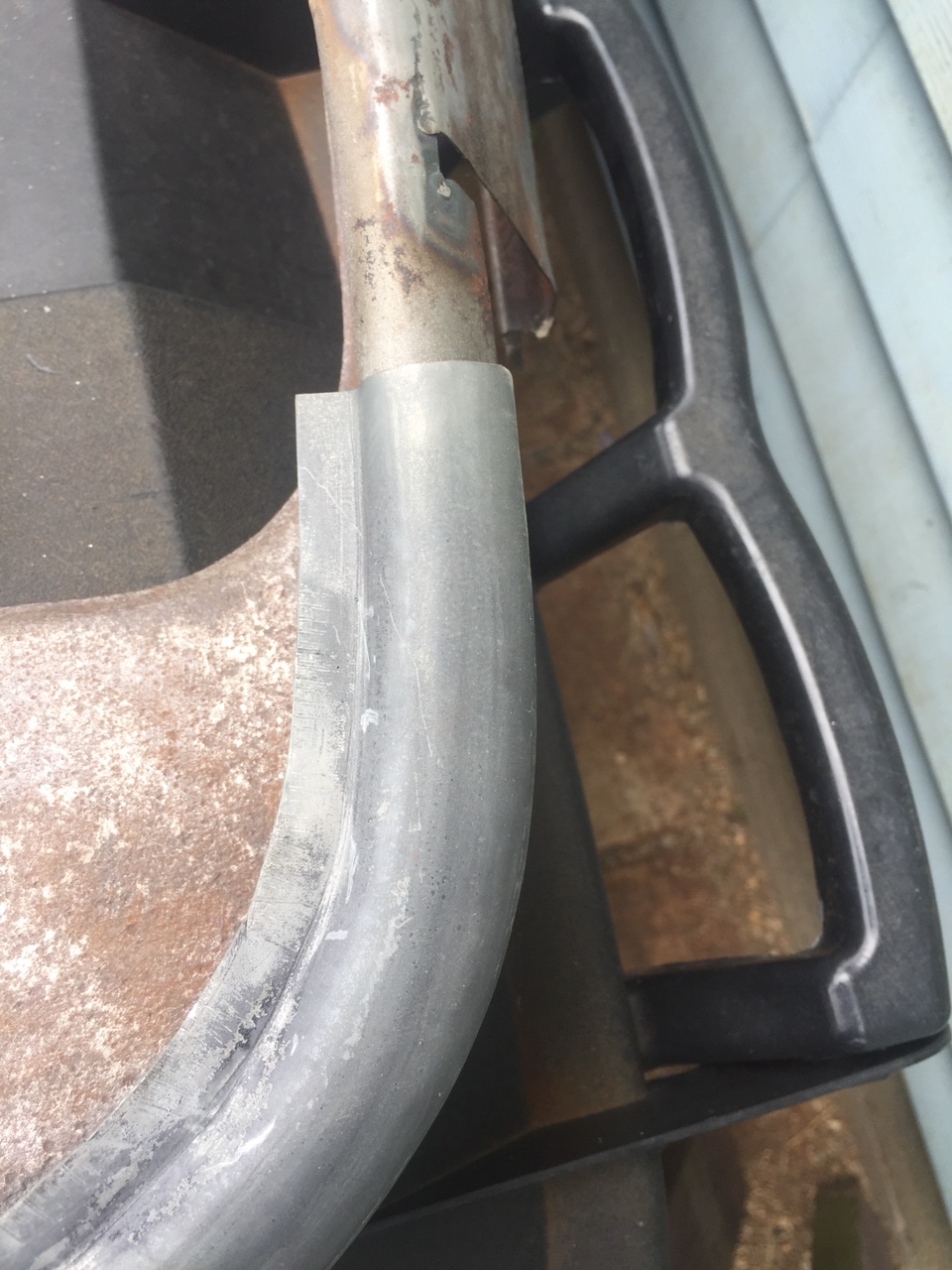

    Well after eleven months of getting the final parts to repair the commercial grill shell, I finally am fixing it. I have been thinking about the truck a lot this whole time I’ve put it on pause to build my Tudor. I shouldn’t be waisting time or money on it. But after going to the Meltdown Drags two years in a row I had to do something to it. I’ve been inspired a bunch by watching the “Goldchainer” 32 5w of @daddy_o’s_diner. I’d love to race against him. It will mostly be 2 to 3 years though before I can get RunninShine rollin.
    So I started by checking the aftermarket replacement lower patch I got for 33/34 grills up against my OG p***enger shell. This told me a lot.
    The patch is close but too wide and the side radius is too tight. So a little shrinker stretcher work and a cut and trim to the middle. Now it’s much better.
    I stared fitting it on and hope to finish welding it and the bars tonight with a pic update. I stole 3 3/8” from the sides to repair my Tudor’s shell since the truck is channeled anyway.

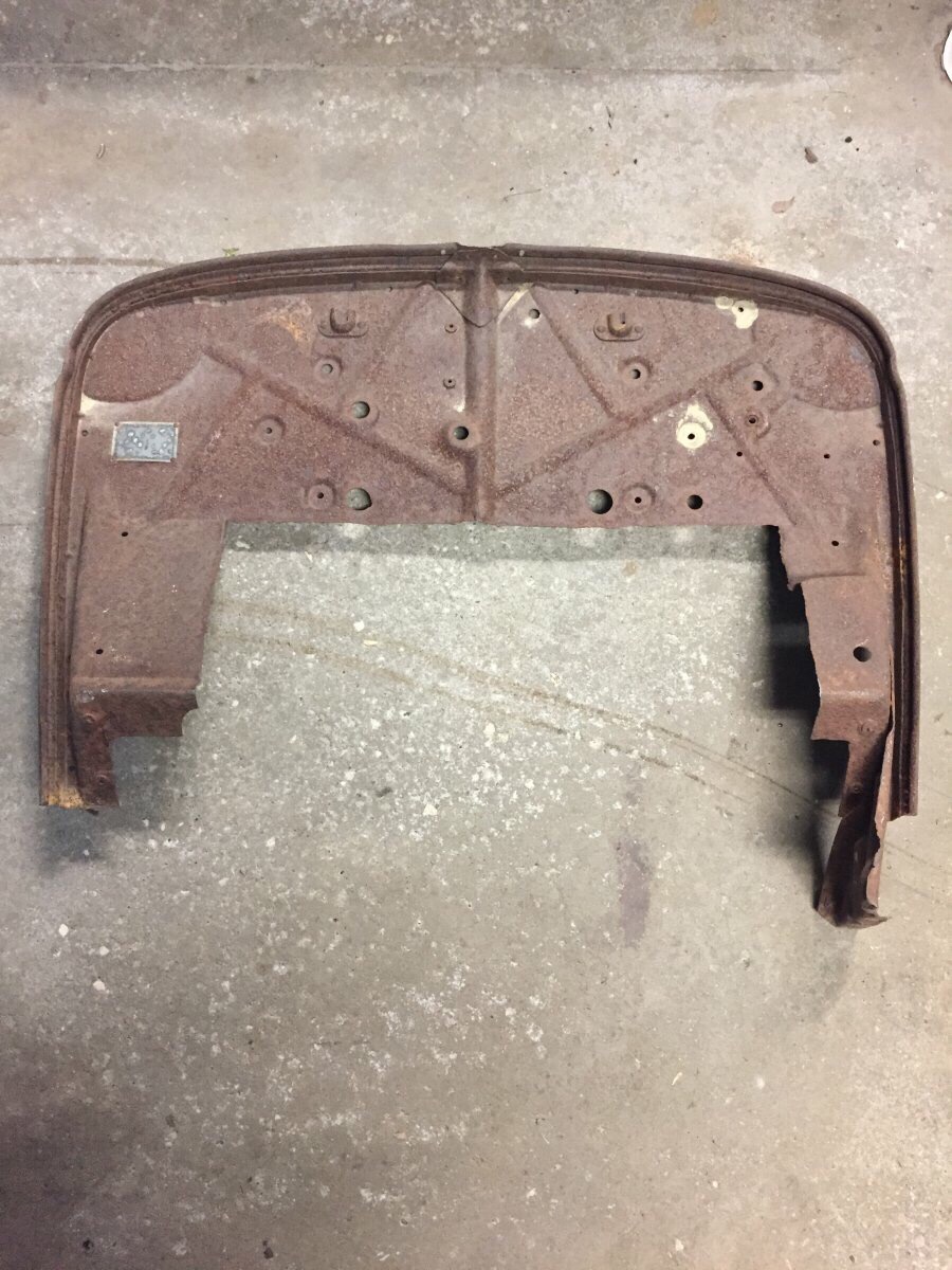

    But real excited to have a replacement for the firewall I stole to use on the Tudor. The cl***ifieds come through again. Thanks so much @Krash !
    Can’t wait to work this out. A trip through the mol***es bath tub and some weld repair in it will all workout for the best. The missing sections work great with my channel and engine combo.
