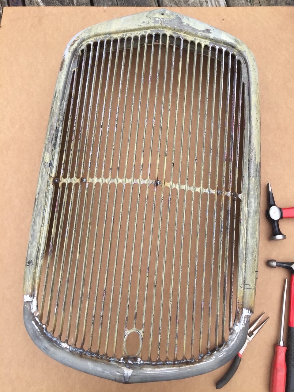

    Took some time to get the grill bars and crank hole straighter before I finish the very difficult bottom.
    Need to add tiny bits of metal in spots and welds on the back side. Then I can add the inside panel. And grind down the outside welds. The crank hole was really hard to get to this point. It is still crooked.

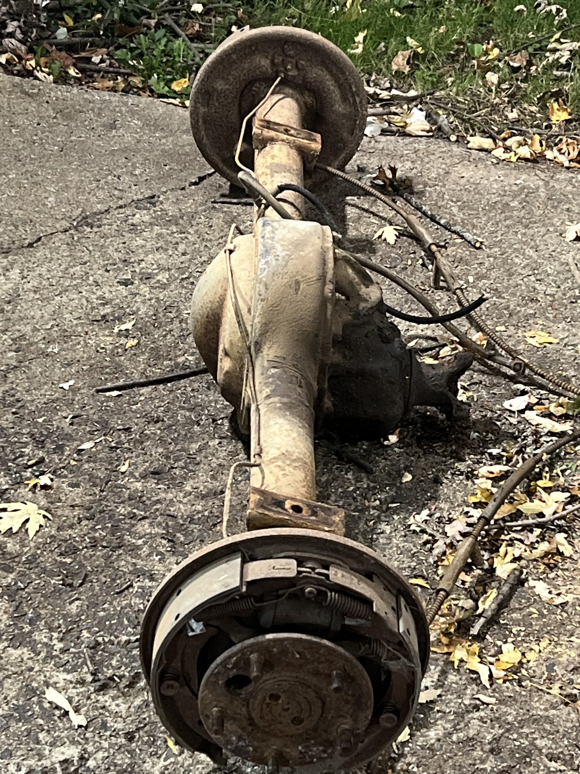

    I could take some of the old bed still cut in pieces from few years ago for ya ? That I no longer have desire to use. I got down to wanting to make my own from some of the portions. Mostly the tailgate, its hardware, and stake boxes. Then I picked it up one day and said no way! Way-no lite-o.
    Almost wrapped up a jig last week to drop the front axle I pillaged from Tu****ester. That’s Lakester and Tudor. Looks like Too ****ster though, eeeek. Does this pic count then?

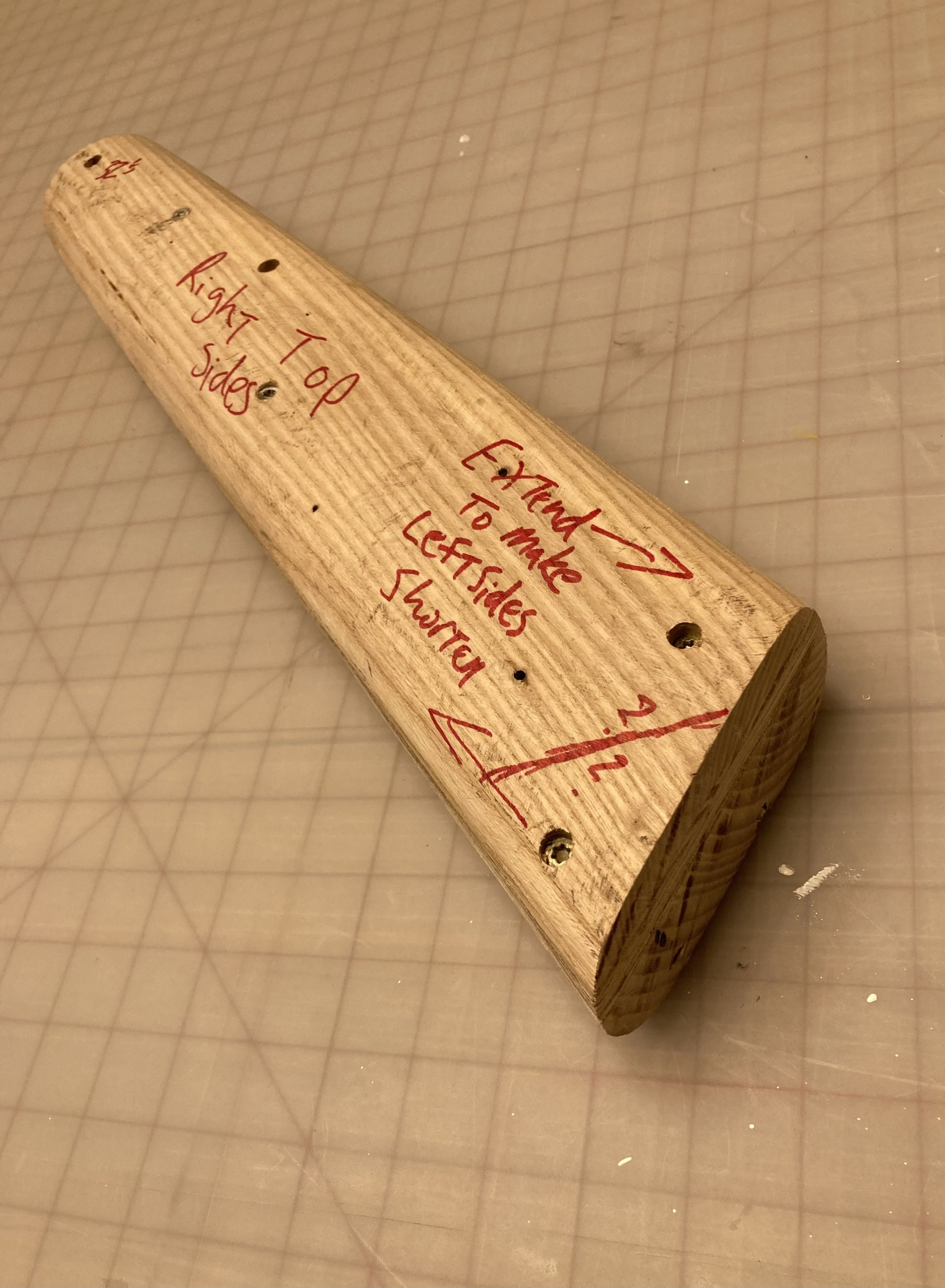

    IMG_4836.jpeg I have to jump in and defend myself here. Before somebody points out or wants to school a youngster about the wrong ways. That is not a stacked secret stash of s**** 2x4s. I only hastily thought one could brace the cab before mock cutting the upper deck. After all I was about to cut the entire thing apart anywho. I had no easy way to get d’welder in back yard or plugged in. First I thought I could bolt something in using existing holes. This had me remove all the original wood structure carriage bolts and square nuts. Which I safely salvaged and have de-rusted for reinstallation. Well one lock washer died but I’ll locate another Henry 92yr old round here. Then I said hey, lots of wood here about for other stuff I’m actually supposed to be working on. Let’s borrow it, I won’t tell on me. It seemed pretty darn traditional at the time. Now it’s just funny lookin back.
    So hilarious!
    I wonder if I can reuse it for cab re***embly

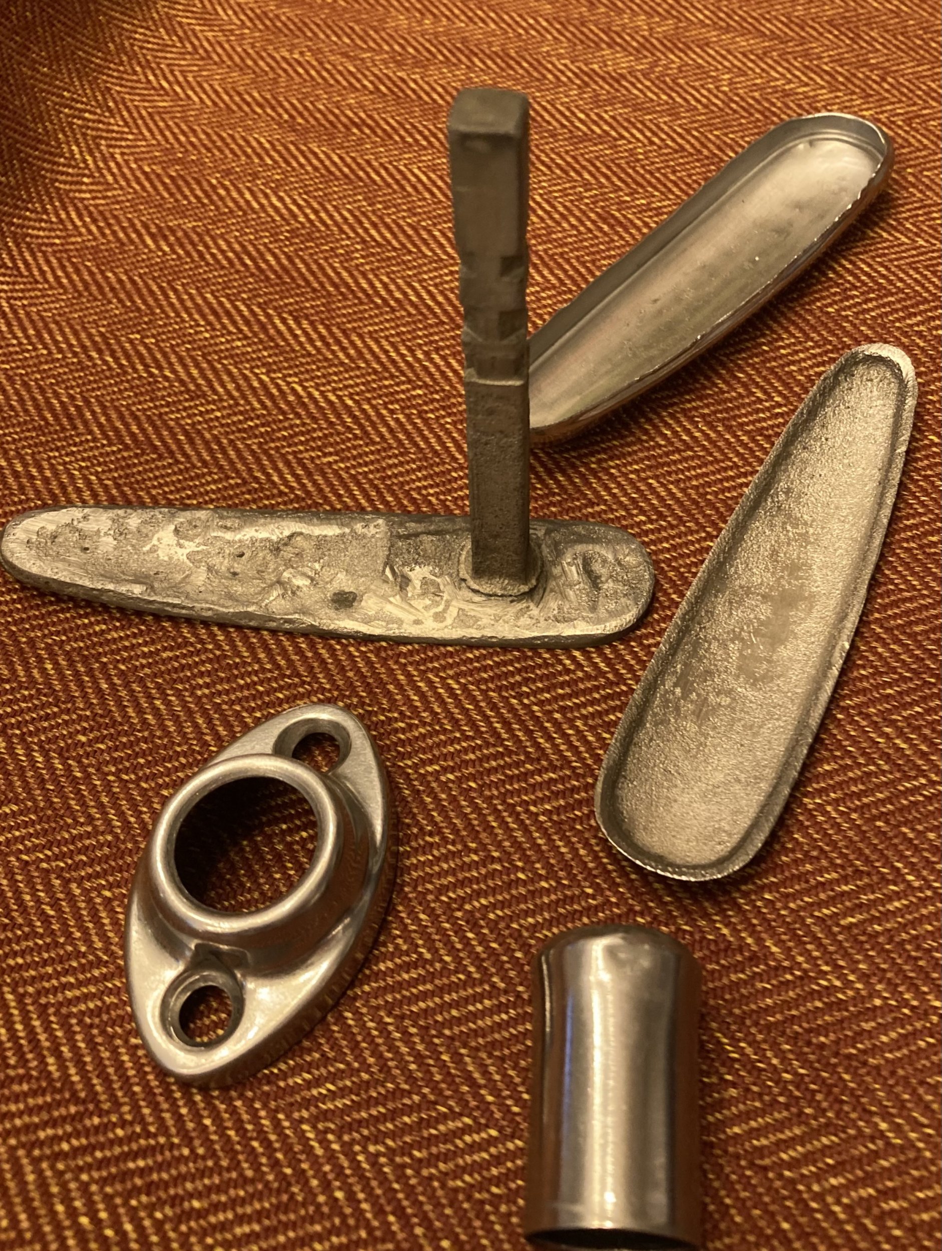

    Well this here is all the proof one would need to diagnose my poor time management and lack of awareness for it.
    This was from the outside a nice usable p***enger side door handle 15 yrs ago I suppose now. I forgot to remove it when I stuffed the cab in the back yard after beginning work on the Tudor. If you asked me I would have told you “augh, it’s been out bout four years”. Even though I’ve been walking past it for ten years now saying “dang I better get that off before the weather ruins it”. I even noticed the rust and maybe freeze had the lower edge of stainless separating for most likely 4 years, idiot. So now I am rebuilding it and protecting from elements hopefully longer than it withstood from before this point. I’ll coat all the raw steel in POR15 before putting the shiny back on. Also I’m straightening that out and polishing back to near perfect but not.
