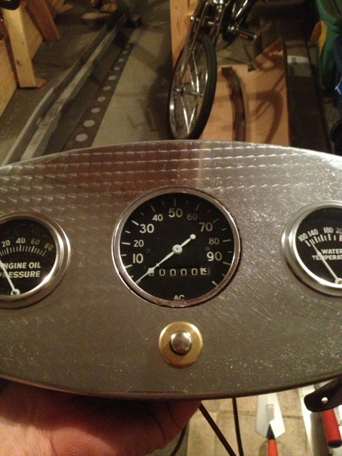

    So I never take the easy road it seems. Case in point my gauge cluster. I have been fighting this issue since about day one. I have stated that it is very important for me to feel like I'm back in the day with this pickup. One way I felt I could get there was with trying to keep the vibe or feel of a 30s automobile. I have a vision of when you climb in the cab a and take a seat that you feel it is the 30s and your waiting for someone walk in front of the radiator grill to hand crank it over. Only with the push of that little stainless ****on...BAMB!!! Now it ain't the thirties no more! It's undeniably HotRod Fifties and then some.
    So blah blah blah, I'll get to the point now. I want the interior perspective to to seem all's well and sort of original. So no modern gauges and such. Well of co**** the PU came without a tunnel or any electrics to speak of, time to source them out. Woe! who keeps makin all this 32 stuff so expensive? For a couple of years from time to time I keep losing my chance for a speedometer as their prices shoot to the moon, I mean the thing almost fits in a coffee cup. Time to start thinking like a hot rodder. I learn a little about Ford original speedos. One thing I notice is Delco being one of the manufacturers suppling Ford. I think one day if I searched eBay leaving out 32 and maybe used 30s speedometer, SW, Delco or something and came up with this 33 Chevrolet AC piece. It looks like this: ImageUploadedByH.A.M.B.1406603821.416391.jpg this pic is from after I cleaned it up on the inside and pulled out the number wheels and reloaded them to zero. But notice the needle? It's the same as the Fords. I had crossed my fingers it might slide into the ford dash tunnel, no such luck. I have noticed really bad 32 gauges for sale before for parts. I think I could try the AC guts in a 32s shell because the three ford used look practically identical on the outside. I pickup a 19$ 33-34 SW truck speedo that no one else bids on just like my new 39$ AC speedo but this thing is junk. I just want the shell it looks like this: ImageUploadedByH.A.M.B.1406604665.409739.jpg ImageUploadedByH.A.M.B.1406604684.944049.jpg
    I go and crack the 32 open as soon as it arrives to see if their gauge faces are the same size, they are, awesome. Next I need to find out if the Chevy mechanism sits at the same depth in the Ford can, ImageUploadedByH.A.M.B.1406604955.500916.jpg it does, check. Now the screw holes in the back clock in the same position but the AC is on a bigger cir***ference, so I'll need to drill new holes. ImageUploadedByH.A.M.B.1406605134.834959.jpg ImageUploadedByH.A.M.B.1406605160.450577.jpg ImageUploadedByH.A.M.B.1406605200.798737.jpg ImageUploadedByH.A.M.B.1406605227.020410.jpg
    Funny thing I noticed about there comparative conditions is the Chevy piece which is super clean, has a disintegrated gauge light window lens. The Ford's is almost perfect, win for me. Time to clean up the bezel and see if its useable. Here's a light fluff with steel wool: ImageUploadedByH.A.M.B.1406605560.913399.jpg why do people always shoot up old cars? I found some 12gauge buck shot pellets in the shell to match the dents in the face and bezell. I removed the dents a little bit now but they're not perfect that's cool with me it will match up with my panel good. ImageUploadedByH.A.M.B.1406605767.041877.jpg it looks like this and works out with the cheap oil and temp gauges I whipped up to go with it. ImageUploadedByH.A.M.B.1406605894.543258.jpg this whole setup has cost me about 200$ so far. And to my surprise under a ton of black paint I had a stainless trim ring in the dash that cleaned up nice, no charge.
    now I have two new dilemmas, do I cut down the ACs clean convex lens to fit or get a new flat piece made to keep more of the Ford look? The other two have flat gl***. And what direction and order does this ring go with the gl***? Does the gl*** set in it? ImageUploadedByH.A.M.B.1406606172.639956.jpg

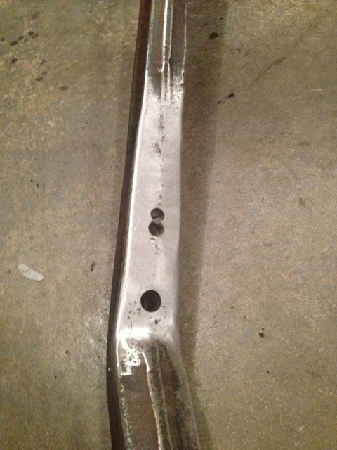

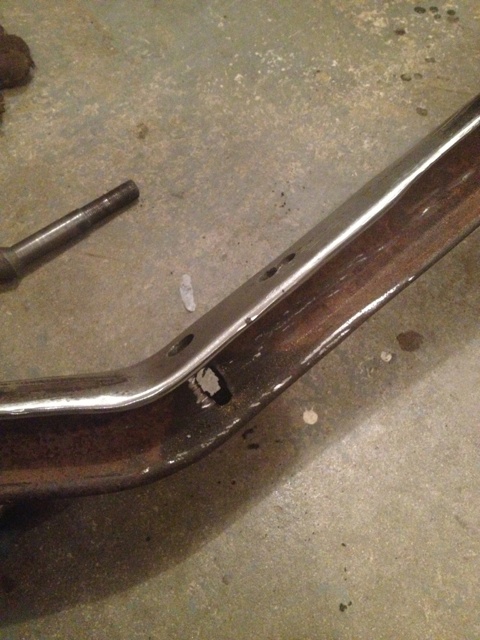

    In regards to my front axle work... I'm not happy with loosing the cast finish. In order to get a believable factory looking profile I have needed to do a lot of grinding to remove the leaf spring mounting surface. Once I weld in my filler perch boss pieces there will be more to come. I already started to peak it some but the cast line on top from ford is more of a like 3/8 ish bead. ImageUploadedByH.A.M.B.1406991114.418227.jpg I think I want to emulate this to the perch bores. I have to weld up two holes on each end already maybe then i should build up something to work with. So my final thought just struck me a moment ago was that maybe I could prime it with a rough texture paint roller to get a simulated cast finish? Has anyone tried this before? or any other ideas?

    After you get all your welding done take an air needle scaler to it to add texture back to it

    Thanks a lot that makes a lot of sense! Funny, I have one and I think I never would of thought of that. I hate when your brain freezes up like that, you know.

    You can get nice curved gl*** "lenses" in a lot of sizes from a lab supply company, try Edmund Scientific. I use them for clock faces. They are cheap too, I know you'll like that.
