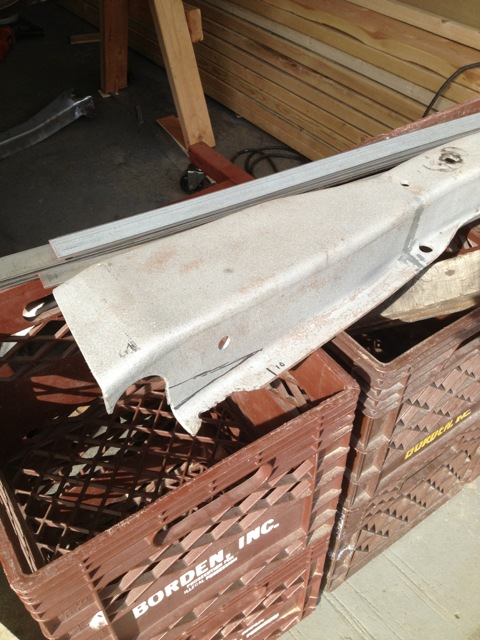

    I have no pics at the moment but I finally bit a small caliber bullet today. My aftermarket front crossmember has been bugging me since the day after I lazily purchased and welded it in. I'm sure all of you are familiar with the uninspiring looks of nonHenry stampings. After failing to get a Model A piece for awhile now I thought about getting a 32 and flattening it some like my rear. These are pricey so then I looked into 33-34s. This would have took extensive mods and still are pricey too. During consideration of the 32 and 33s I started to like the idea of the front motor mounts on the crossmember. I also wasn't so found of what looks like a strong potential of the old ones to crack. So now I've chosen to keep what I have and tweak it to my liking.
    First I plan to alter the frontside shape to mimic a model A. This will take some cutting and grinding to the bottom edge, no big deal. Second, I'm going to widen the ends(which are too narrow even with my pinched rails)to reach the inside of the frame channel and give it a simulated curve on the side edge and a bent lower tab for a rivet. I don't want boxed frame horns on this truck for they look to modified for what I'm after.
    On the back side I want to add pieces of s**** drilled boxing plate that I cut off of the tips of my front side rail fillers. I'll lay these on there side running inward to the frame center. They have two holes each and I would like to use the inboard hole fore the biscuit engine mount. Then form some 1/8 by 1" strip plate around the edges. I just can't decide wether to fill the gap between the two pieces and drop it down in the middle or leave it out for pulley clearance. Then weld'r back in and onto building my X-member which was on hold until I decided what to do about the front crossmember.

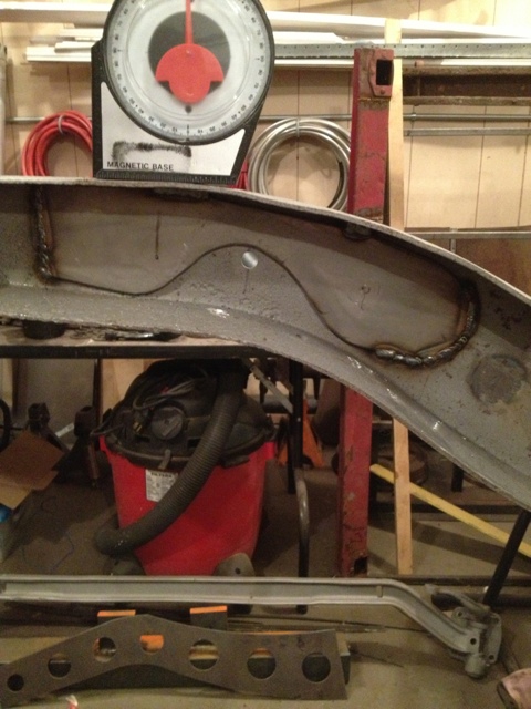

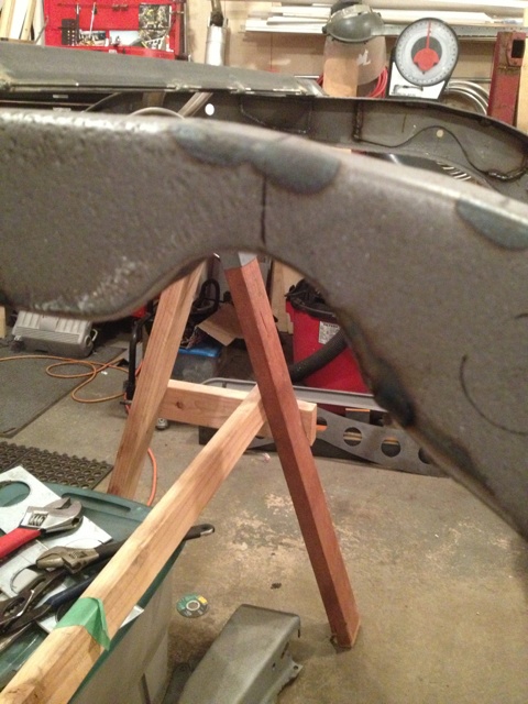

    I always say "life is in the details" which actually is probably inaccurate. But with a cool hot rod it sure is and I like details. I finished rough shaping my faux model A front cross member rivet ears. ImageUploadedByH.A.M.B.1409598940.415619.jpg ImageUploadedByH.A.M.B.1409598987.287496.jpg and I cut out and shaped the motor mounts I'm welding on rear of it.
    So now I just need to finish cleaning up the inner half of the frame channel spray on some weldable primer and put her back in. Then the front boxing plates which need fit and finish work in the steering box area. I lined it up with one of the holes but of course it needs to be opened up for the mounting flange to fit through.

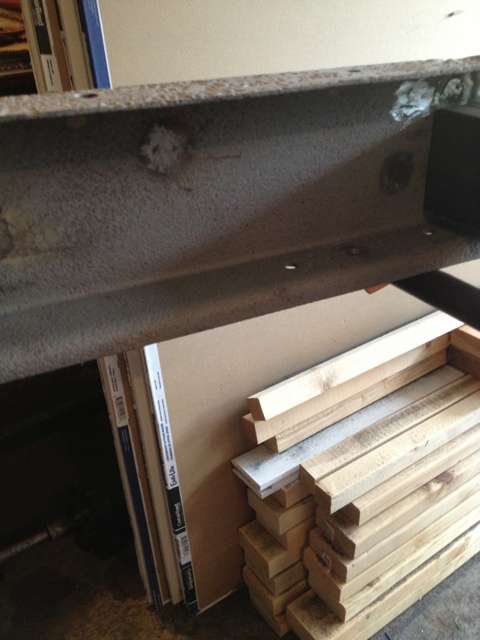

    Going to repair this nightmare of a crossmember ImageUploadedByH.A.M.B.1410007089.716365.jpg ImageUploadedByH.A.M.B.1410007113.083211.jpg and trying to decide to what extent I will add fake rivets to the frame and possibly drill stock style holes in front rails( i think this might look wrong since I'm boxing, so it's clearly been modified and will be body color, wouldn't someone have filled the holes too, don't ya think?). I cut out a plate for outside left rail steering box hole support. Have to drill the three holes and shape the three corners curves. I am trying to decide if it needs internal support as well.
    I have slowed myself down a little right now with the X member fab. There are a lot of variables to take into account all in my head of course. I am loosely basing it on a 33 -34 style. I don't want to box the middle rail section it is 5" instead of 6" like ford but has this reinforcement lip and is wider than ford so it might help ImageUploadedByH.A.M.B.1410009244.857947.jpg . I am thinking hard on how I want to make the pedal support, center connector, and right side extra channel all as one piece or at least in appearance and vision. I don't want to add a second cross brace back further to the rear but I don't know if I'll have to without boxing the mid rails. Gonna mount the trans with biscuits in frontside of X 1940 style. I am real excited about the way I'm going to join the drilled x member to the drilled boxing plate with some faux rivets and a half big hole over full little hole junction.

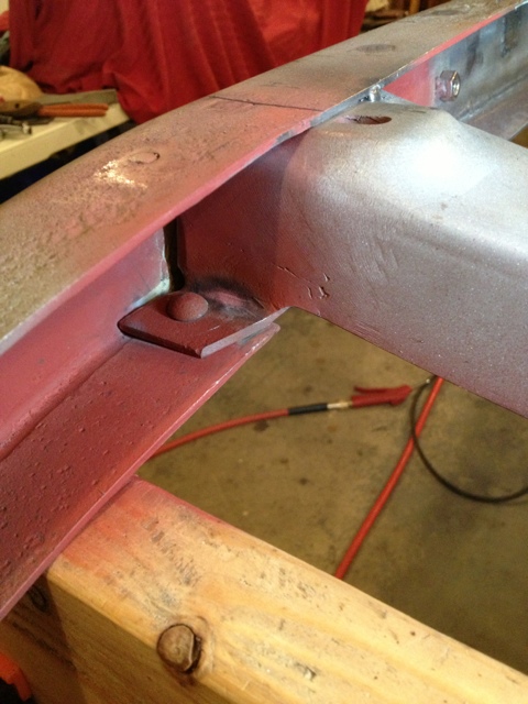

    Weldable primer, your my new best friend. It's just me and you out there in the garage trying to keep this 82 year old rusty frame(actually 84)from having a cancer relapse. ImageUploadedByH.A.M.B.1410493820.197978.jpg
    Crossmember is back in for the last time. Took forever to get squared up but it's right this time. I am very happy with the pseudo model A mounting tabs. Was worth the effort but I should of smoothed it more while it was out. I'll just slide a little body filler in there when I'm making the horns pretty. "Goodnight America".

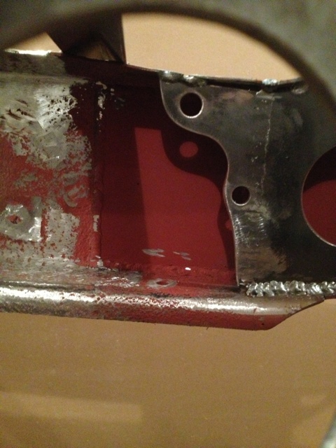

    Still think these look boring ImageUploadedByH.A.M.B.1410836913.474648.jpg but I just came up with a solution. I'll try and make the changes tomorrow and post new improved photo.

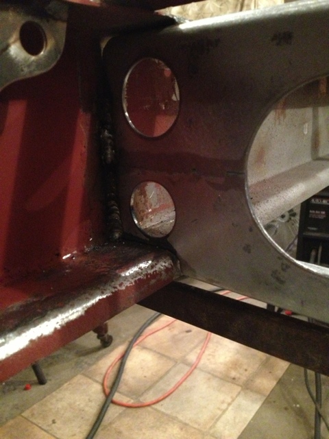

    Is this better guys? ImageUploadedByH.A.M.B.1410896387.106219.jpg I picked these gussets up at the speed shop for only $99.99! Yeah right! More leftover boxing plate cutoffs $0.00. I drilled the holes to save weight and surface tension with the atmosphere so my truck will go really fast! LOL .

    I'm voting for the Ford Tractor radiator, even when it's cut down, it is still a new piece, and not likely to bathe you in coolant too soon. :rolleyes:
  24. flatheadpete
    Joined: Oct 29, 2003
    Posts: 10,777
    flatheadpete
    from Burton, MI
    Crossmember and engine mounts look great!!!

    Final iteration: ImageUploadedByH.A.M.B.1410982746.020417.jpg followed with worlds ****piest weld.

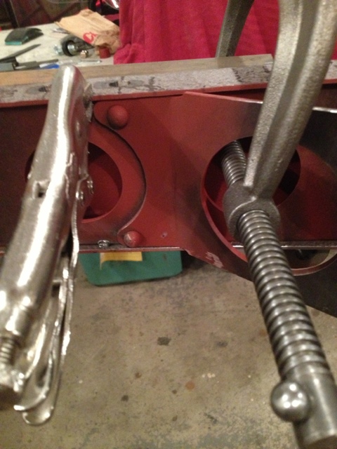

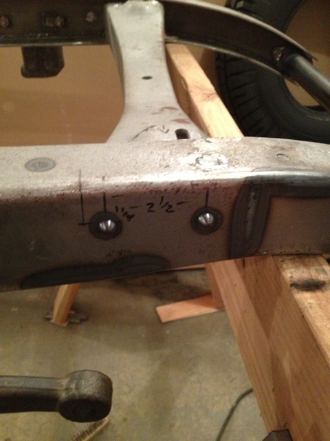

    ImageUploadedByH.A.M.B.1412052657.626322.jpg I had to secure these rivets before I could install the front plates and the top and bottom 1.5" plates to the vertical plates of the X's channel. ImageUploadedByH.A.M.B.1412052842.400214.jpg something like this. The 6" by 12" inner pieces that will be on the sides of the trans tail shaft I cut from leftover s**** ImageUploadedByH.A.M.B.1412052979.632636.jpg then trimmed down. The angled curved portions mate to the angled drilled boxing plate that runs back to the kick-up area. I have to cut out the top and bottom plates to and to these. I'm still undecided on how I will span the upper and lower gap between the trans pathway, still exploring my options. I will use biscuit mounts 40 style for the trans mount.
