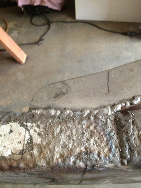

    CatFish, it's a non adjustable reg. straight Co2, maybe somewhere between 35 and 50 degrees depending where I'm at, I think the torch tip is off the metal in the range of 5/16 to 7/16 maybe, no fan currently.
    See what I mean by inside and ****py?
    This is a tack immediately after doing the top out side corner in the other pic, this happens all the time and its ******* me off to no end. The front boxing plates are like this every other weld or so, it's disgusting. I'm probably going to grind it down and go over it again when I get a handle on this. I wish I had some pics to show of roll cage and ch***is work I've done in the past to show that I use to be pretty good at this stuff(insert self-pat on the back here) but times change. Remember, your only as good as your last race. Wyatt.

    Get closer on those inside joints, it's ok if the cup touches the metal as long as the tip is 1/8 to 1/4 of an inch away, the excessive splatter usually comes from lack of shielding gas.
    You are doing better than lots of folks.

    You might want to try turning up the amount of gas pressure on your machine. I don't know what your running for pressure, but I use around 10-15 psi , and higher if there is any wind at all. I usually make sure the air has very little movement in my garage when I weld .

    My thought exactly, but Wyatt mentioned he had a preset regulator that does not allow for adjustments

    Yeah I thought it re***embled if you forget to turn the bottle on, which I've done once or twice before. I've also been in there tight with the cup touching but it usually gives me pattern troubles.

    After reading all the post up to now I suddenly had a question pop up in my feeble mind. Are you running DC positive or negative? Inside the cabinet just above the wire drive me mechanism you should be able to change polarity. I can't remember for sure which setting is recommended for mild steels (DC negative possibly) but I remember having similar issues when I first got my Hobart Handler. Hobart is Millers lower end product offering and most parts don't interchange but the settings are similar so reading on Millers blogs might help you.

    Chief, I don't remember but I had to switch it when I went to gas. It was much worse before I welded a little bit and remembered to flip the wires, I must be looking pretty stupid after all these confessions.

    I noticed that last pic you posted of your tacking inside the rail, you're getting a lot of "browning" adjacent to the puddle. Seems regulated gas pressure might be off. What about possible bad gas/contamination?, bad wire?. I know with most 110V welders, everything needs to be cranked up for decent penetration, wire feed speed and voltage. Just my 2 cents.

    jseery
    from Wichita KS
    Ok, lots of issues, CO2 vs 75/25 gas, no gas pressure regulator, welder on an extension cord and you wonder why you might be having a problem???

    It's a Factory Set regulator, non Adjustable. The extension cord is not puny and there's no way to easily weld at one end of the frame and than the other with a 5' or so whip and maybe 5' power cord in the middle of my garage. I was told the Co2 would work better for the high heat welds I would be doing. I don't know if I remember using a welder without some form of long power cord to get to the work area in big shops, can't usually set a frame on a bench.

    Thanks Prime. I've seen this blackening of the edges some with a corresponding poopy *** weld. It's like if you don't turn the bottle on. The gas is from Pra**air and is a couple months old in a shiny new aluminum bottle. Have know idea if its contaminated.
    Talked to my weld pro buddy and he's afraid I hurt the welder with maxing the duty cycle out all the time. The manual says it can run 85 amps for 2 minutes than needs 8 to cool down. Well I don't think I've welded a 2min bead but I have ran it for like a half to a full hour at full tilt inch or two welds sometimes with only short little cut the wire, clean the tip, or weld, and take a sip of beer, then weld again hundreds of times. Sometimes it gets a breather as I grind, cut, clamp stuff down into place, or the family interrupts me. The other deal is I made it shut off a couple of times bout a year or so ago and I don't think I was going for that long. Now it hasn't happened again and I'm surprised I haven't pushed it enough to make that happen again, seems fishy to me with doing a whole lot more intense welding.

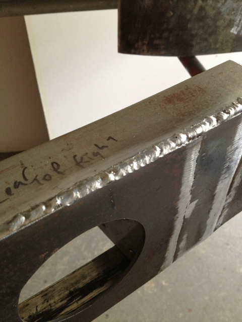

    So my welder is junk, literally, the wire feed motor died or as is at least dieing from a stroke. I was trying to get a handle on it using it on stuff I knew I would grind down, like my rear crossmember. You may have seen pics of it earlier in this thread. I bought it for $72,I believe, for I new I was going to flatten it. The low price was from the ends being torched out of its original frame. I first cleaned up the immediate damage a long time ago when I flattened it. But it had a long way to go before looking semi-factory ish for a clean install. One problem was that it sat deeper down into the frames side height than my Chrysler rear horns would allow, pie cut time..
    Then I put on some s**** corner tabs to give it feet to later weld in some more fake rivets.
    Then it needed the cut holes and notches filled.
    I used a handfull of s**** that matched it thickness( all cutoffs from the frame or crossmember itself)
    Plus I made some rear feet modeled after what I did on the front crossmember...
    On both sides of course.
    Part of the reason for the rear feet was to help establish a way of putting the member in there pitched in a fashion that would allow the spring to hang down close to parallel of the axle swing. I ground down the ugly but penetrating welds
    Later they'll get a little Bondo before primer. I'm starting to run low on old rivets but I'll hopefully make it to the end of the ch***is fab. Tried a test fit
    Gonna need some fine tuning but I won't put it in till I get a new bigger welder. Something in the 190-210A range that runs off of 220V. Until then I can pretend that it's coming together

    The .024" wire can't carry the current ( heat ) needed to weld ii ga. frame metal. I have an old Hobart with a high and low voltage tap and on the low tap with .o24 wire it's difficult to tack frame steel consistently. However, with .030 or .035 wire it's okay still on low tap. The heavier wire should start easier also. I have a 40 ft. extension cord for my welder and I use it frequently, but it is #8 3 conductor stranded and the OD is about 1" dia. I wouldn't discourage buying a new welder. My $.02.
